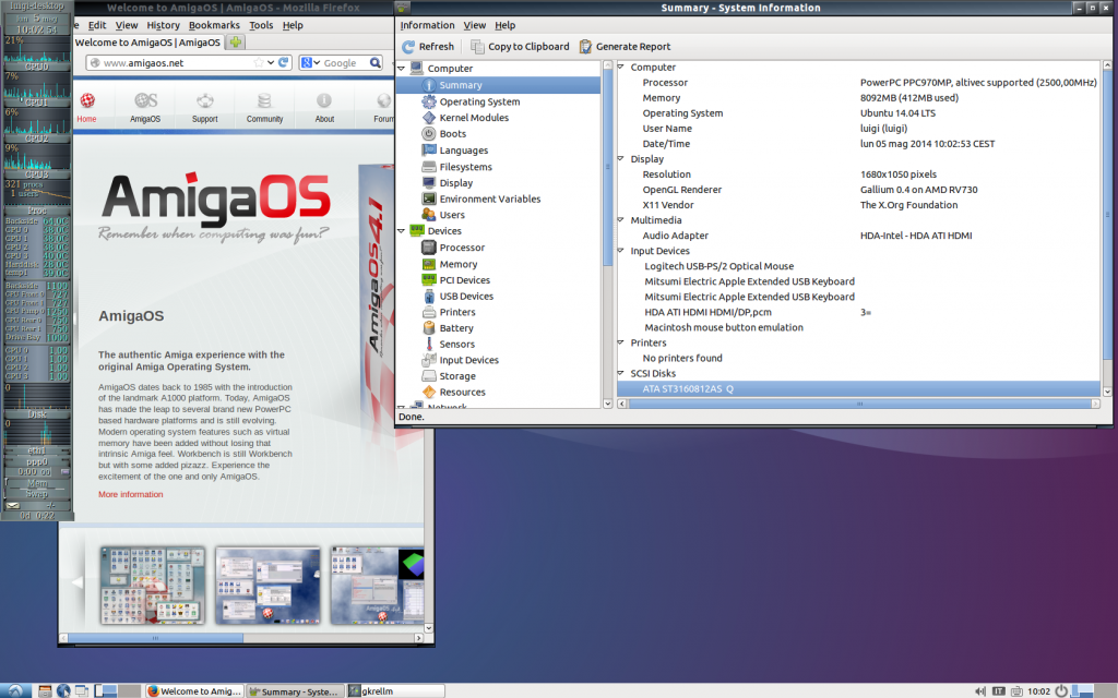

Yes i had ben tested.
I have only here X1900, nv6600 an nv7800 and one 4650hd
The 4650 work only in couple with X1900
The Tests:
Debian Wheezy 7.5 work great with nv7800gtx 512mb . i had full video acceleration and 3d but the system run there in 32bit and no audio.
Nv6600 work only in terminal no Xorg.
RadeonHD 44650 dont work at all like the X1900 too
Lubuntu
No Nv are working , and no X1900 alone
X1900 pcie slot 16x and RadeonHd 4650 pcie slot 8x
Everything is working audio thru hdmi too there are only wrong colors in 3d applications but one dev explain me this problem can be simple fixed in future..
the system run in full 64bit.
if i use the radeonHD in couple with an Nv card the Lubuntu not work at all.
Soon i will make another test on Debian wheezy with Nv 7800 in couple with a 2gb nvVideo Board.
The RadeonHd work only in couple with X1900 but probably will work in couple with all G5 pcie supported ati (macos side) video boards.
I dont know if on olds mac will be possible put a Agb video Boards in couple with a Pcie Video board on a Pcie->Pci adaptor ... but i think it is possibile .

On linux there isnt Vram problems because the Ati drivers are make by Ati , there are online some Patches for 6xxx card for fix the colors in the glx/mesa 3d .
Virtually the drivers arent a problems because linux ppc is using the X86 firmware on the VideoBoards (uboot system) if the board works on a Pc will work on the PowerPc side too.

I confirm the last wheezy is working on the Nv 6600 and this board is more optimized compared with 7800gtx 🙂 3x faster 😛
Will see in couple of an 2Gb video board if this distro will work too
I test the Last yabause the sega saturn emulator and it is 4x times more faster compared with the MacOSx version ... 🙂
