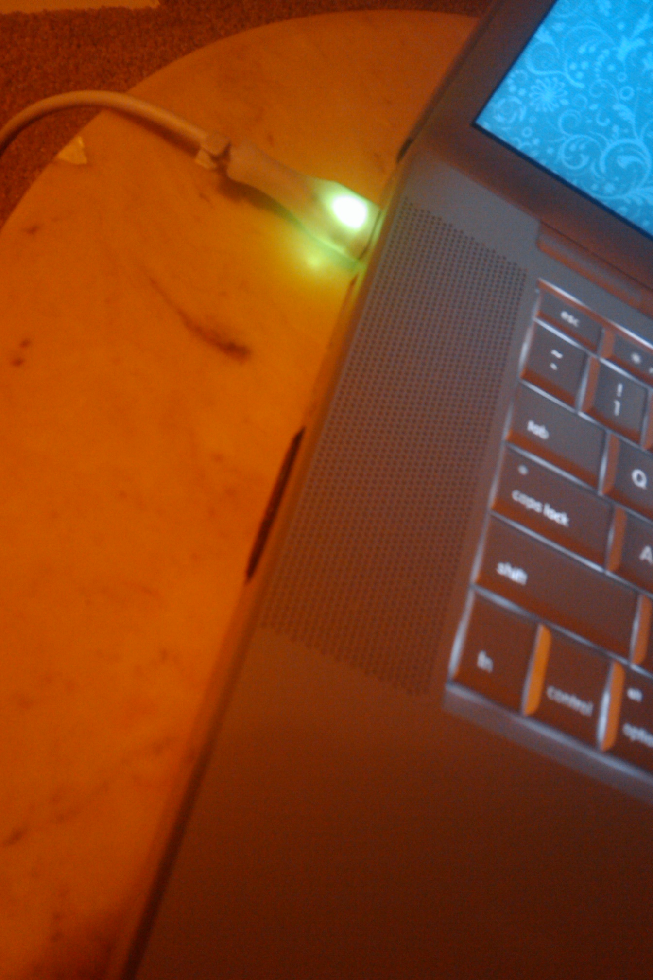

How far does the card stick out of the MBP? Any possibility you could post a photo?

i've had my filemate ssd for a couple of weeks now.
i just love it. much faster.
but, it does get warm
pic attached of how much it sticks out. sorry for crappy cell phone pic.
edit. i can't wait to install snow leopard on this thing!!
