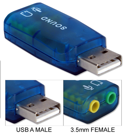

USB audio adapter
Get a USB audio adapter. It basically adds another set of headphone and mic jacks to your computer. Use this for your audio out to TV.
Something like this:
http://www.buy.com/prod/qvs-usbaudio3-usb-to-2-1-stereo-audio-adapter/226049977.html

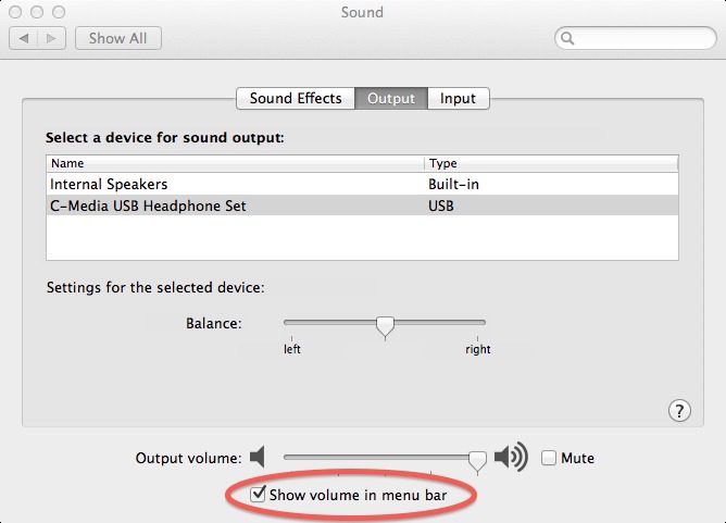

This will free up your headphone jack and you will end up with something like this in your Sound preferences:
Make sure check the box on the bottom circled in red.
Now option/click (alt/click) on the speaker in the menu bar will allow you toggle your audio choice.
Not the most elegant solution but, No more unplugging...
