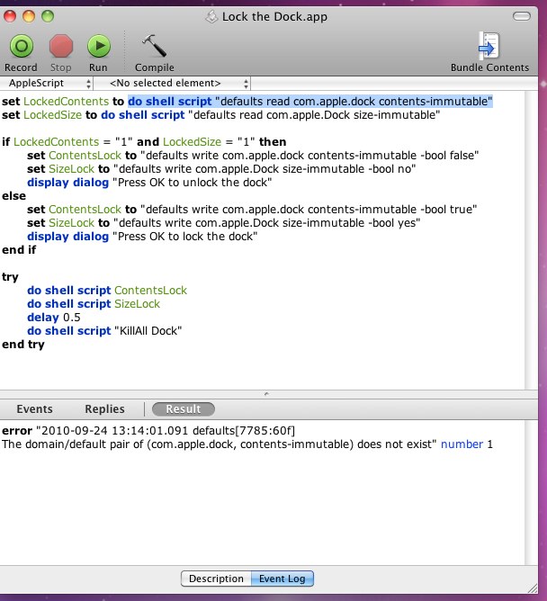

Hi - I'm new to Applescripts, so forgive me if this is something obvious. I copy/pasted your script into the AppleScript Editor, but when I ran it I got an error on the first line:
error "2010-09-23 23:52:26.489 defaults[6758:60f]
The domain/default pair of (com.apple.dock, contents-immutable) does not exist" number 1
Any ideas of what I did wrong?
Thanks,
Ron
What version of OS X are you running? I've only tested this script on 10.6.
10.6.4. I just wish I knew more about AppleScript to be able to interpret the error message.
I'm still learning applescript. Try this out :
