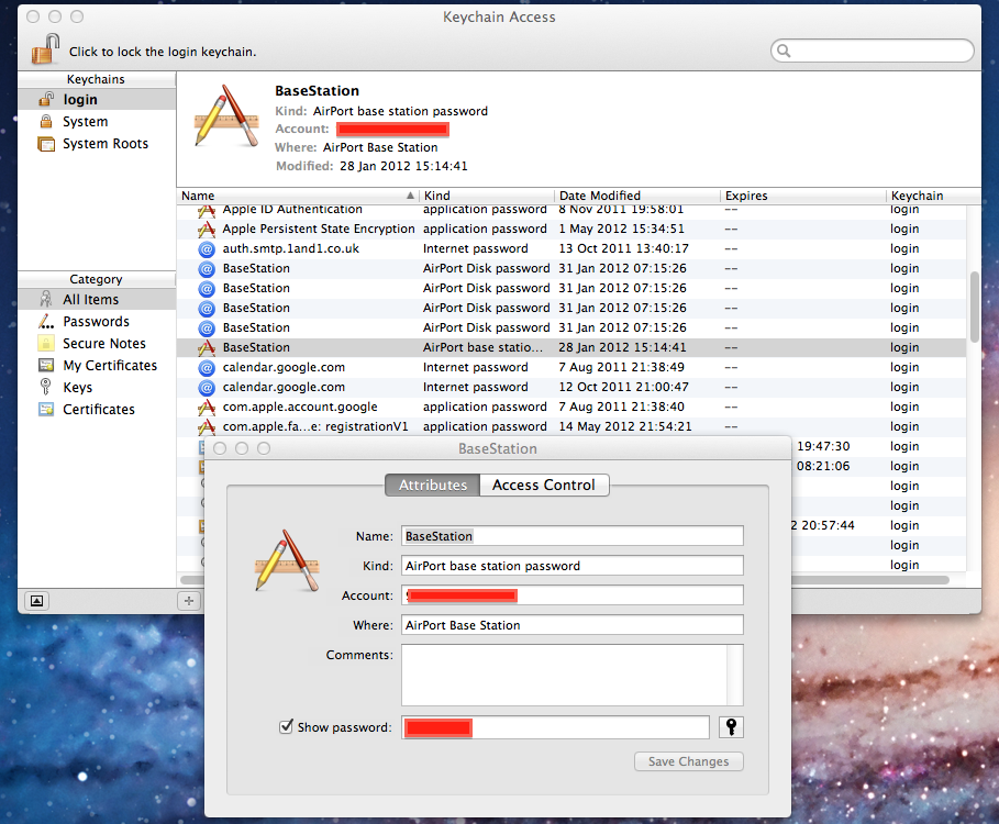

You can find the Keychain application in /Applications/Utilities/Keychain Access.
Open it up and find your Router, double click it and tick the show password box, then you should be able to enter the password there.
