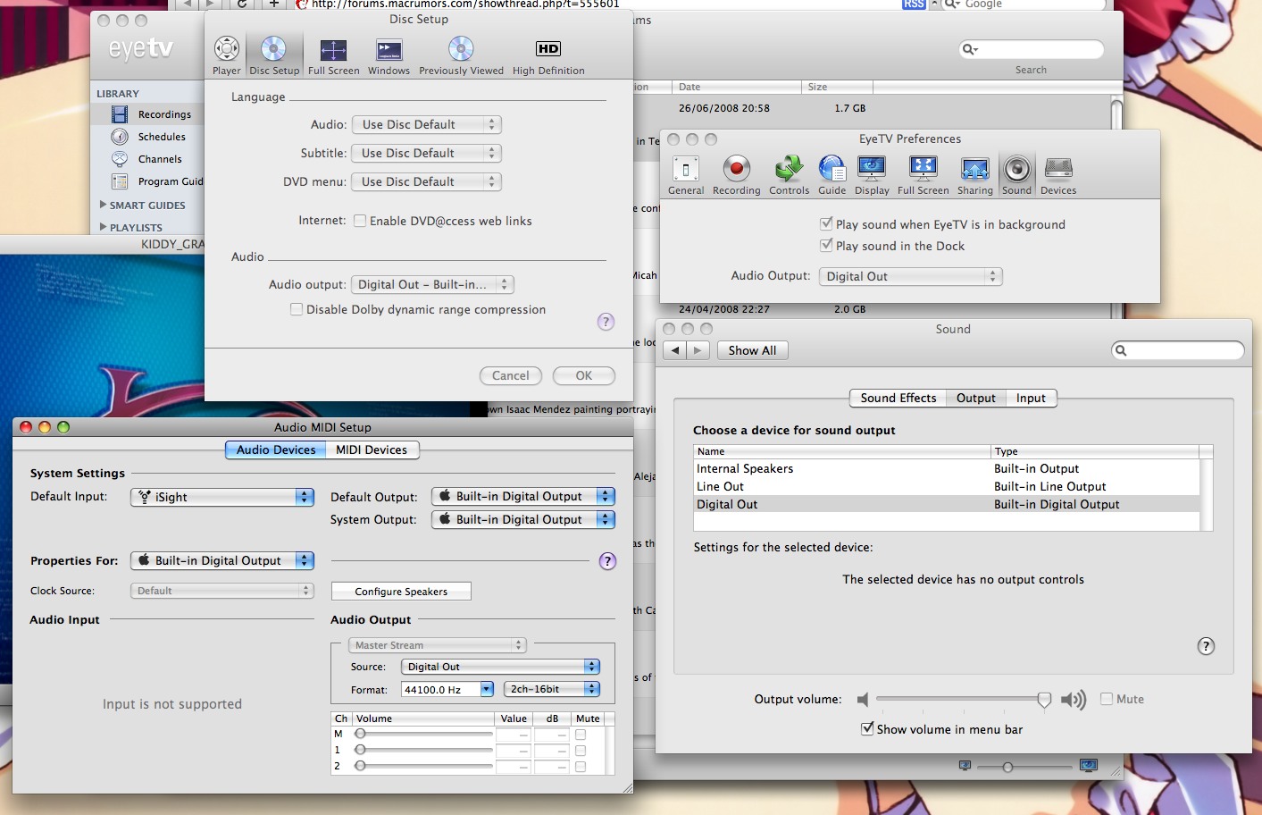

In Tiger I had to make sure in Audio MIDI Setup the Format was set to 44100.0Hz and 2ch-16bit otherwise it played some audio through the internal speaker.
I don't know if it will help but I've attached a screenshot of the setting I use.
