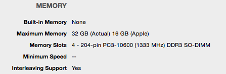

Your model is good with 32 GB of RAM and there is nothing to worry about.
MacTracker shows its capable of 32 GB, while Apple, often understates what their computers are capable of.
Reactions: kiwipeso1
Most likely, the Sandy Bridge and later chipset supports 32 GB of RAM.
Apple frequently lists the max RAM capacities as lower than they really are, as I believe they only list what they had on sale as the 'max'.

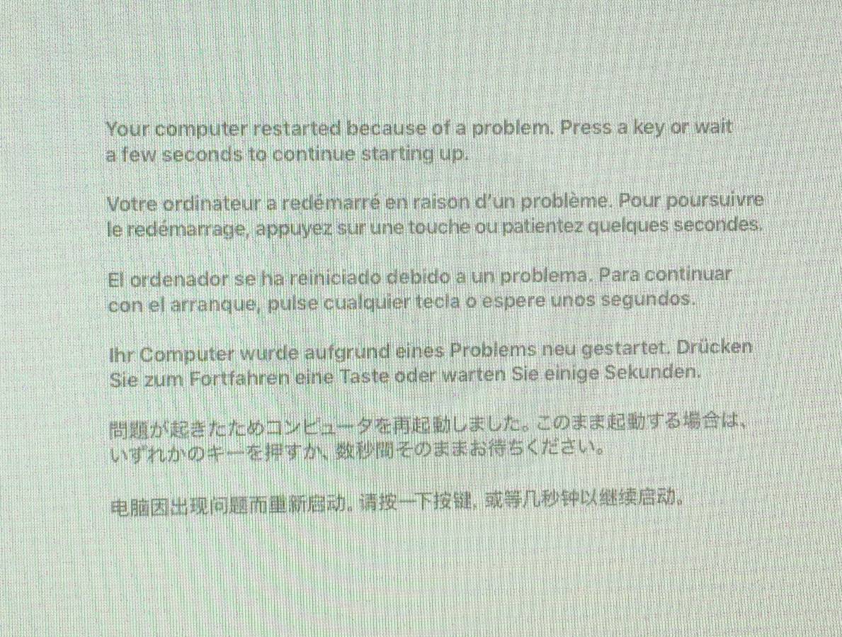

Hello all!
I've upgraded my 27 iMac mid2010 from 8g to 32gb, mainly because I work with some huge files in photoshop from time to time.
The thing is, also from time to time, I get multiple crashes... and then it reboots to this:
I can insert here one or the reports that the system presents me after the reboot. It really is annoying once it can crash and reboot every 2 min... for one day, or 2 or 5... And then, it keeps running perfectly for months.
Any ideas?

Hello all!
Any ideas?
Try running Apple Hardware Test to see if your RAM passes. I was having crashes & kernel panics on my 5K iMac like you described, and it turned out the RAM failed the test. Returned/replaced the defective RAM and it now works just fine.
