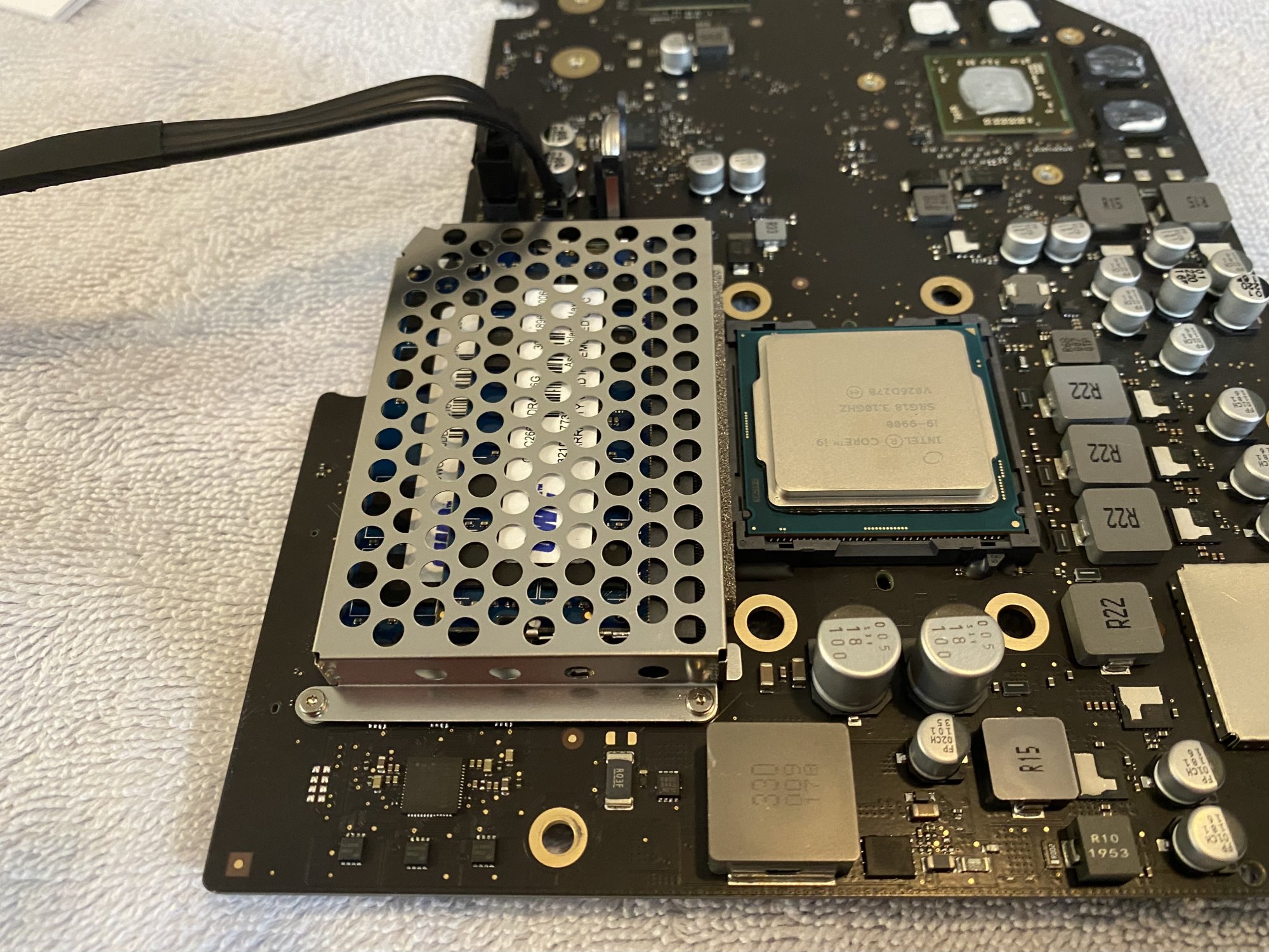

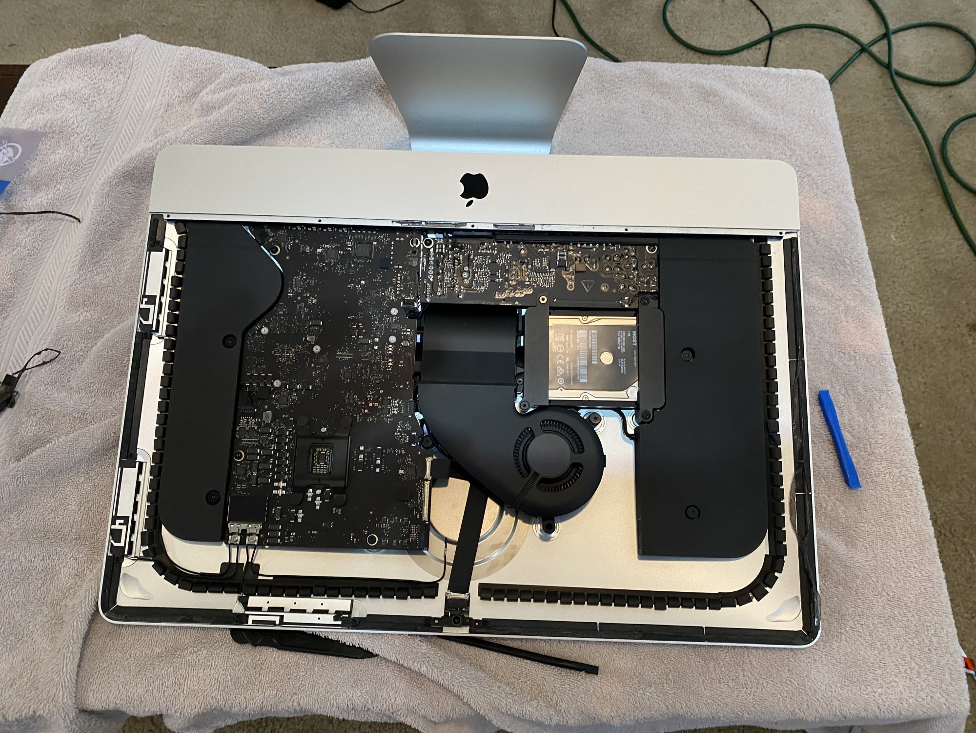

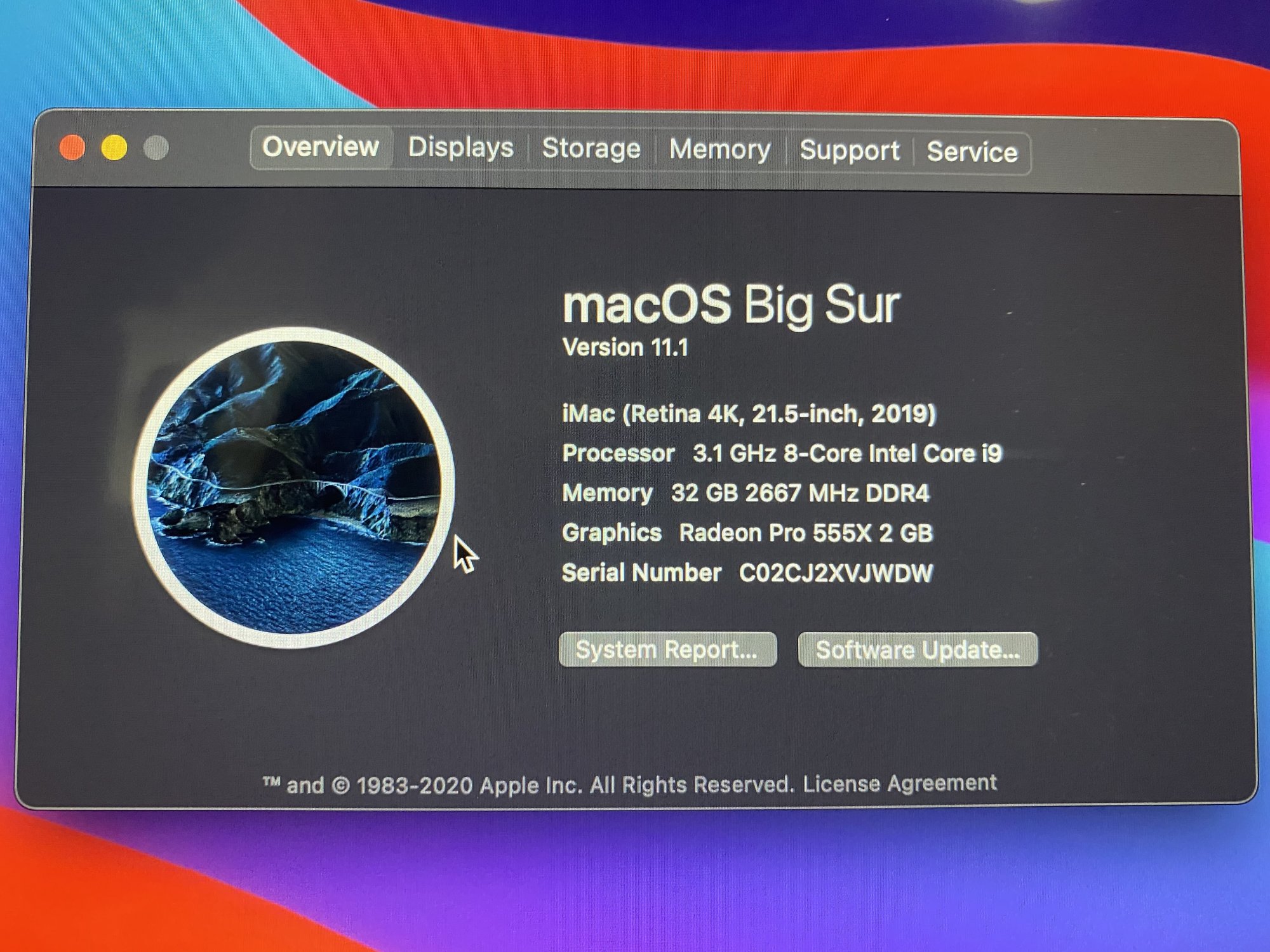

I found one post from UK that gave promise. For the fun of it I replaced the 8100 i3 with a 9900 i9. The TDP’s are the same (65w). Same microcode, socket and coffee lake family. The 9900 has integrated graphics as well.
Works great!

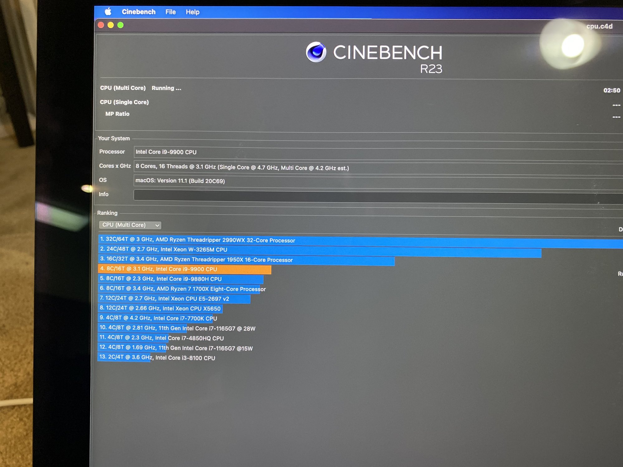

Cinebench went from 2900 to 9600.
Put through the ringers with Tomb Raider, Diablo III, at max everything. Temp goes to 95c but fan cools easily and cycles normally- does not stay on suggesting inadequate cooling.
Used > 5 hours straight and not any issue. Sure, wasn’t designed with that intent but as a hobbyist I wanted to try.
Used Arctic MX-4 generously on the CPU, GPU. Yes, violates all warranties, but I wanted to try.
Some report things not working but maybe something mis-aligned? The CPU heat sink is tough to replace, I think on purpose.
Nice project. As very few reports that I found anywhere, but certainly a 9900 seems to be similar enough and even the stock 8700 option reaches 95 degrees as well, I read.
Ive not had the iMac turn off due to heat. The design of i9 will throttle if heat high. The fan doesn’t remain on during continuous gaming suggesting enough cooling is occurring.

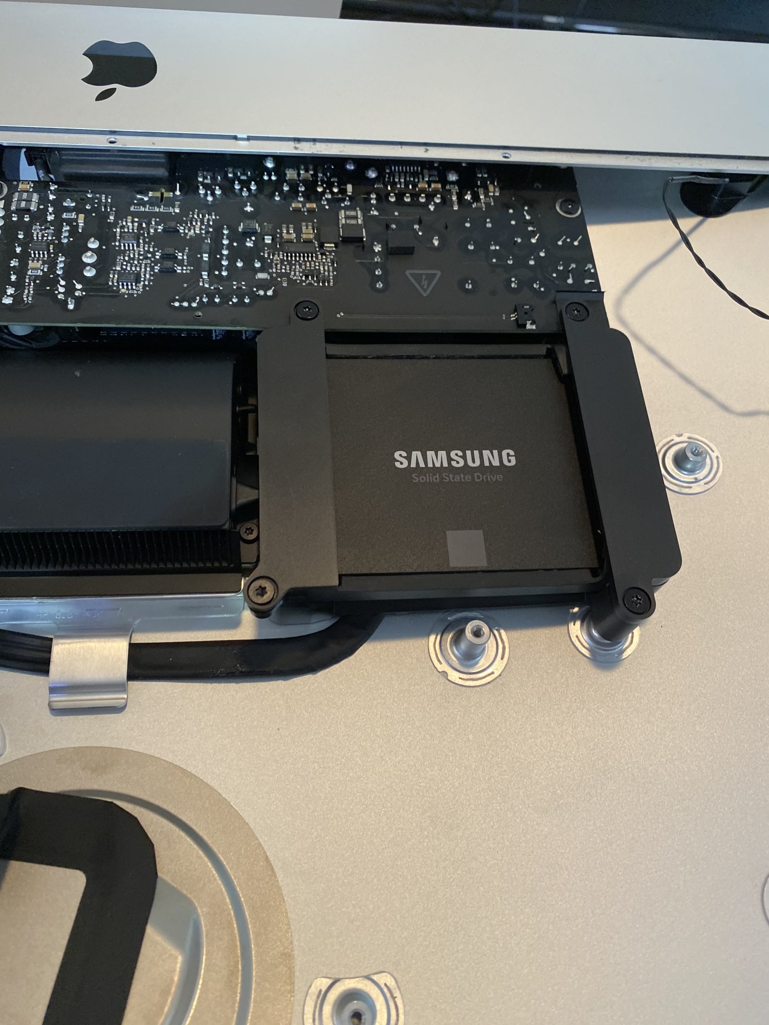

i had also increased ram to 32 GB and placed a Samsung evo 1tb SSD.
cheers!

Update to my post 18 months later- the i9 9900 (no k) works flawlessly and no hesitation at all using the iMac. Love it. Never overheats

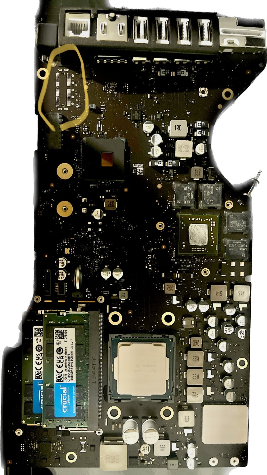

I don’t think it has a pci-e slot. Here’s photos disassembled:
