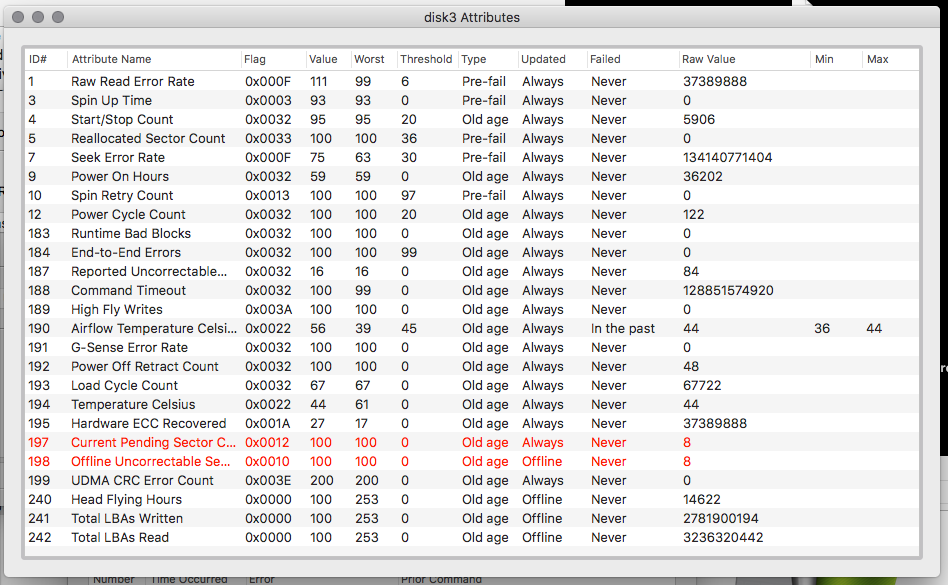

So here's where I'm at:
I was unable to get a reading with SMART Utility, not sure if I did a bad job installing the SAT driver or something.

OK, update, I was able to get a SMART reading but I'm not so sure what to do from here. DatarescueDD is a bust for me, I get an immediate error trying to read the drive then nothing. DDrescue though was working OK until the drive decided to initialize or mount or something (came back to my computer with error message about "the disk you inserted is not readable" and was no longer able to see the partitions on it, DDrescue started seemingly doing nothing at this point.
Subsequent DDrescue attempts haven't worked. The log from the attempt that was working looks like this

I attached my SMART status but I'm not really sure how to read it.
Thanks so much for the help everyone. I'm gonna run ddrescue once more and actually go away for a bit.
Edits within edits, that SMART status is for the drive I was trying to restore TO which is Not Good presumably. gonna get another before I try this again.
