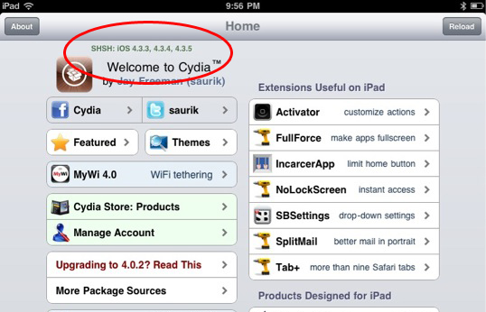

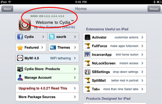

If it has blobs for 4.3.3, terrific. But again, open Cydia on the device in his presence and verify them yourself--they'll be listed right at the top of the page. Don't take his word for it, or a screenshot as it's easy to dupe that sort of thing from another device. That price is only $50 off of current retail straight from Apple. If jailbreaking is important to you, and it doesn't have blobs, I'd call that a bad deal. But then again, I wouldn't consider a non jailbroken iPhone or iPad ever again. Stock simply doesn't compare to a fully customized experience.
Personal opinion obviously--and one my own husband disagrees with! LOL Both his devices are stock and probably always will be. But things like SBSettings, iFile, and FolderEnhancer improve the iOS experience by huge magnitudes for me.
Edit: The area circled in red is what you're looking for when you first open Cydia. If 4.3.3 doesn't appear in that area, Cydia doesn't have a jailbreakable blob for that device. That's a screenshot off my current iPad 1; my previous iPad 1 had blobs going all the way back to the beginning as it was originally JB'd with the first jailbreakme last summer.
