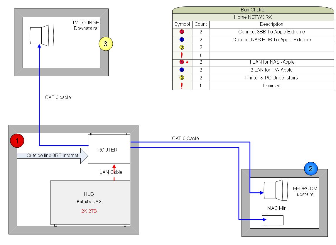

I would recommend putting your HD onto the network, then use various app's for streaming.
I have a NAS connected to the router, and then I can access it without the need for PC or MAC to be constantly on.
You don't need to convert the files to a certain format, some app's can play multiple formats. i have 2 Samsung TV which can access the NAS as well using the DNLA set up.
Basic set up below

Basic set up below
Thanks ianrip - trying to get my head around your great diagram. What is the count column for? You have a Mac Mini - where is your AirPort Extreme shown - is it your router? And is your Cat 6 Cable a regular Lan Cable?

Thanks ianrip - trying to get my head around your great diagram. What is the count column for? ( count column was just for Ref nothing important really) You have a Mac Mini - where is your AirPort Extreme shown - is it your router (YES but I didn't get the apple router just using the one supplied for now )? And is your Cat 6 Cable a regular Lan Cable YES ?

What is the count column for? (just ignore the column)
You have a Mac Mini - where is your AirPort Extreme shown - is it your router? (yes I've got a standard router, planning on airport if the standard router did'nt work but it did, so no need to change for now)
And is your Cat 6 Cable a regular Lan Cable? (yes LAN cable 1gb)
I 've got 6 lines in the house, all connected to the router, and the NAS is connected as well.
