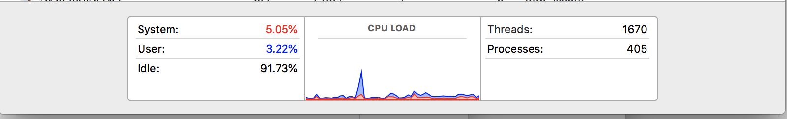

If you run Activity Monitor and look at the CPU tab, what does the chart at the bottom look like?
Mine shows my processor is 91.73% idle. So no fans needed.
Mine shows: System 9.42%, User: 3.22%, Idle: 48.85%. Treads: 1716, Processes: 438
I noticed that FirefoxCP Web Content takes 103.9% CPU followed by WindowServer at 28.7% CPU.
Anything unusual?
