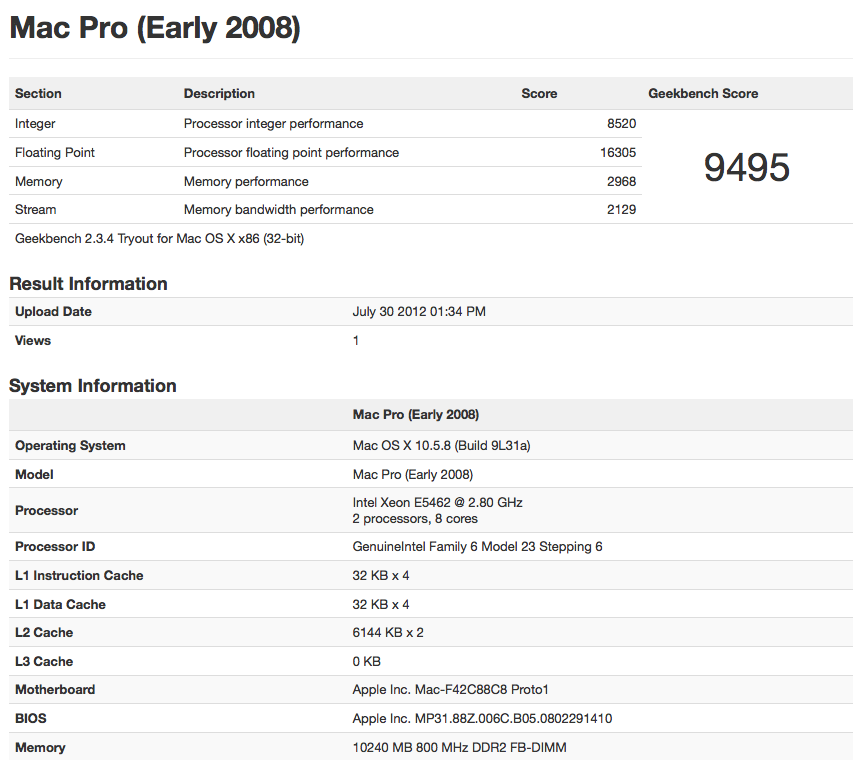

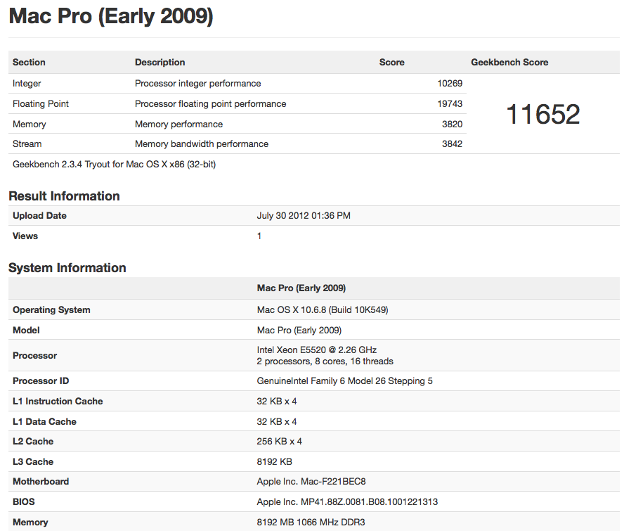

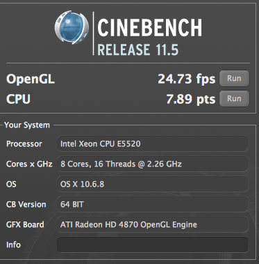

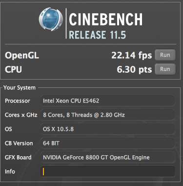

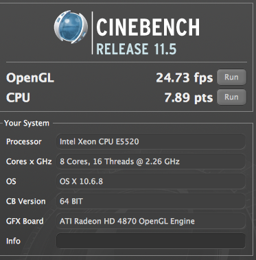

Well I did some benches at it confirms the assessment, that the new computer is better.
