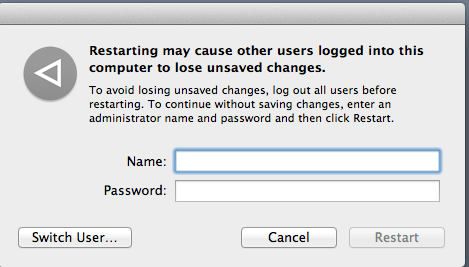

Yes, I restarted Mac, at least once, this morning before downloading macOS Sierra. Strange thing is now, after downloading macOS Sierra, if I try to restart it I get this, for the first time that I can ever recall, although I did switch to users, to download it:
You're getting that because you didn't log out of your other account but instead just switched users. The text in the dialog box explains exactly what is going on.
