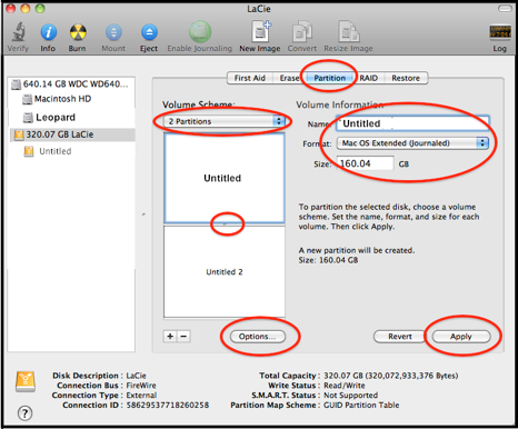

Perhaps you should reformat the drive on Mac OS X (10.4 or higher) with Disk Utility to make sure the the Drive partition map scheme is not GUID (Intel-Mac) or MBR (Windows) but the old Apple format (Apple Partition Map).
You can see at the bottom the current Partition Map Scheme. Press 'Options' here to change the PMS:
These are your options (AAPL is what you want):
Yes, I have reformatted two USB external drives and one flash drive with Disk Utility (11.5.2) using Mac OS X 10.6.8 from my iMac 27" and used the APM scheme. Still no luck in the G3 recognising them except in  System Profiler. But they just will not mount onto the desktop
