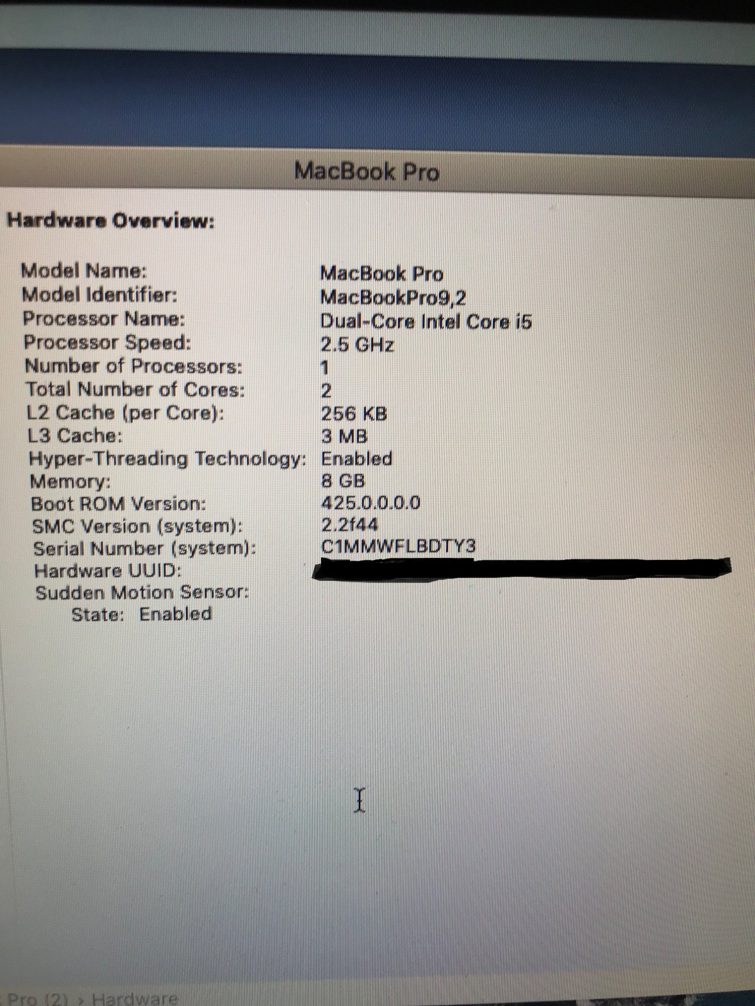

Anyone know if I would be able to upgrade my mid-2012 Macbook Pro to run Big Sur and maybe even Monterey?
This is a "unibody" MBP, is that assumption correct?
If so, you CAN upgrade it.

You can upgrade the 2012 to Catalina directly. The last OS officially supported by the 2012 MBP. There are workarounds I have read about in posts, called patchers, created by dosdude1 that will allow them to run Monterey, Big Sure, etc. I have not used them.
I have two 2012 MBP 13's. Great computers. I have stopped at Mojave, which I find a very stable OS. I also still use some 32 bit programs. Catalina and newer OS's no longer support 32 bit programs.

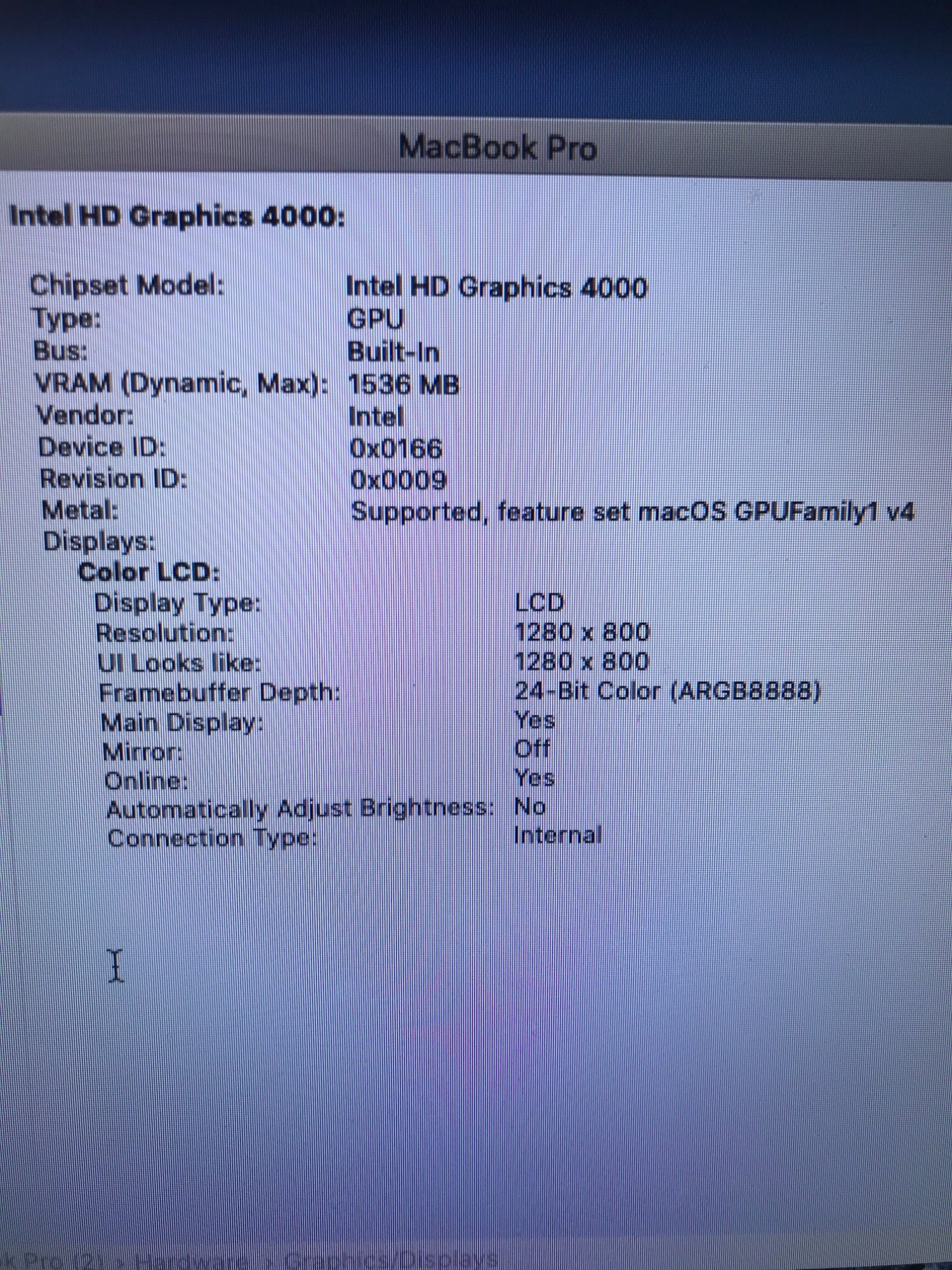

I used the dosdude1 Catalina patcher on a mid-2009 MBP for a couple years and it was great. But I'd prefer not to run a patcher on this one. I've heard that with certain GPU upgrades I might be able to run Big Sur and Monterey directly. Just hoping someone out there knows if it's possible and how to do it.
