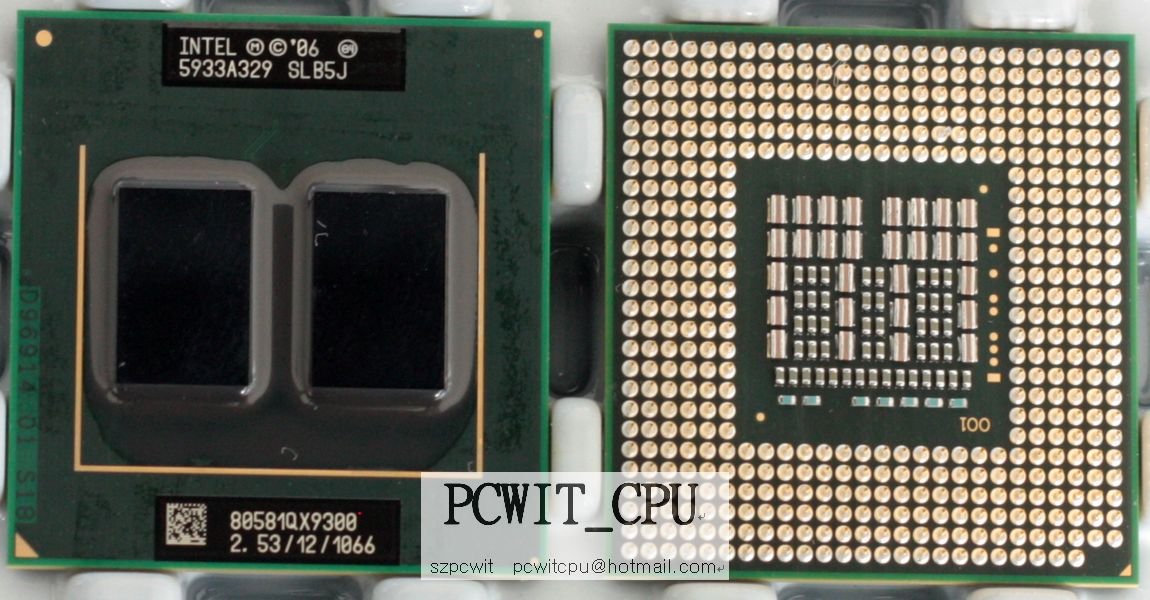

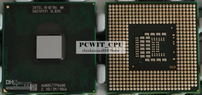

Hi i have the MacBookPro5,1 Late 2008 MB470LL/A(2,4) and i wanna upgrade DIY the Processor from :
Intel Core 2 Duo Processor P8600 2.40 GHz 1066 MHz bus speed 478 pin for CPU Socket P & B, to Intel Core 2 Quad Extreme Mobile QX9300 CPU 2.53GHz 1066 MHz bus speed 478 pin for CPU Socket P!
Can i do that?

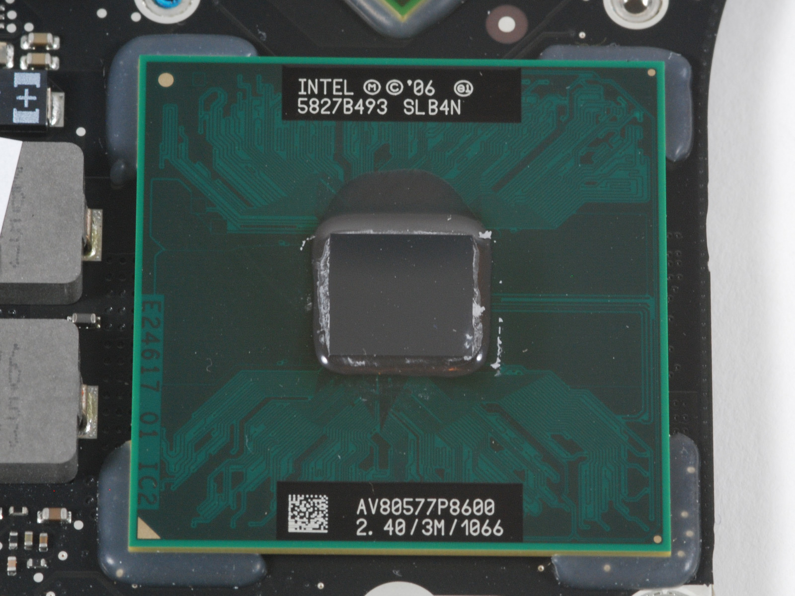

The CPU is soldered onto the logic board so you can't upgrade it without some special hardware (which means you have to do that for living).

Yes, I am sure about that.
tqareYqvbAHVjdWj.huge
As you can see, there is no lever or any other way to easily remove the CPU.
Apple does not offer CPU upgrades so they would just tell you to get a new MBP, which is what I would recommend as well.
Yes, it is soldered directly to the board. You would need to unsoldered, remove and resolder. It can be done, but not for the faint of heart and only the specialized people. When the logic board is replaced it comes preconfigured with a new processor soldered on already.

It's literally impossible to do it by hand. It cannot be upgraded by any reasonable means, and I am doubting that that CPU you listed would work with that computer anyhow.
