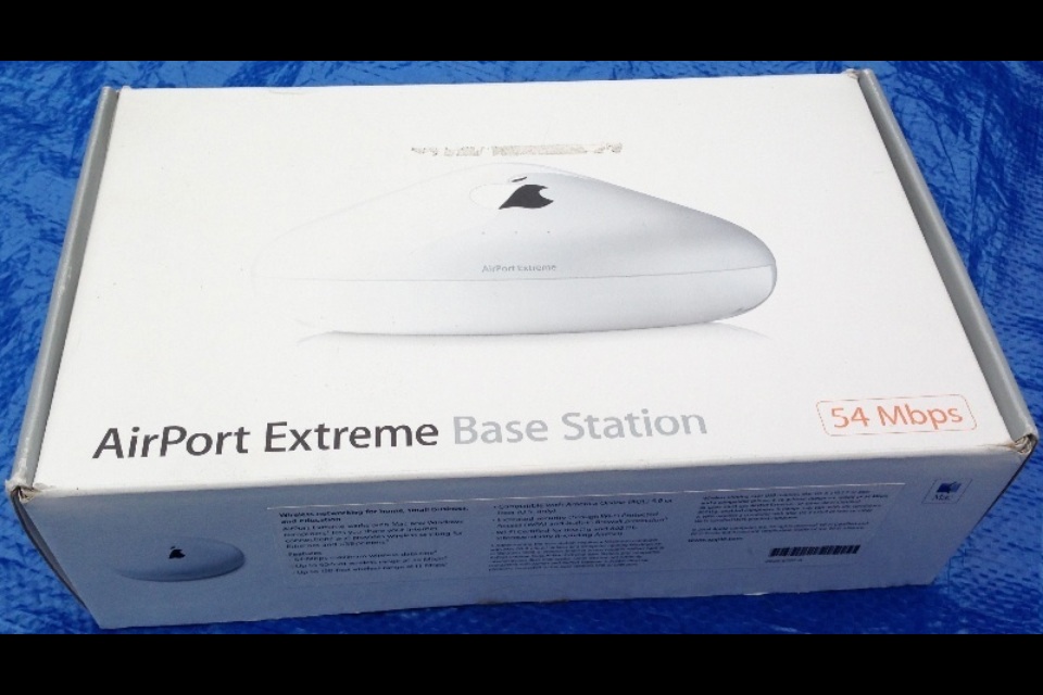

Sorry I'm actually colourblind, but I think this one is white?
It's this one pictured. I know it's not ideal but would it work as an extender at all? It's just I can get one for €10.
Thanks :)

Thanks for clarifying... Sorry for putting so much emphasis on the color :( The important part is the "Extreme."
Yes, you could use this, but like I said, you are going to be slowing down your network by adding this, plus you lose the 5ghz ability, if you use 5ghz.
If you only do simple web browsing over your network, you will be fine. However, I would use caution if you transfer big files over your network.

If I just set it to "join" my current network Turning it into a wifi to Ethernet converter to speak, would the speed of my network remain untouched?

You are not able to do that with the Airport Extreme. From my understanding, that is only possible with the Express.

My current AirPort Extreme has that capability but only with Apple routers.

You are referring to "Client Mode." From my understanding, you can only put those routers on Client Mode to connect a printer. All of the documentation (and forum posts) state that the Ethernet ports are disabled.
