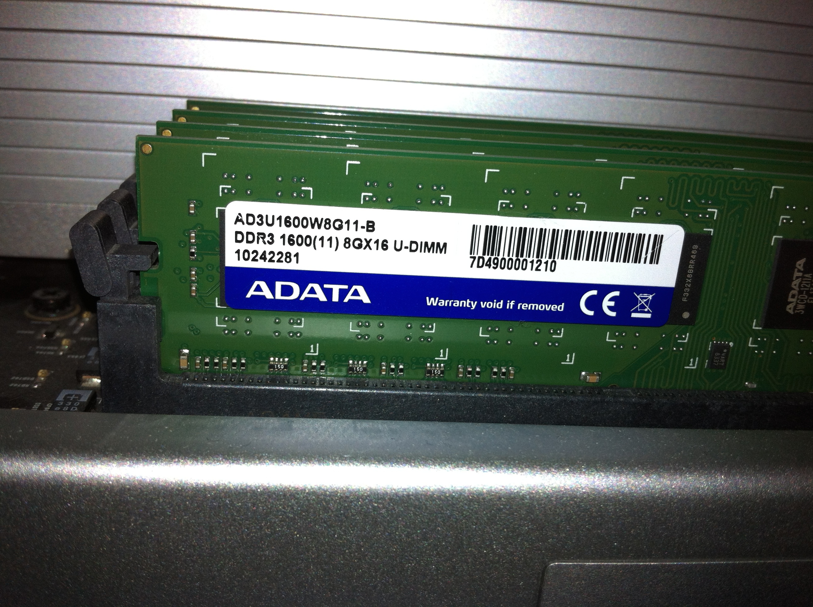

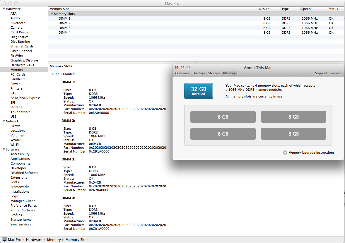

No worries, this is what I am now using in my Mac Pro 2009.
4x8G Non-ECC UDIMM
The RAM now running at 1066MHz because I use all 4 slots. Otherwise, it will run at 1333MHz (tested).
