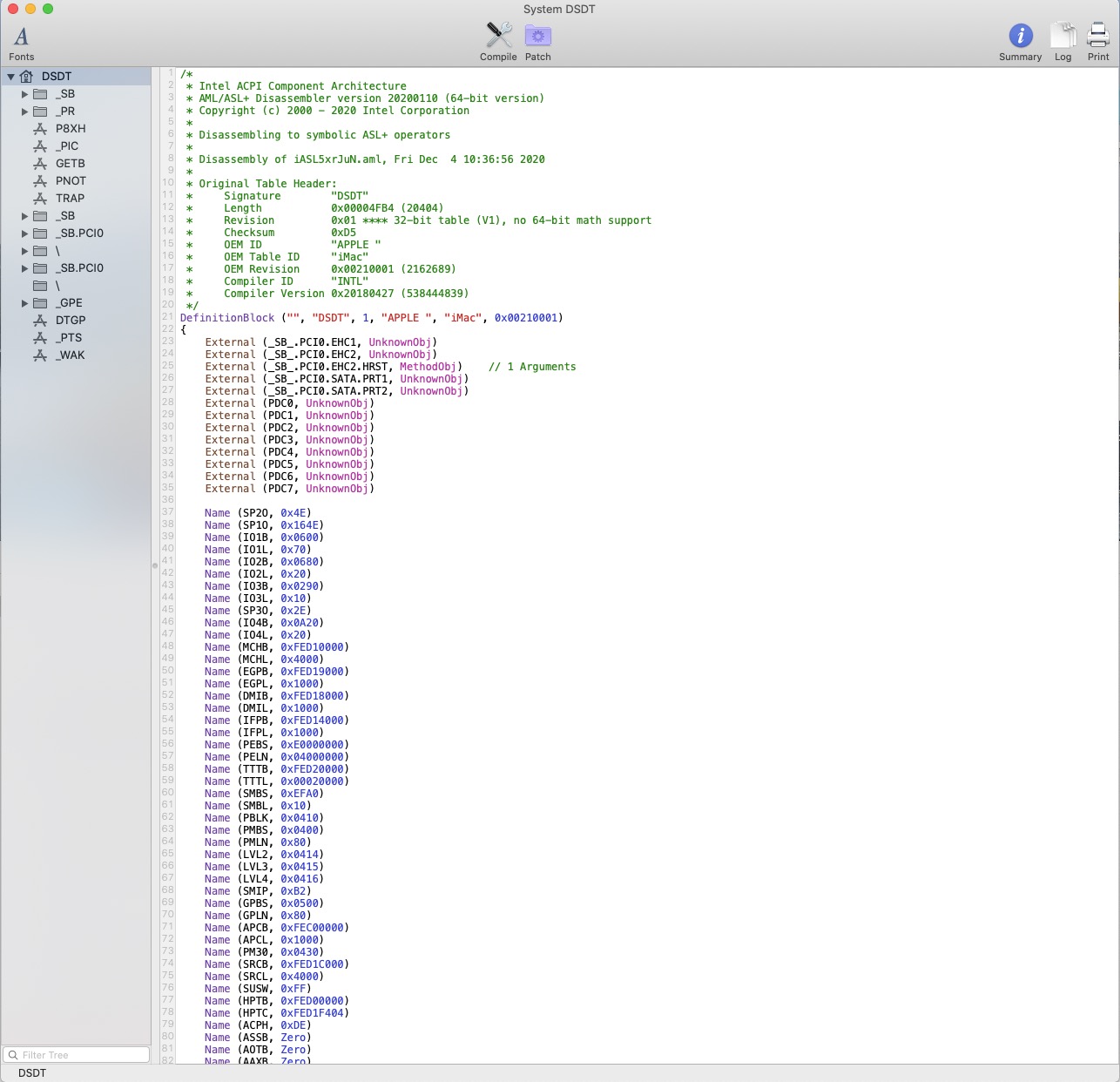

How to patch DSDT to make sound work in Windows10 UEFI

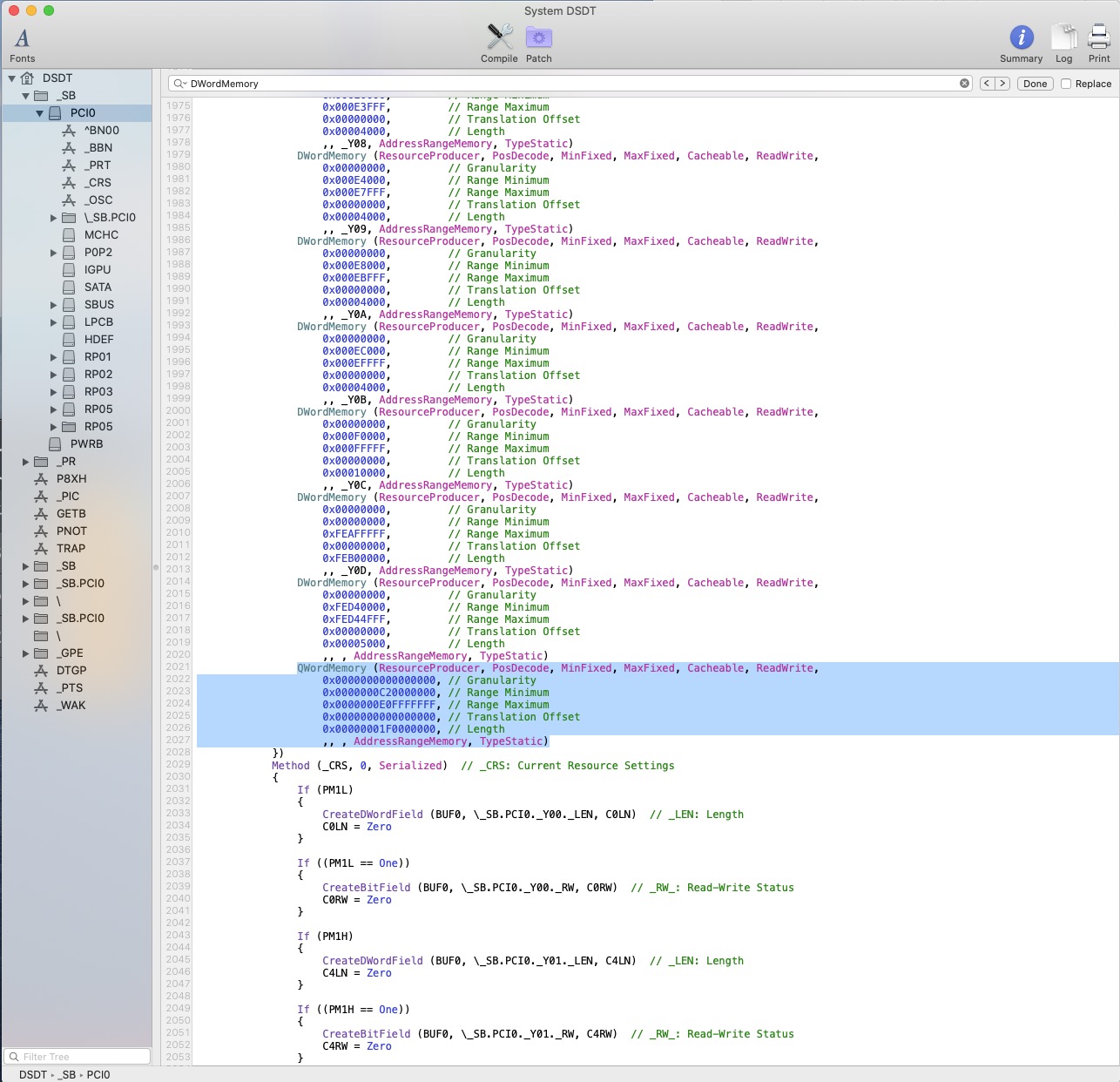

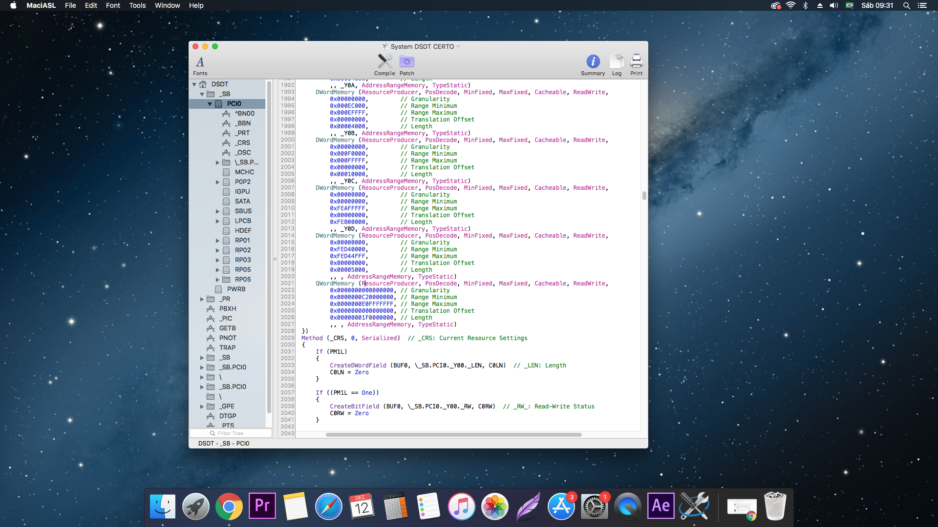

To make sound work in Bootcamp Windows UEFI, you could need to patch DSDT. We have to remove Window's 32-bit PCIe allocation constraint and allow the use of a 64-bit PCIe address space.
You need Maciasl to extract your own DSDT.
Search for DWordMemory. After the last DWordMemory we will inject a QWordMemory.
Code:
QWordMemory (ResourceProducer, PosDecode, MinFixed, MaxFixed, Cacheable, ReadWrite,
    0x0000000000000000, // Granularity
    0x0000000C20000000, // Range Minimum
    0x0000000E0FFFFFFF, // Range Maximum
    0x0000000000000000, // Translation Offset
    0x00000001F0000000, // Length
    ,, , AddressRangeMemory, TypeStatic)
Compile your modified DSDT and save it as ACPI Language Machine Binary (.aml).
Then you can inject this modified DSDT via OpenCore.

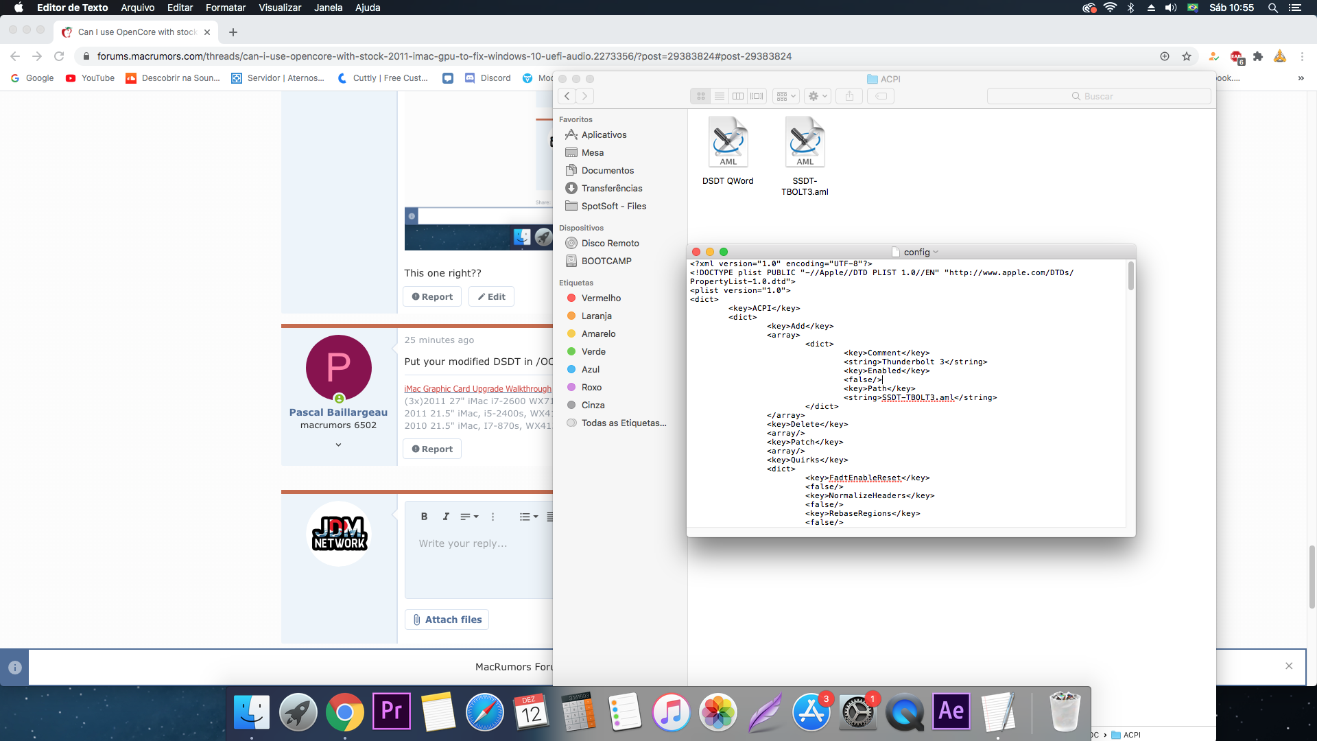

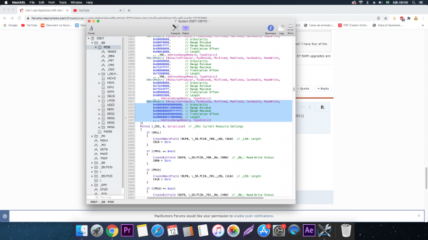

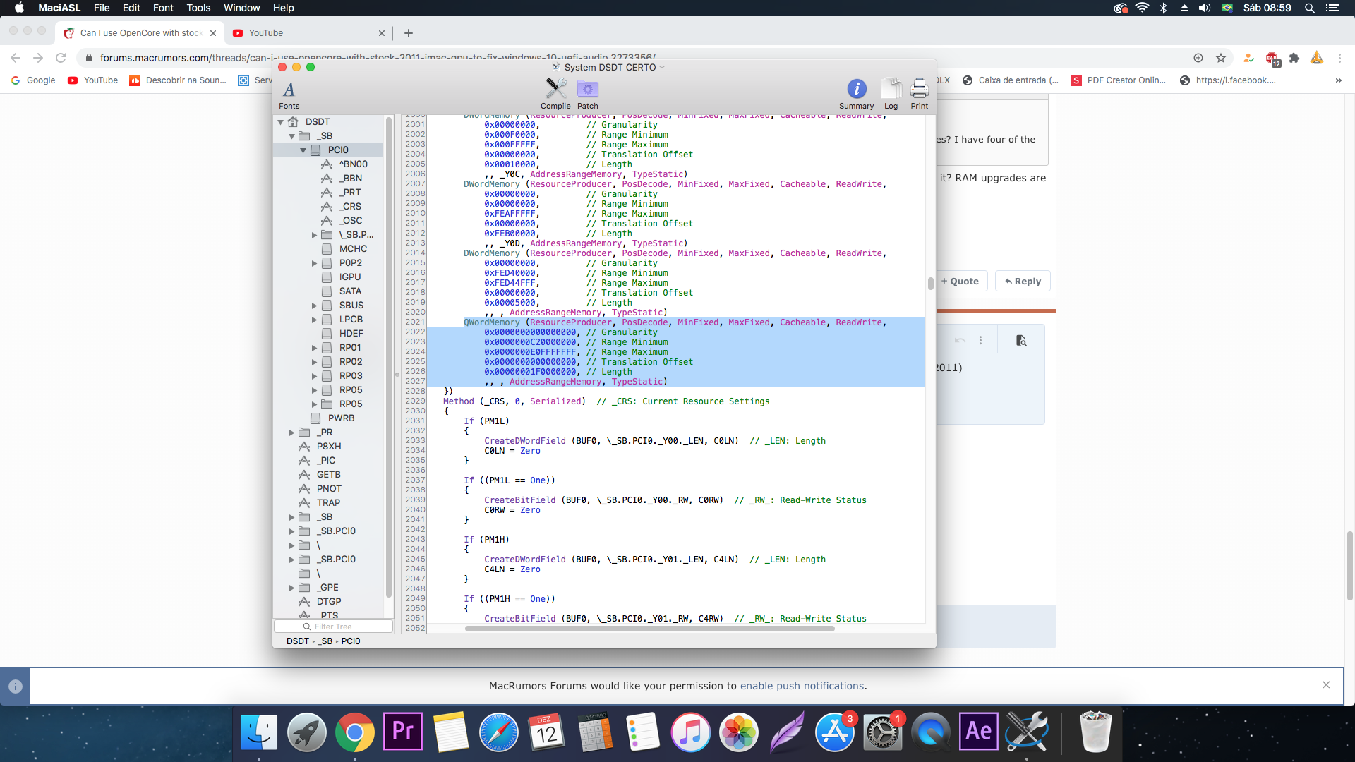

Ive injected the QWord as you said and saved, what i do next (trying to get audio in W10 UEFI mid 2011)
You misread, you have to add a Qword module after the last Dword module.
"Search for DWordMemory. After the last DWordMemory we will inject a QWordMemory."
