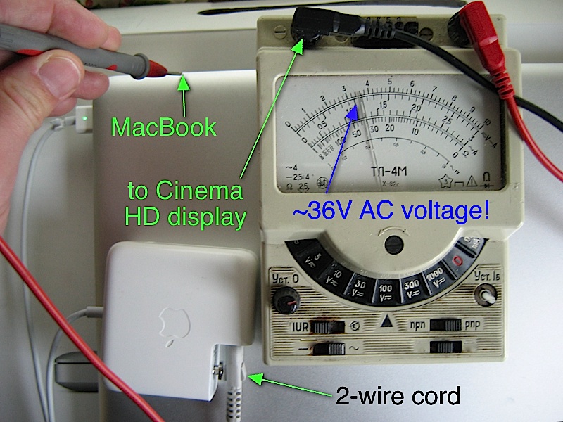

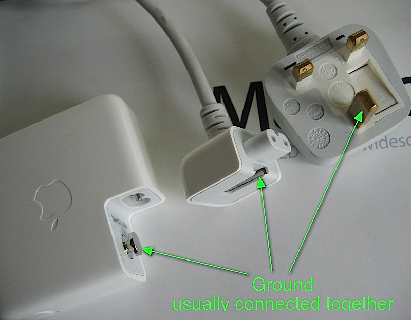

Here is an illustration to my message above.
1st picture shows the details of how laptop case is grounded when using proper parts.
2nd picture shows the presence of ~36V AC on the MacBook case when using 2-wire power cord. When Apple 3-wire cord is used the voltage reading is zero.
Our mains voltage is 240V AC. The reference point was Cinema HD display that is properly grounded via 3-wire power cord.

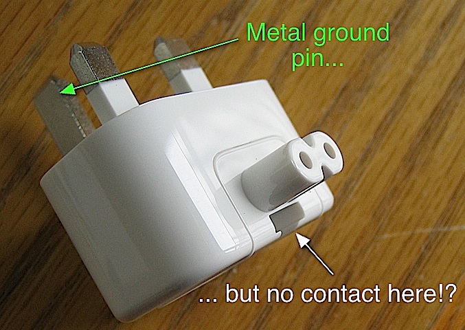

TEG, you are right, the UK quickie plastic plug that allows wall mounting of the power block does not have ground link but the power cable does! 😱
