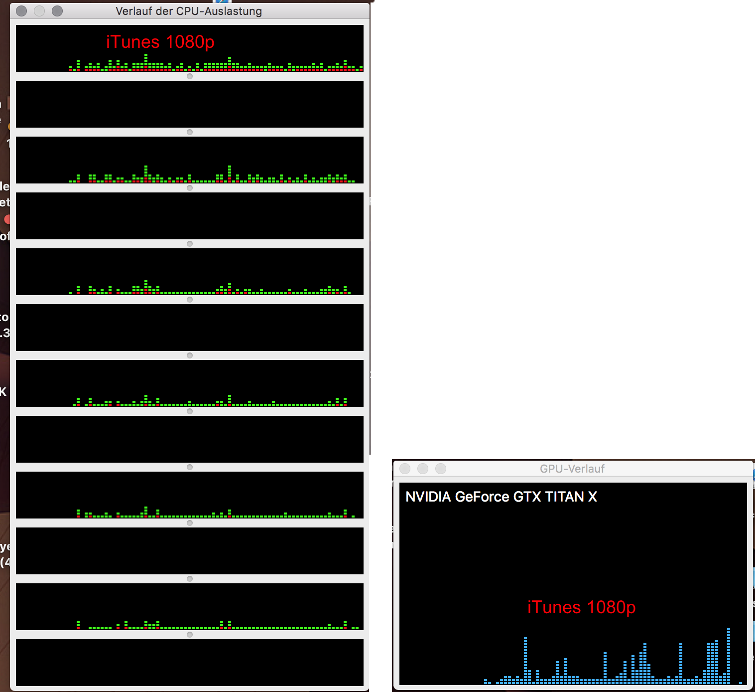

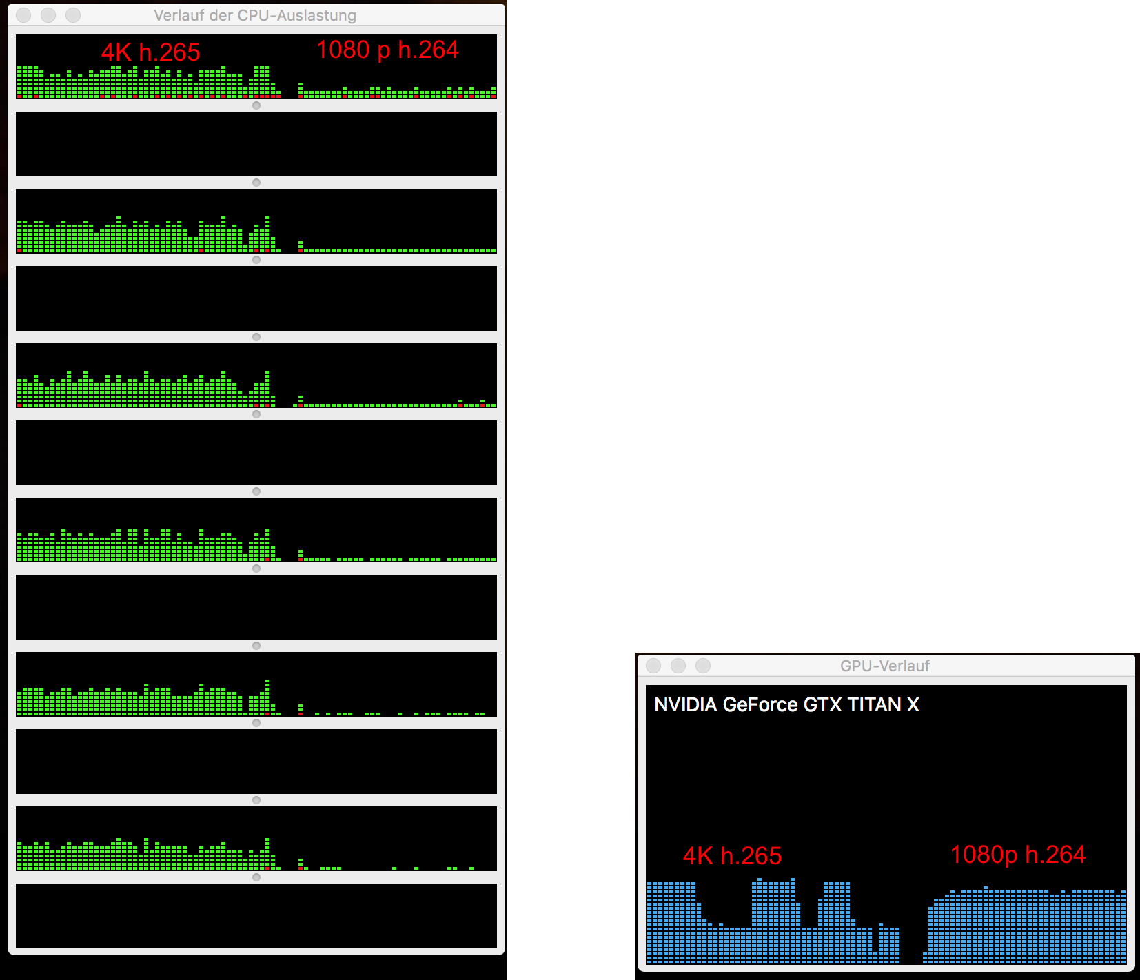

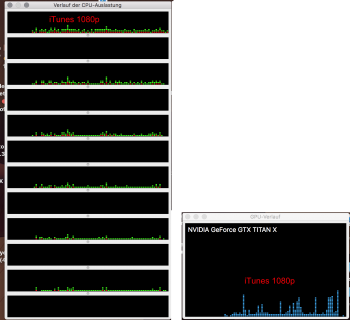

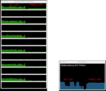

Yes, h.264 is no problem with a Nvidia card. iTunes, Quicktime, Iina, VLC make use of GPU h.264 hardware acceleration.
It's h.265 the CPU has to do a lot of the work (without RX 580).
In the pic below you can see the difference between h.265 (Iina) and h.264 (VLC).
Hardware details in the signature.
I understand that IINA, VLC, and other apps might make use of Nvidia GPU hardware acceleration for decoding, but I cannot imagine that for QT/FCPX Apple would be tapping into that for cards using unsupported beta drivers and not doing so for AMD cards that are supported/recommended for Mac Pro now.
I see 4K H.265 and 1080p H.264 (which does not require much CPU usage on Mac Pro anyway) in your screen grabs, but do not see 4K H.264. Can you do me a favor and show the percentage of CPU used when playing back 4K H.264 in QuickTime Player? My guess is you’ll see 200-300-400% CPU, depending on the source.
