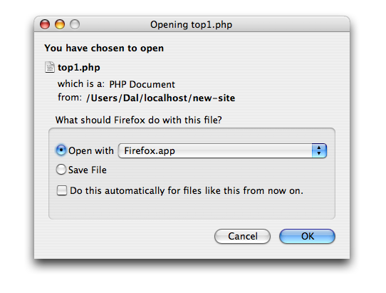

I have created a local host of my new website which I'm trying to use php 😛, and when I try to preview the file I get this appear.

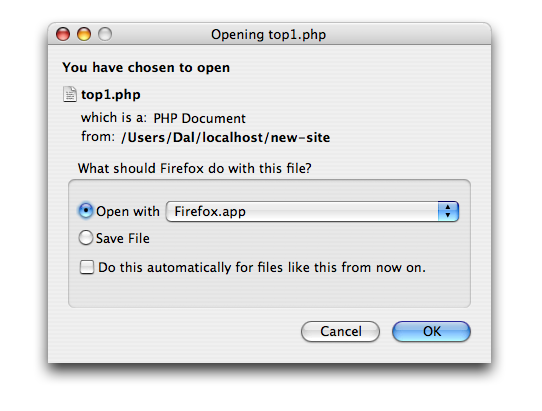

If you're still using MAMP (which is the easiest way to do it), you put your files in Applications->MAMP->htdocs, not where you are putting them.
Next, launch MAMP, go to preferences->ports & click 'set to default Apache and MySQL ports'. Now when you go to http://localhost in your browser it should show your files in the MAMP folder.
Cheers bud, I moved my htdocs folder and created my root in users so bit easier/ quicker to get to.
I realise now that I cannot preview from dreamweaver, and instead must type local address in url. woo 🙂
