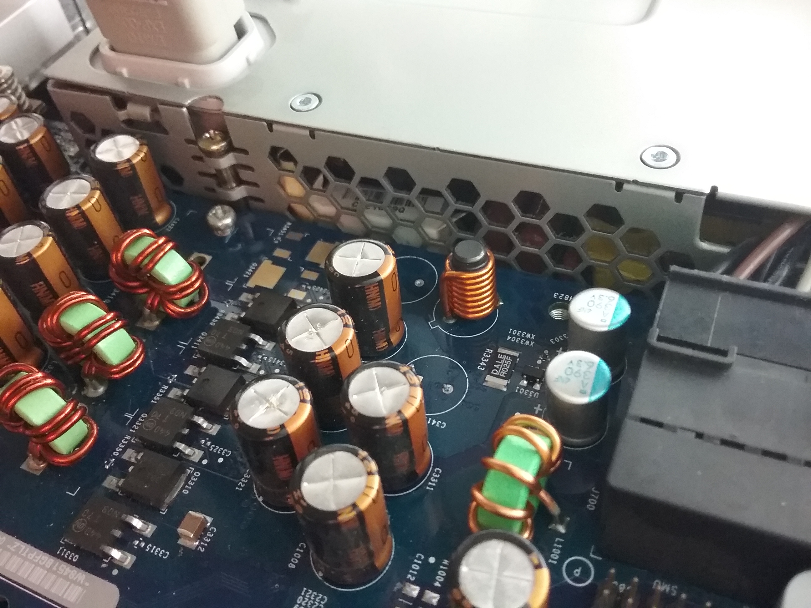

I picked this thing up for free. Ithe worked fine after I installed an os, but later on in noticed a capacitor had been torn off, and 4 were bulging. Is it safe to go on like this?

You can keep using it, but it will eventually stop booting or become unstable. I'd recommend replacing the caps.
Replacing the capacitors will likely fix it. But not replacing them and continuing to use if can result is permanent damage that will render it unusable.
Reactions: amagichnich
I've also got an iMac G5. All of the caps look normal except one that is very slightly bulging. Just that one cap makes the whole thing unusable. It boots up fine, but after a few minutes the display gets all jumbled with white lines and kernel panics. I have to unplug it for a few hours for the caps to discharge before it'll boot again.
OP, do you have decent soldering skills and equipment? The iMac G5's logic board is a challenging one to recap. You may see if you can scrounge some junk boards to practice on.
I unfortunately dont have the equipment
Even with reasonable equipment, don't underestimate the difficulty in capacitor removal from iMac G5 logic boards. From what I've read and learnt, a soldering station is highly recommended, incorporating a desoldering heat gun.
It's certainly an excellent tip to practise capacitor removal first from a scrap board. I did this with a good brand (Weller) soldering iron, and after several attempts found I could remove them ok. When I tried the same with a G5 iMac logic board that I had just removed, the scenario was so different. I failed miserably! I believe this is due to the fact that those G5 boards are not only multilayer but also feature unleaded-solder joints. This makes heat transfer to the capacitor joints difficult to say the least.
In the end I ordered up a set of capacitors from a highly recommended specialist online, and found a repairer with a pro soldering station/desoldering heat-gun to change them all. Cost 25euros - and well worth it! After I reinstalled the logic board, the iMac booted first time, and now forms a pleasant addition to my collection.
