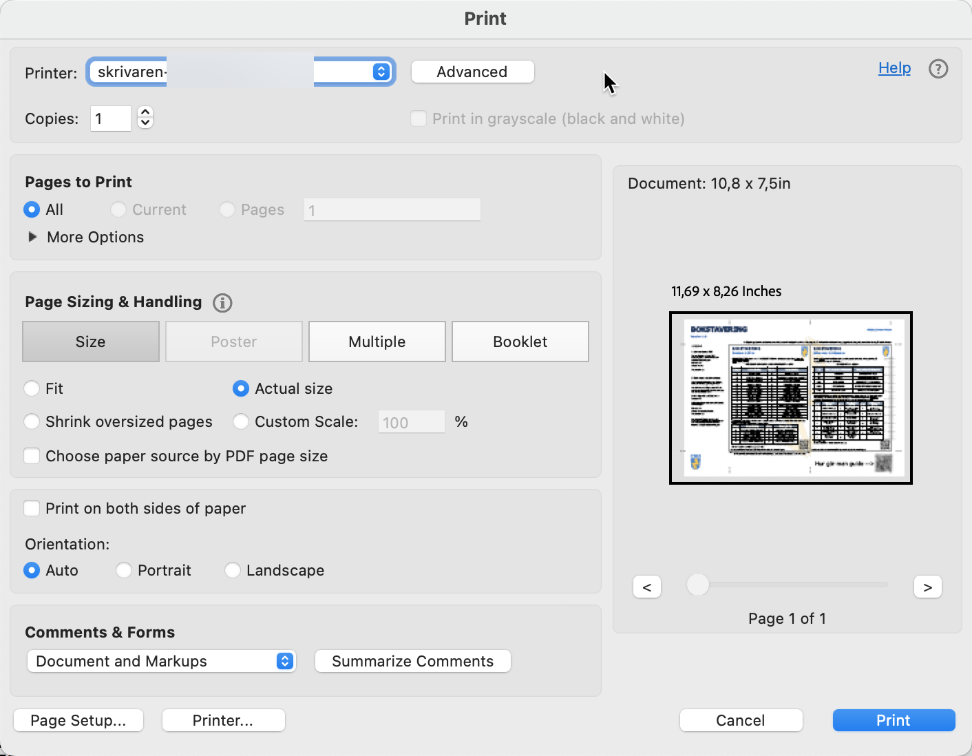

Lately I've been having issues printing to our HP LJ M281fwd from Adobe Acrobat Pro (latest version from Creative Cloud 2024.002.21005 - Continuous Release) on Sonoma 14.6.1. Have tried many different files from different places but printing never completes and the Mac's printer ends up as paused and "in use".

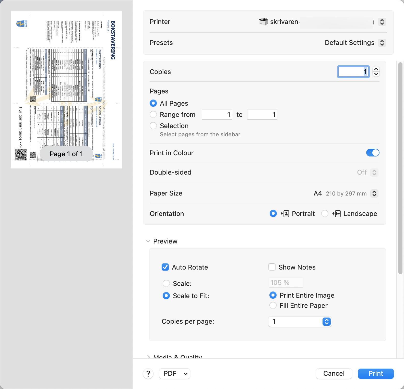

Same files prints just fine from the Preview.app.

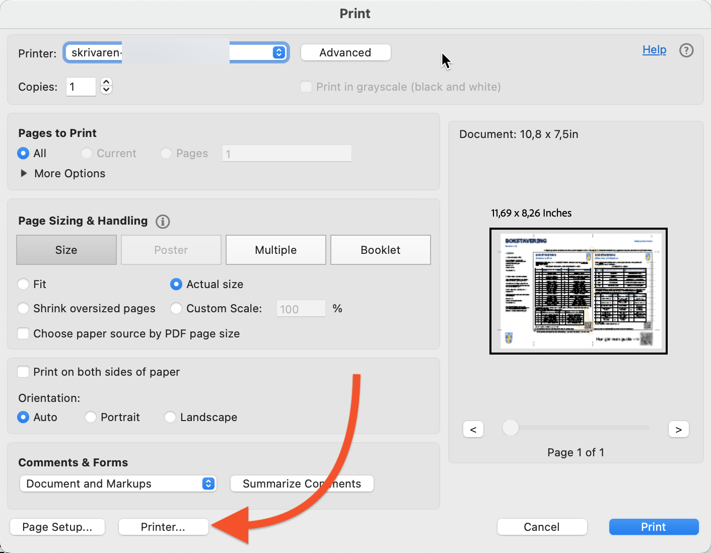

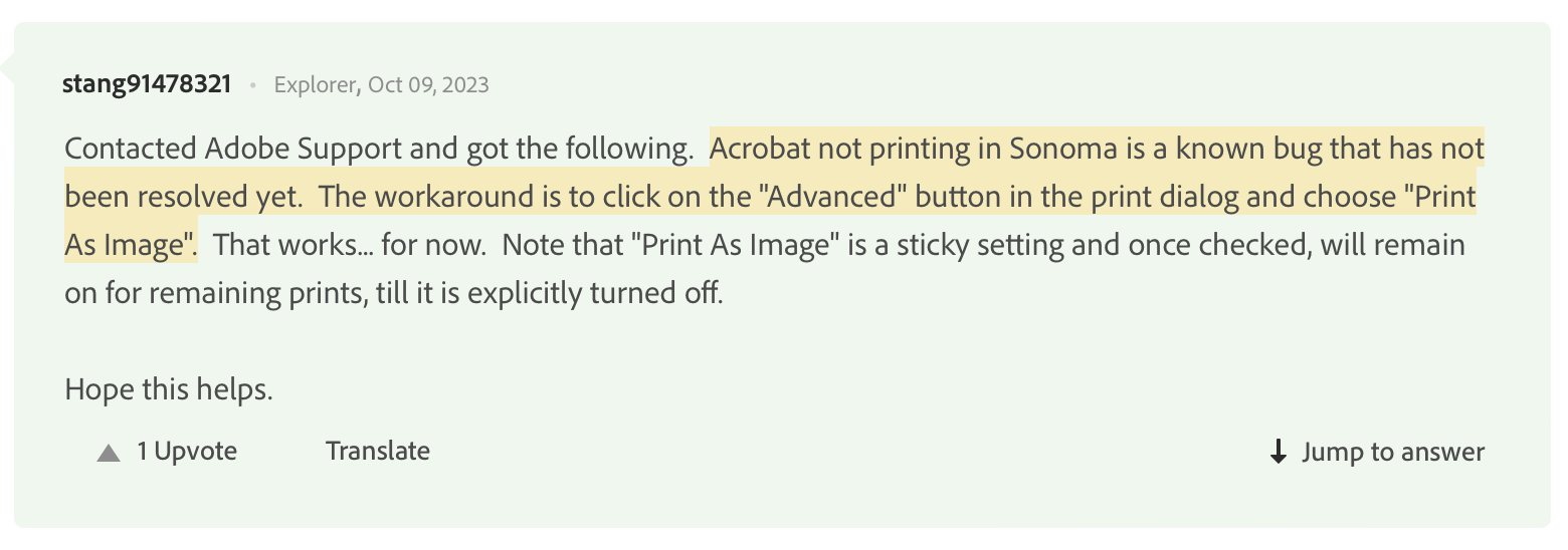

It's a know issue unfortunately.
You could try this:
Reactions: matsan
I print from Acrobat DC no problem in Sonoma. I use the old view though, not sure if that is purely cosmetic or if there are other things that are different when switching back to the old view.

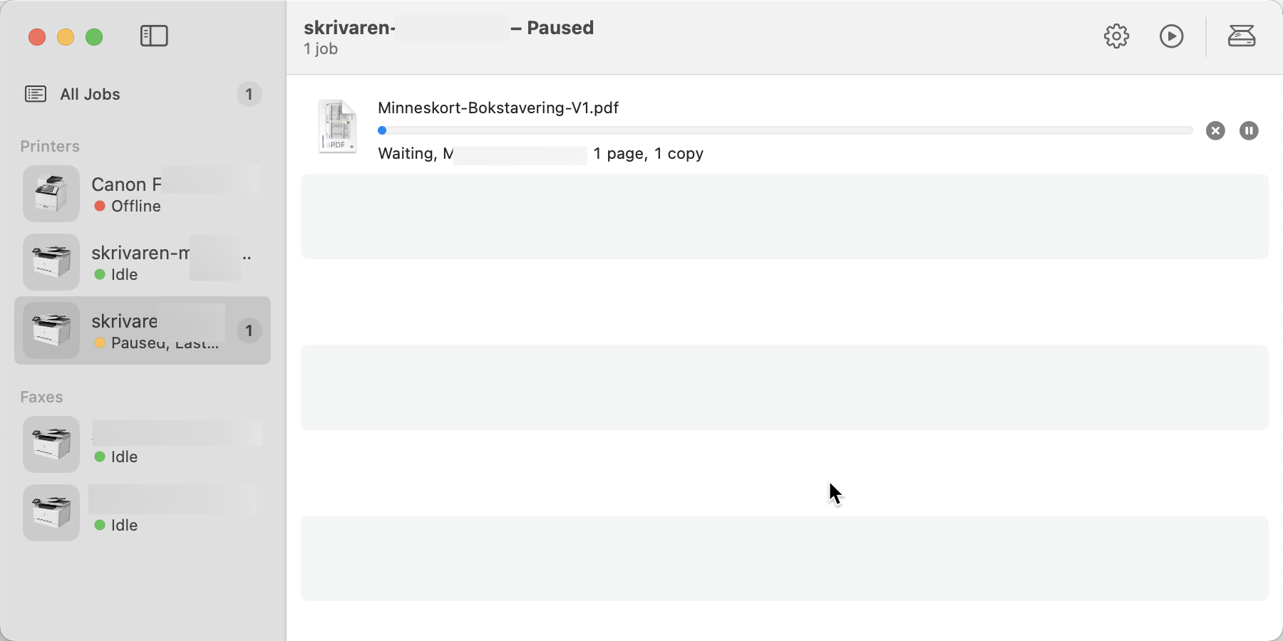

Thanks - tried it and the printing definitely behaves differently - the print job simply disappears and does not lock the printer as "in use", but still doesn't printing anything (unless "print as image" is enabled).

If you look at the bottom there is a. "Printer..." When you click on that another dialogue window opens. At the top, is the right printer selected?

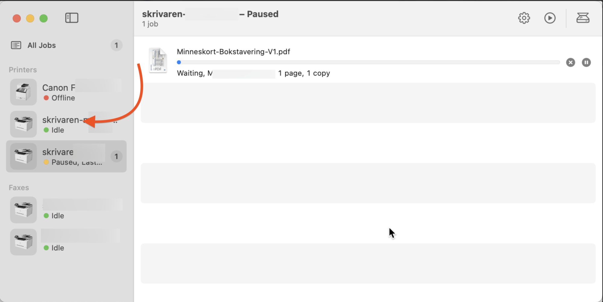

Yes, correct printer comes up but stalls on every print from Acrobat, requiring some operations to get working again.
Have you tried deleting the printer in question from the list in System Settings and re-adding it? Not sure why that would make a difference ONLY in Acrobat, but it's a quick thing to try.
They are two different printers, named "skrivare-companyname".
I have reset the printing system multiple times, tried finding updated drivers from HP, but all in vain.

  • Just always print PDF from Preview
  • Always Print as Image from Adobe Acrobat

You could also try contacting Adobe since you do have Pro and HP is a pretty mainstream printer. I suspect they will just send you back to Print as Image even if suboptimal and/or blame HP for using a non-Adobe PostScript interpreter but might be worth a shot if you can stomach their support line.
