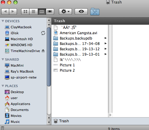

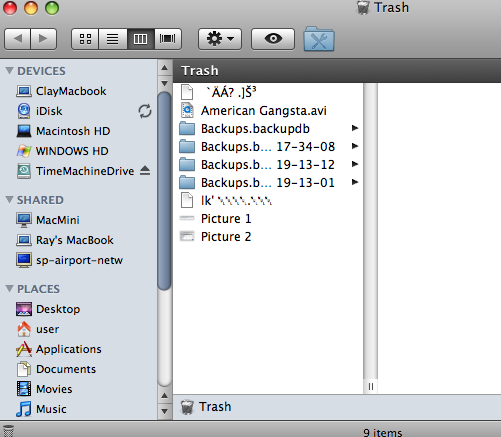

I decided to move my not done backups from time machine to my trash to delete them. Since time machine hasnt been working. I now have them in my trash, yet i can not get rid of them however i try. Here is a screen shot of my trash and what happenes when i try to secure empty trash.
I would really like them gone, considering i now only had 50gb left on my hard drive, rather than 80 or so.

was Time Machine just preparing for ages? you should of just left it as it was probably just doing a deep traversal of your backups because found a small error. if you leave it, it will eventually backup.
dont secure empty your trash with all your backups do you have any idea how long that would take! haha.
if a normal empty trash doesnt work try using the Terminal: cd to the trash in your Time Machine drive by typing

And im trying to delete them off my computer trash, now my time machine drive trash?

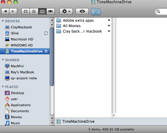

and then my trash

if i reformatted i would have to move 70gigs onto my computer, reformat then 70 back onto my hard drive. I dont even think i have 70gb left anymore.

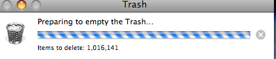

i just tried emptying the trash i let it get to over 9 million files before i canceled it.

So I tried secure empty trash just for fun and let it run all day. It got up to an unknown number last night and is now down to 41,288,874 files and falling slowly at about 4 files per second. In other words It will take roughly 7,168 days or 19.6 years before this finishes. Hmmmm did I calculate that correctly....
