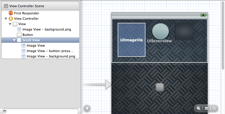

I have just added 3 UIImageView in a scrollView but I cant detect a touch for each of UIImageView...
I have attached an img for my StoryBoard so that you can easily see my issue. Please help if you have any hints for this. Thanks

I can easily see you neglected to show us the right panel, namely the connections tab.
Edit:
Although wouldn't it be a lot easier to just use a UIButton? You can assign an image to a button so that visually it looks the same as a UIImageView, but it comes with the ability to detect touches "built-in", that is, without you having to write any code to have it detect touches.

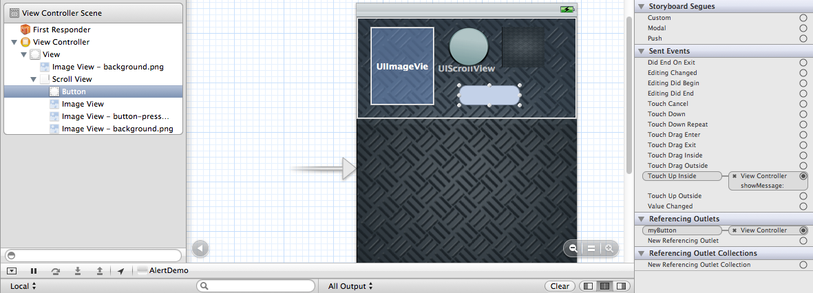

Yeah you are rite.. just gave it a try and it is easier then.. However, i would like to try out with UIImageView after all.By the way, I did attach an img with connections tab

Well, you've shown the connections for a newly-added button. But what about your images?
I think showing connections with your controller would be better... that way we'd see all the connections between it and your buttons and images.
Others are UIImageView and they are not supported for touch event.. Therefore, I have to add in the codes like below
