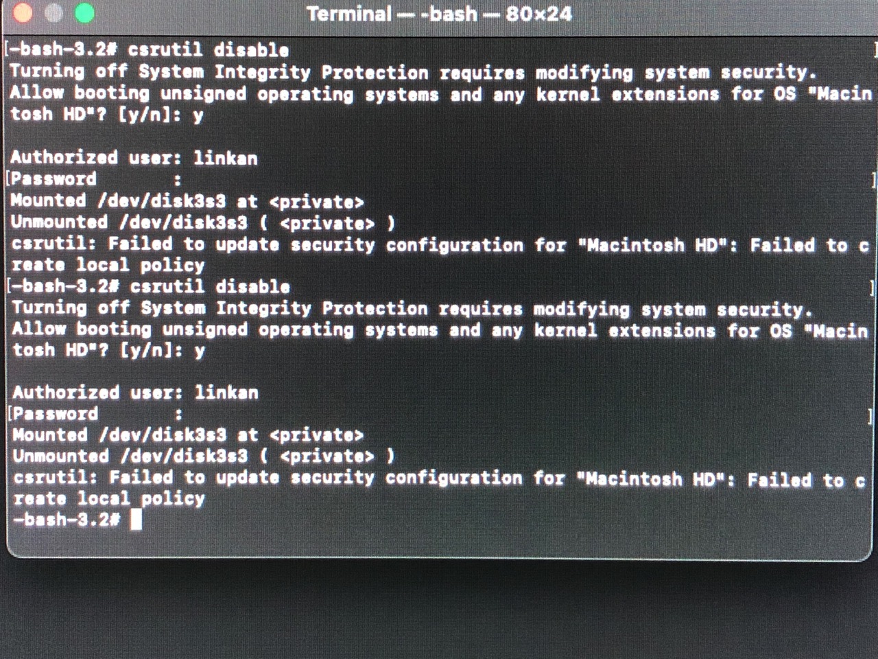

As I now are completely dependent on Xtrafinder, I want to install it on my Mac mini M1.
The first step is to disable SIP. Previously, it has worked well by starting in recovery mode running terminal and deactivating through csrutil disable. But now on the M1 Terminal also asked for username and password. See photo. Entered the correct username and password, but then only got back that it failed. Others have been successful with this, why not me? Running Big Sur 11.1.
Terminal interacts with the system through a shell. The shell supports and runs all of the commands you enter. Beginning with Catalina, Apple changed the default shell from bash to zsh. Your pictures shows bash running for some reason (you see it at the prompt).

I have seen this same error posted on another forum before in the past week or so, with no fix or workaround response to it yet, happening on a M1 Mac.
Try changing secure boot to reduced security first. Do a reboot after that and then try disabling SIP again.
If you have FileVault enabled you may have to disable that prior to disabling SIP.

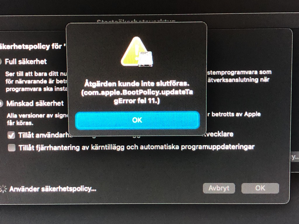

Reducing security also failed, see photo. Hm… any other suggestions?

Zsh isn't the problem so don't bother with that, and running csrutil should automatically reduce security as required. At least that's how it worked on my test system when I temporarily disabled SIP. My test system also has Filevault enabled so that was not a factor here either.
Looks like there is something screwed up with your system. If you have the time I'd try re-installing macOS and then check if it works. If not, get in touch with Apple.
