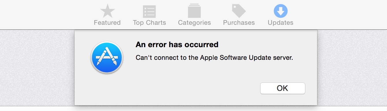

I can't get my app store to connect to the update server anymore :/

This could be the result of your Mac being infected with the I-Worm trojan. Have a look at this article to check:
http://macdailynews.com/2014/10/03/...ered-how-to-check-your-mac-for-iworm-malware/
Thanks bro! I actually had the iWorm on my mac, I deleted the folder but apparently there could be several folders as I just read that haven't been discovered yet. But i deleted the JavaW folder now, think i will do a clean install of Yosemite when it's released now. Does anyone know how this will affect my TimeMachine backups? 🙁

Is there any reason to primarily suppose that an Apple softwareupdate or App Store issue may be caused by that malware?
Thanks bro! I actually had the iWorm … Does anyone know how this will affect my TimeMachine backups? 🙁
If the backup includes any file that's associated with malware, and if you wish to remove that file from the backup, then you'll need an approach that properly handles the ACLs etc. in that context. Some of the simpler malware removal solutions might lack those capabilities.
Yes as the worm adds the apple update servers to your host file pointing at ip address 127.0.0.1 thus disabling the update servers!
Make sure to clean your hosts file of the added entries
