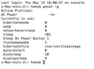

Thought to check pmset -g
Hence my Target mode ?
Did so by starting in Safe Mode rather than Target.
Image attached from pmset -g
(I have to open the image here in a new tab to see correctly)
