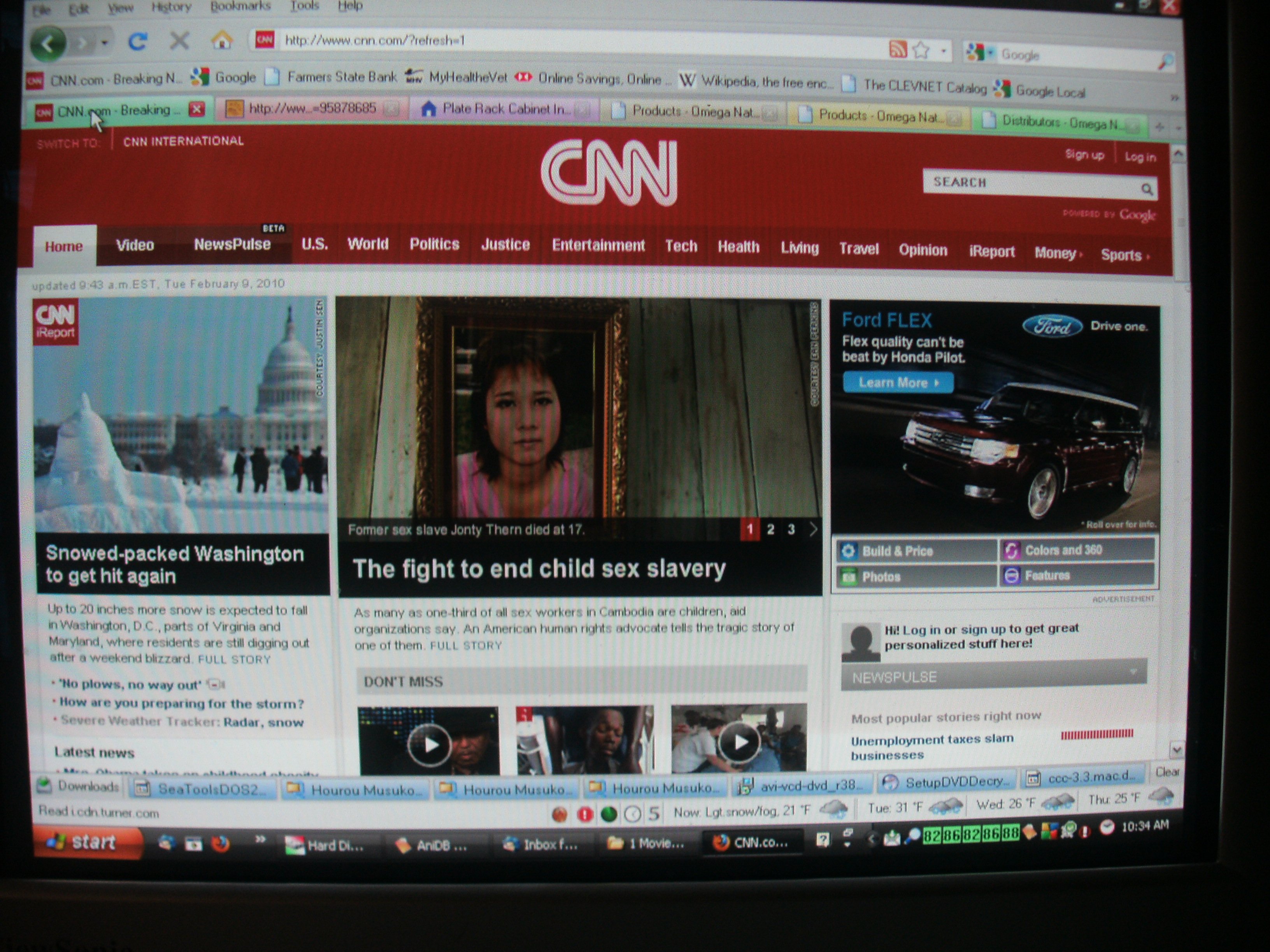

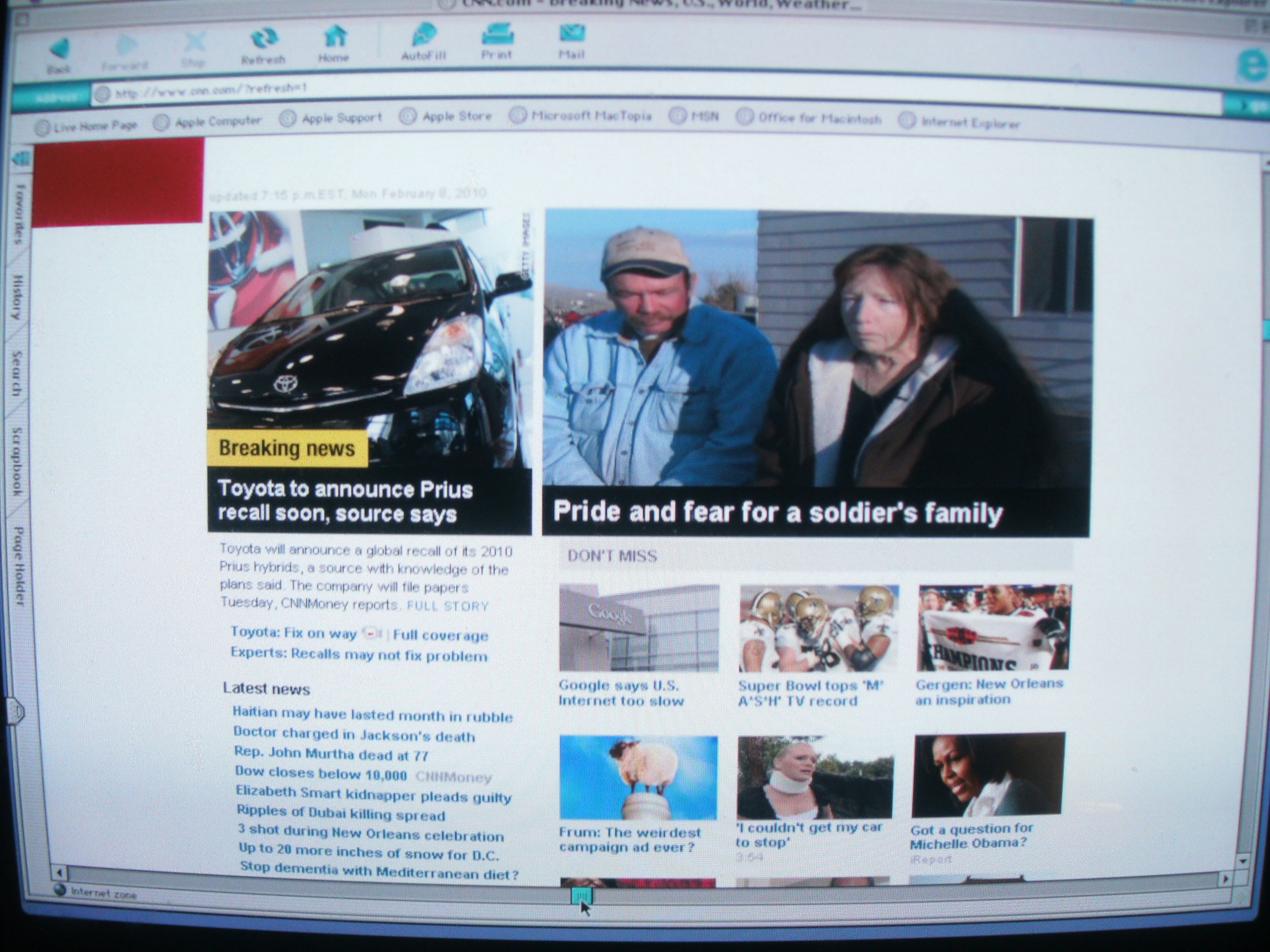

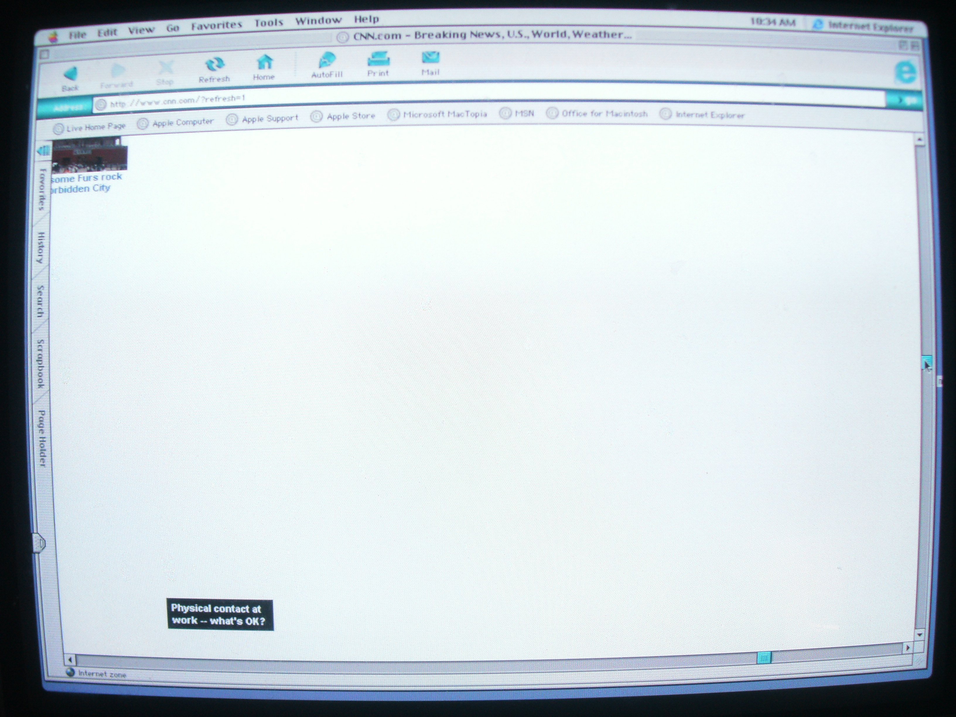

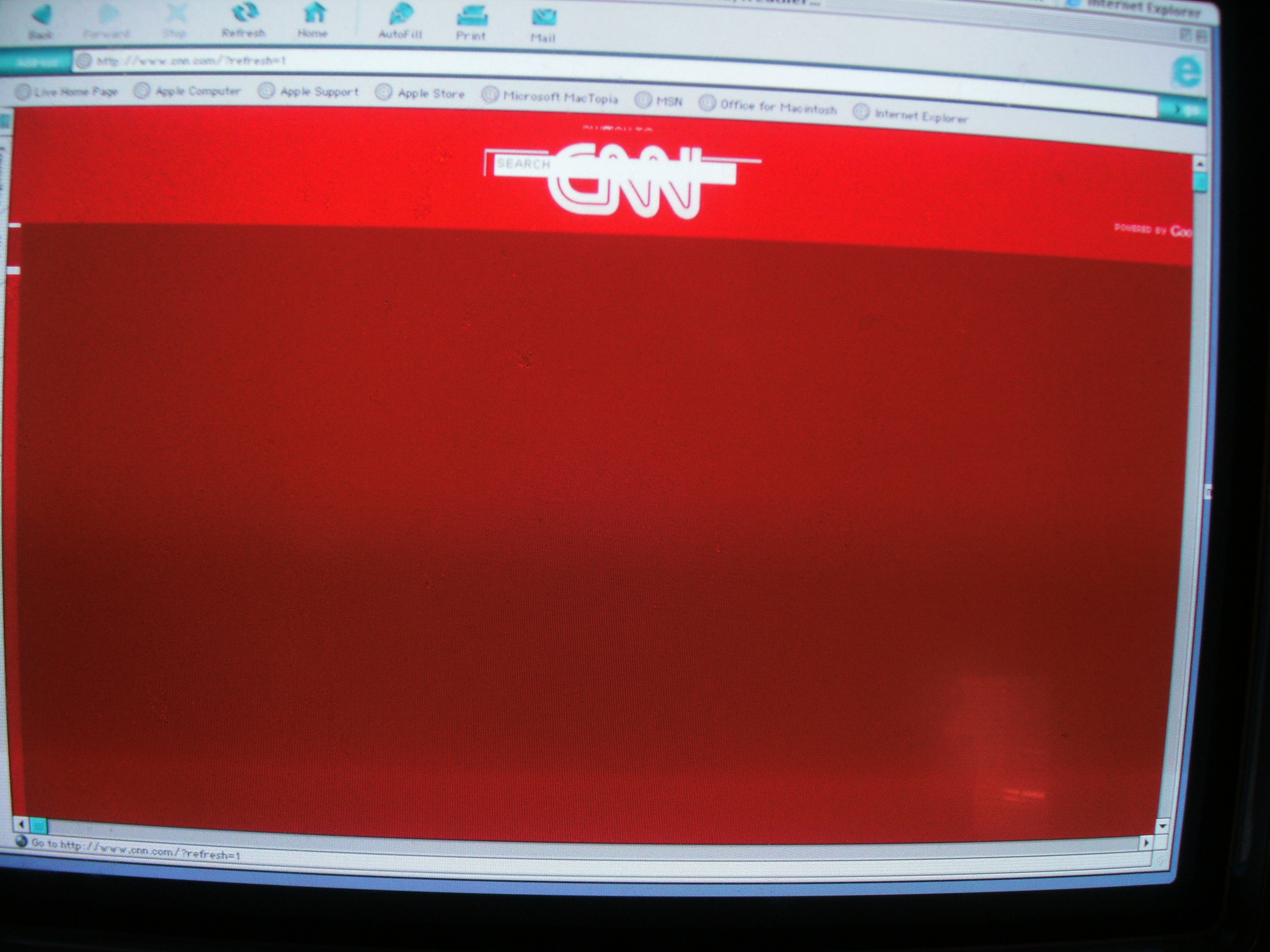

On the PC the whole width, and about the top third, of the page is shown which is normal. On the Mac, the first pic shows the top quarter and top third of the page. The second pic shows the second quarter down and the middle third to the right. The third pic is near the right side and a bit over half way down the page. You can make out the slider buttons which are a minty green. That should give you an idea of where each pic is located.
Now all I have to do is make sure I can get the screen shots attached properly. These shots were all taken with with a digicam since I don't know how to take screen shots from within a Mac. The PC pic should be first, and the three Mac pics after.

Those web pages aren't rendering correctly in IE on your Mac. I would try Safari or Firefox...
Yep, that's exactly it. IE 5 is so old that many sites simply do not support it anymore.
Safari isn't available for OS 8.6, and I'm not aware of Firefox for it either. Your best bet may be to install more RAM, then upgrade to an old version of OS X (maybe 10.3).
IE 5 for Mac has some notorious CSS rendering bugs, and those screenshots are textbook cases. Since it's such an outdated and almost unused browser, nobody bothers coding for it any more.
I'd strongly recommend trying to find an old build of Mozilla or possibly Firefox (dunno if they made Firefox for 8.6; the earliest versions were called Phoenix and then Firebird). Even better, upgrade to an early OS X (Jaguar or Panther should run well on a G3). You should be able to find a copy of Safari or Firefox that will run on them and render those sites close to correctly.
