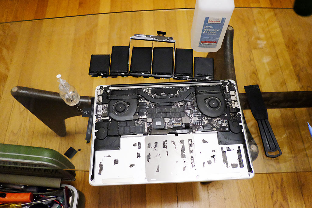

I had to remove a bad one from my machine and ditched it. Wanted to test the computer before getting a new one, but now it won't turn on. Is the machine dead or did Apple setup the machine to only work if the battery is plugged? Thanks!

Yes, I removed it with alcohol and a plastic paint trowel. Was pretty easy. I did puncture one cell slightly which is why I will not plug it back in to test. I have disposed of it properly, no worries.
Bad tackpad. Only way to get at it. The battery was at 70% capacity so I was planning to replace it too.
For those curious:

OK, Internet! I have an official answer! I was using a 60watt adapter (for my wife's Macbook Air). That's the one the machine wouldn't turn on with. When I realized I had an 85watt I tried that one and, yes, the machine turned on and booted to the OS just fine. Qap'la! I'll let you all know how the trackpad, replacement battery goes.
BTW, if you are out of warranty and need to get that battery out I say do it. It's a ten minute job. Just flood the spaces between the battery with alcohol, wait a minute, and start trowling. The only spot you need to worry about drying is under the speakers. The rest of the computer is dammed off from liquid by the middle support.

The trackpad is only $35. The battery is $70 and it's OEM from China. I've bought batteries from them before and none have ever malfunctioned.If I hadn't puncture the battery with a screw driver toying with it before getting the plastic trowel it would have gone right back in fine making a trackpad only replacement only $35. Remember, I was planning to replace the battery anyway so I wasn't terribly gentle with it.
