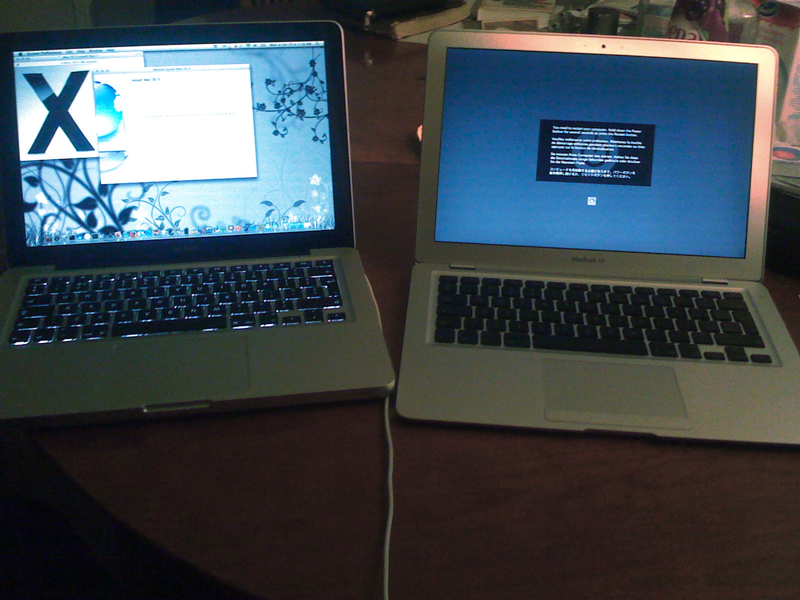

Thanks for all the suggestion guys but the only way to get it to work was for the Genius to boot of an external USB and even then it didnt recognise the images the first two attempts.
The genius concluded that the Logic board needed replacing due to either faulty RAM/Airport card
EDIT: Here's a pic of what was happening
