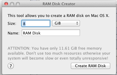

oh yeah, also, i got this app thing too.. not sure what size to try out? should i bother messing with a RAM Disk at all?

2. Should I be using a "RAM Disk" when I do work in Logic X or w/music in general?
Probably not. The only usage I could imagine is to use the RAM disk to store sample data (e.g. for EXS24 or Kontakt). This would make opening projects with a lot of sampled instruments much faster. However, as soon as you power off the computer, the data of the RAM disk will be lost. Therefore, you would need to make a little script to copy your samples over to the RAM disk every time you boot. It would only make sense if you switch between a lot of projects that all contain the same samples... not the way most people use Logic X, I guess.
I would certainly never store recordings there - any power failure, and all your data will be lost.
These days, I would just go for using SSDs for everything.
