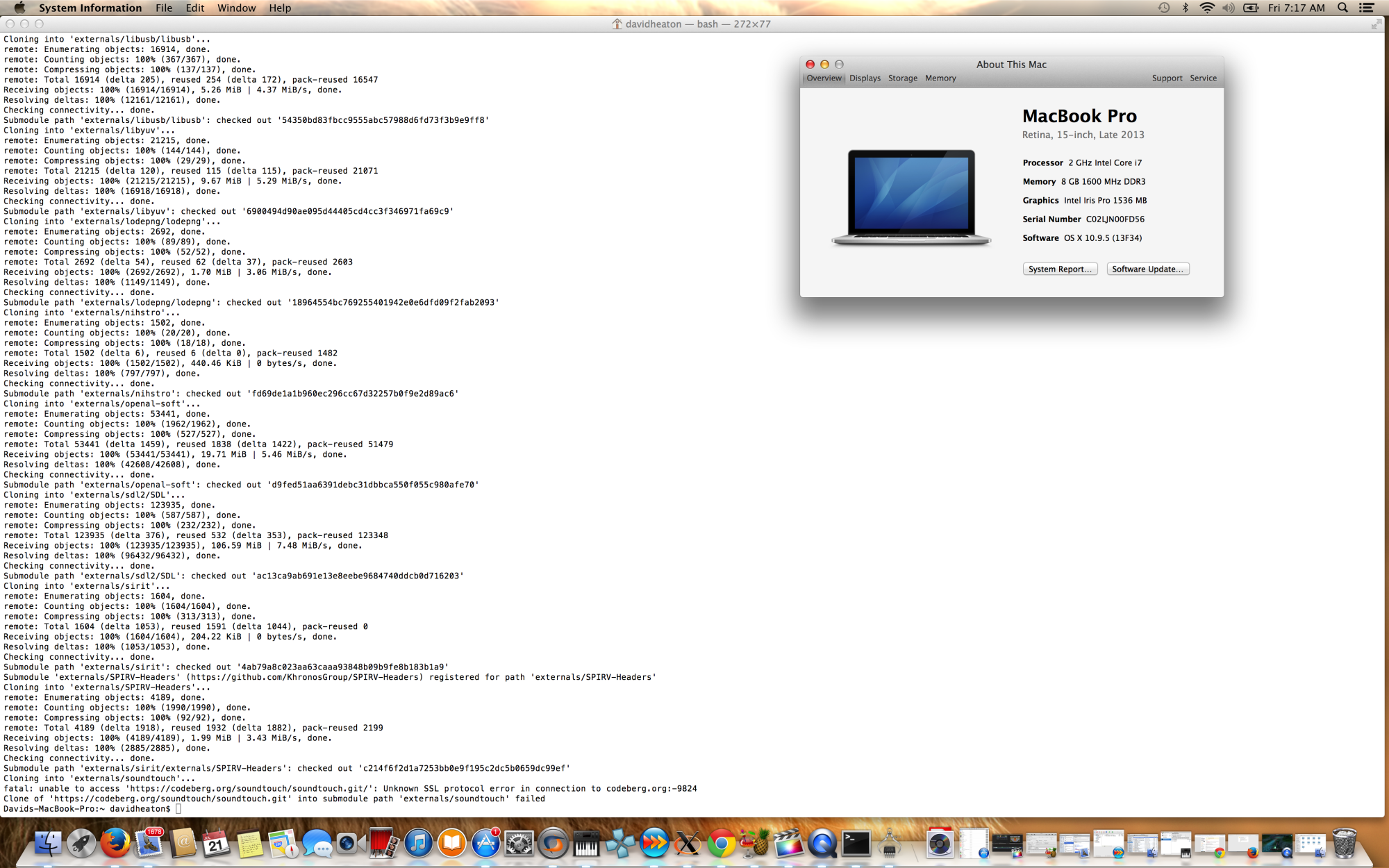

The issue im having is this it gives me a ssl error

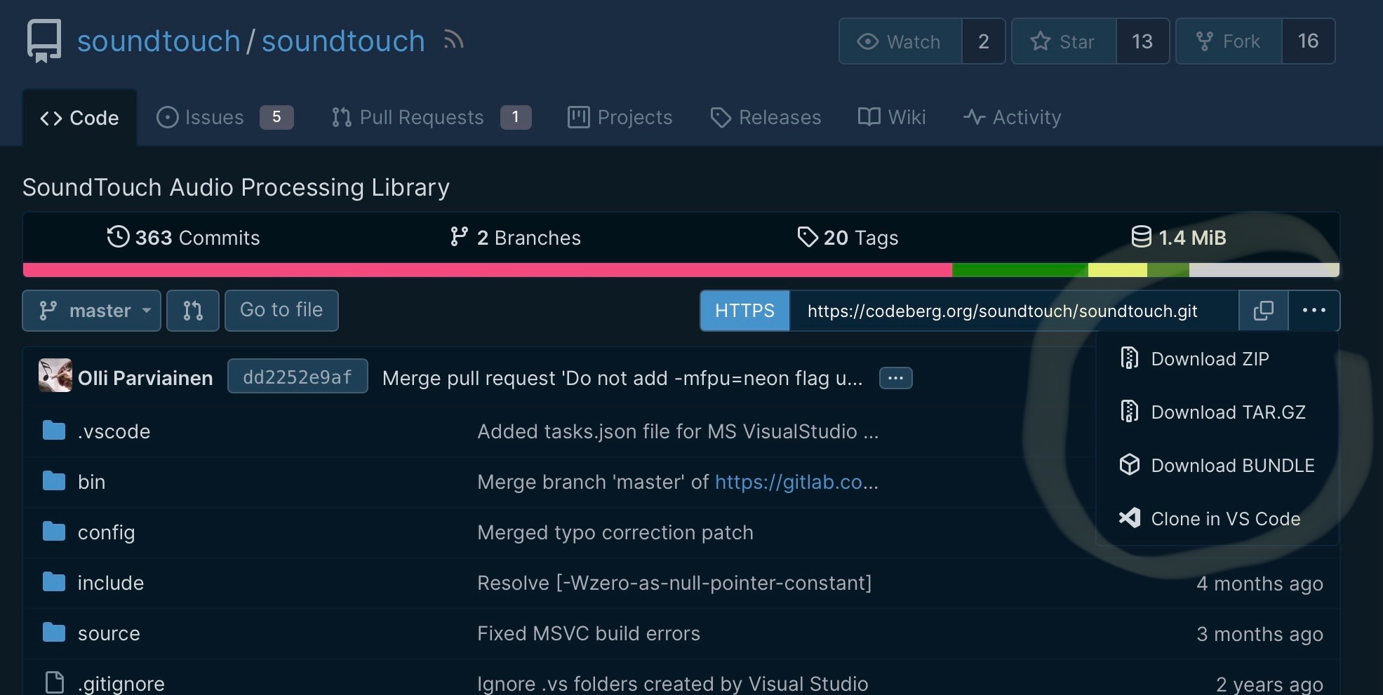

You can open https://codeberg.org/soundtouch/soundtouch.git and download the source as a .zip- .tar-file.
dearchive and copy the files to externals/soundtouch and continue from there probably. You tried to run the git command again? I do not use Maverick any longer, so I can’t really help to trace down the SSL error.

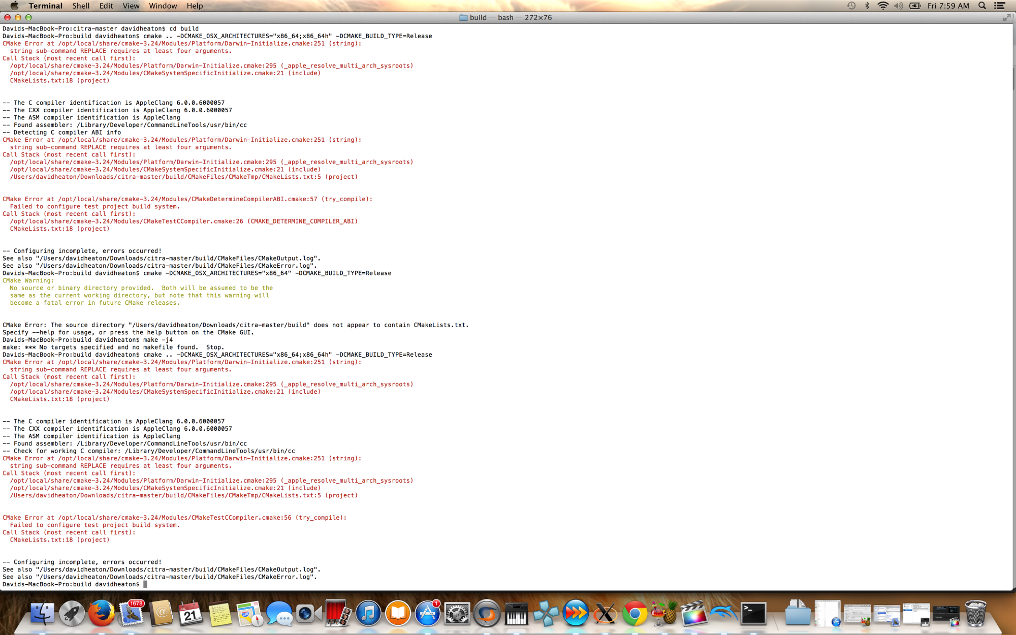

now i am having this error

Otherwise open a terminal and execute the commands given in the build guide - it seems straightforward. if you run into problems report back, there is probably someone here who can help. 😀
It's a bit trickier than that, unfortunately. Citra requires qt 5.9, which doesn't natively support Mavericks, so you need a patched copy. Then you also need to link a newer libcpp library—the Mavericks one is too old—and the macports legacy support library.
I built this a little over a year ago, hopefully it's up to date enough?
I wrote down the following build instructions:
1. Build and install Mavericks-compatible QT 5.9
https://github.com/Wowfunhappy/qt5.9-base-mavericks
2. sudo port install libsdl2 clang-11 cmake macports-libcxx dylibbundler
3. Add to cmakelists.txt:
set(CMAKE_C_FLAGS "-Wno-gnu-include-next")
set(CMAKE_CXX_FLAGS "-Wno-gnu-include-next -nostdinc++ -I/opt/local/include/libcxx/v1")
include_directories(/opt/local/include/LegacySupport)
link_libraries("-L/opt/local/lib/libcxx /opt/local/lib/libMacportsLegacySupport.a")
4. Run:
cmake -DCMAKE_C_COMPILER=/opt/local/bin/clang-mp-11 -DCMAKE_CXX_COMPILER=/opt/local/bin/clang++-mp-11 -DCMAKE_PREFIX_PATH=/usr/local/Qt-5.9.9/ ../citra/
5. Run:
cd bin/Release/citra-qt.app/Contents/MacOS/
dylibbundler -p '@executable_path/../Frameworks' -d ../Frameworks -b -cd -ns -x citra-qt
/usr/local/Qt-5.9.9/bin/macdeployqt "../../../citra-qt.app" -executable="citra-qt"

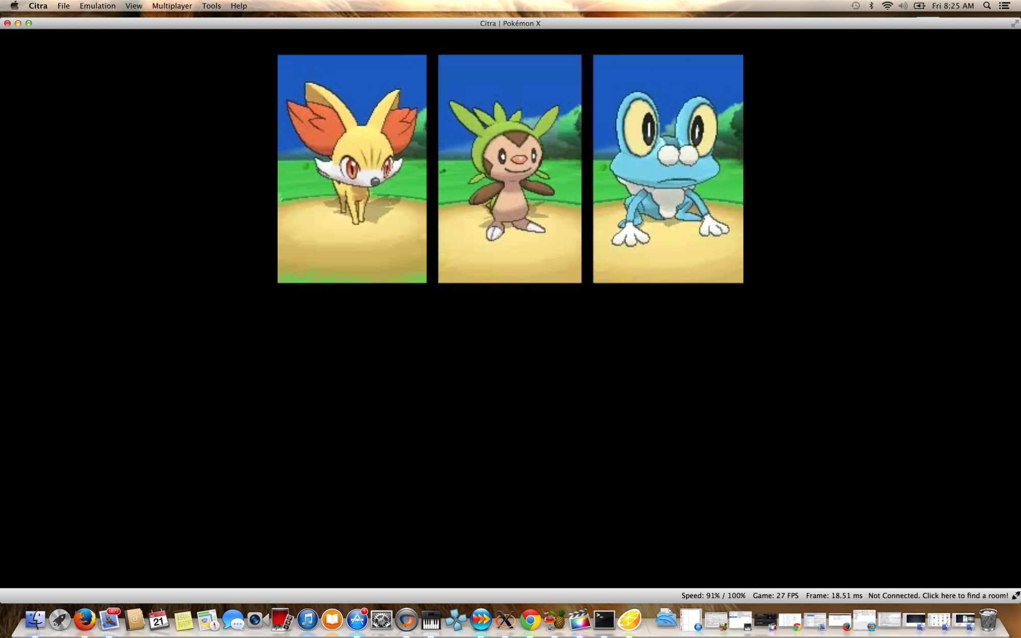

Alright!

Happy to re-upload. This build still hasn't been updated since 2022.

the build you posted has a lot of sound issues maybe the newest build (see above) fixes it?
