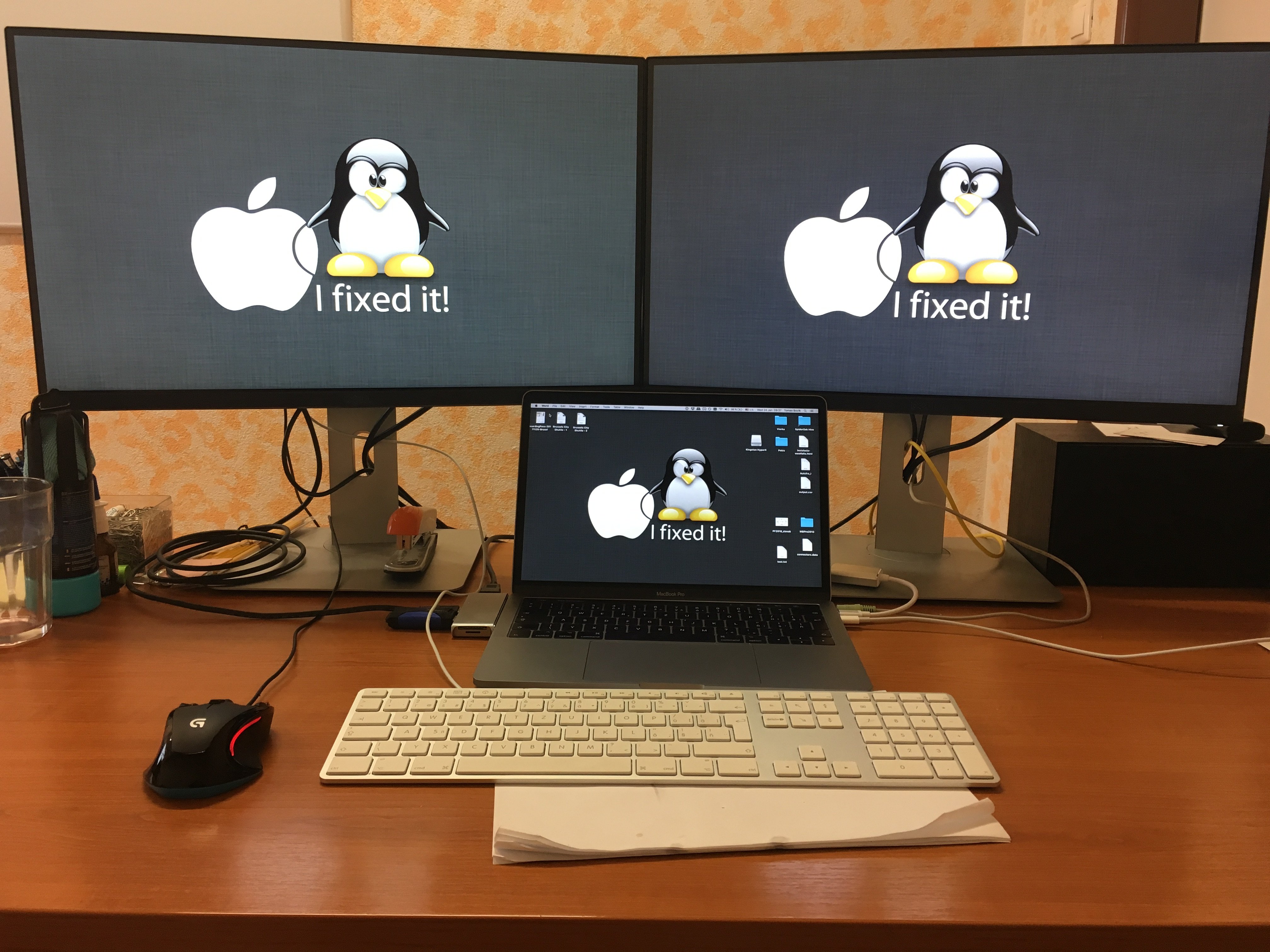

This is my setup: 2 external displays (extend mode) and the laptop...
