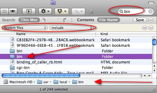

Yes, there is a /usr/local/bin folder. It's a hidden system folder.
In Finder, search for "bin", then add the criteria "System Files" > "Include"

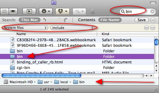

Yes, it's normal. Pick the one with the path I showed with the arrow, the same path mentioned in the installation instructions.

If you want to see the path, in Finder, click View > Show Path Bar and it will appear at the bottom of the window. Look at the red arrow at the bottom of the pic in my 2nd post in this thread.
