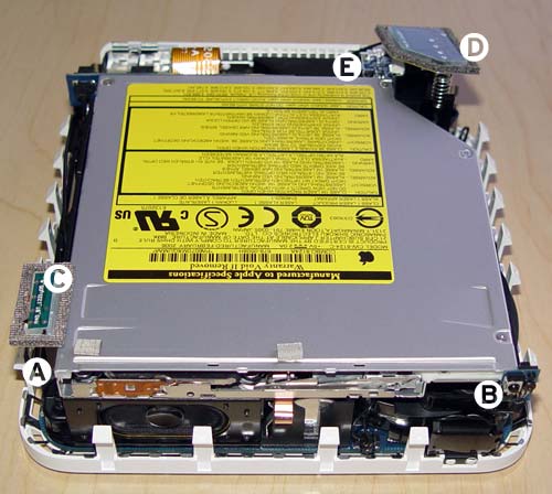

Take a look at this image:
http://www.erebos.net/articles/macmini_esata/macmini_esata-Pages/Image16.php
It's the orange ribbon cable that goes from the audio ports to the riser card. Be very careful seating/reseating the connector as they can be damaged pretty easily.

four white plastic 'fingers' that hold the top on. speaker is between the left two, and there is a small black 2 wire lead and connector right between the right two (hard to see in the photo i grabbed off the web). 😱
the audio ribbon at the back has a small plastic tension latch, release it (pull up or out... can't remember which), shove the ribbon in place, and then push the tension latch back into place.
