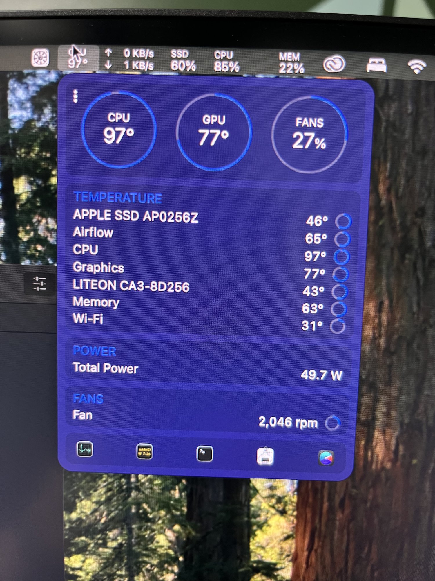

Through some more testing my 13700K is faster at export than my M4 mini by about 5 minutes for every 2 hour video which is annoying, but 600 watts versus 60 watts is insane! The power efficiency of the M4, as well as the stability of Mac OS over Windows 11 is huge!
FCP editing is so much quicker for cutting and edits over Premiere too!
Though maybe I’m getting thermal throttling on the base mini? Fans barley ran with those high temps.
