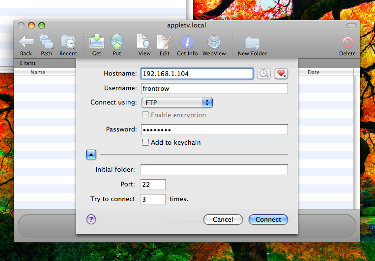

first off though- am i configuring it correctly? (i added a screenshot)

Change FTP to SFTP...
