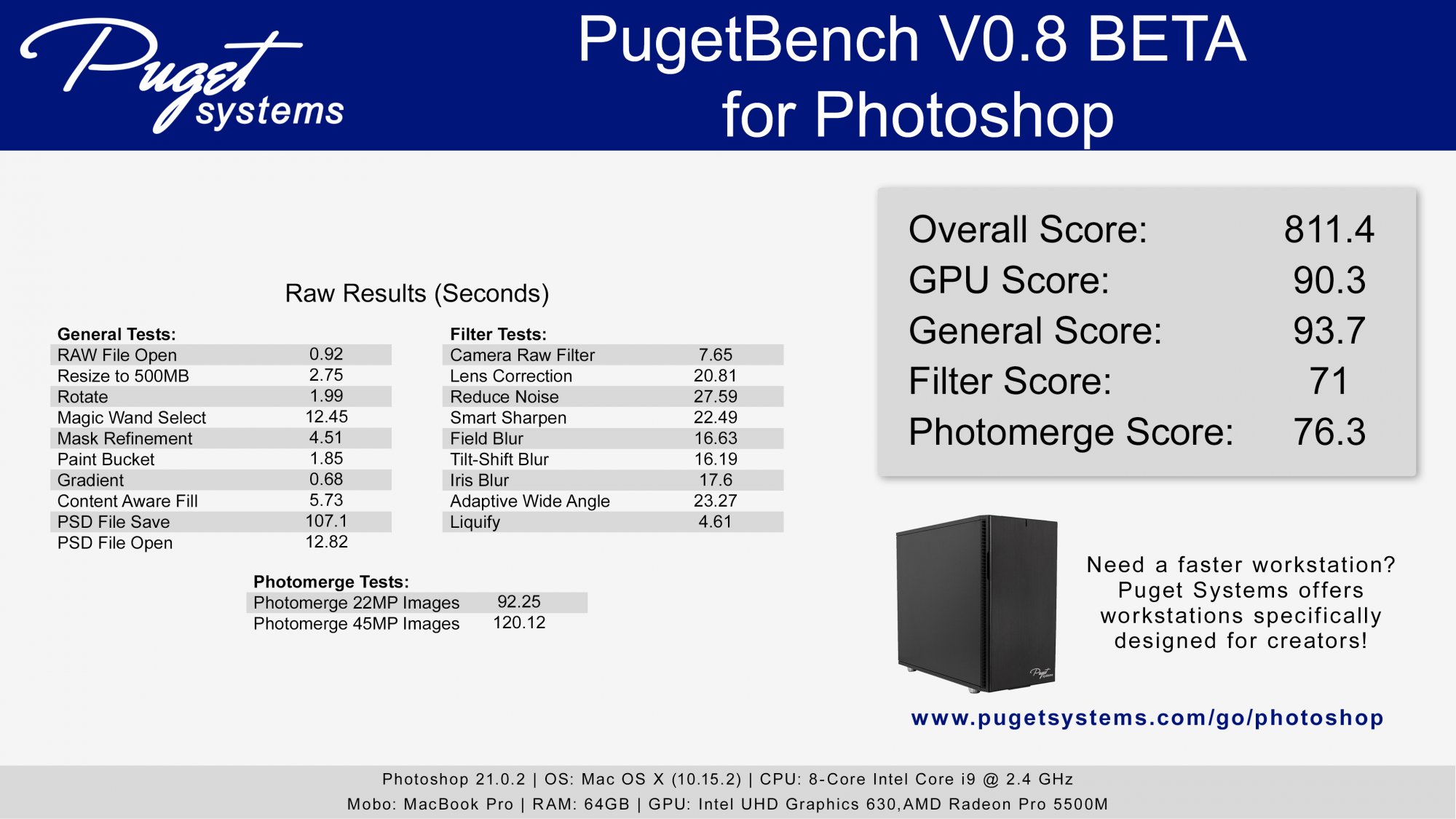

I’ve found the Puget benchmarks to reflect the type of real world scenarios I’m interested in. So I’m very curious how a high spec 16” MBP would do on this particular one: https://www.pugetsystems.com/labs/a...hotoshop-1132/#DownloadPugetBenchforPhotoshop
If anyone has a 16” with an 8-core (either 2.3 or 2.4), the 8 GB 550M, and 32 or 64 GB of Ram would please run this benchmark, I’d greatly appreciate it!
Left the default automatic graphics switching turned on, did NOT use performance mode of just 5500M. Power plugged in throughout the test.
MBP16,1 2.4/64GB/8GB/1TB

My goal was to get a baseline for how the 16" would compare to my current 2013 Mac Pro (I knew it would blow my late 2013 15" rMBP out of the water).
In case anyone is curious, this is how a 6 Core Xeon 3.5 GHz/64 GB/2x 3GB FirePro D500 compares.
Will try to run again with RX 5700 XT 8GB in eGPU at some point over the next week or two.
Worth mentioning - 10.14.6/Mojave has a LOT better GPU performance than anything in 10.15.2/Catalina in all my testing so far. An MP5,1 with RX580 in 10.14.6 is about 15-20% higher on all GPU benchmark tests vs RX 5700 XT via eGPU on MBP16,1 in 10.15.2. Real-world I'm seeing around a 33% hit on specific METAL tests.

Thanks for running the benchmark. Its interesting to see how much it varies from bsbeamers results.

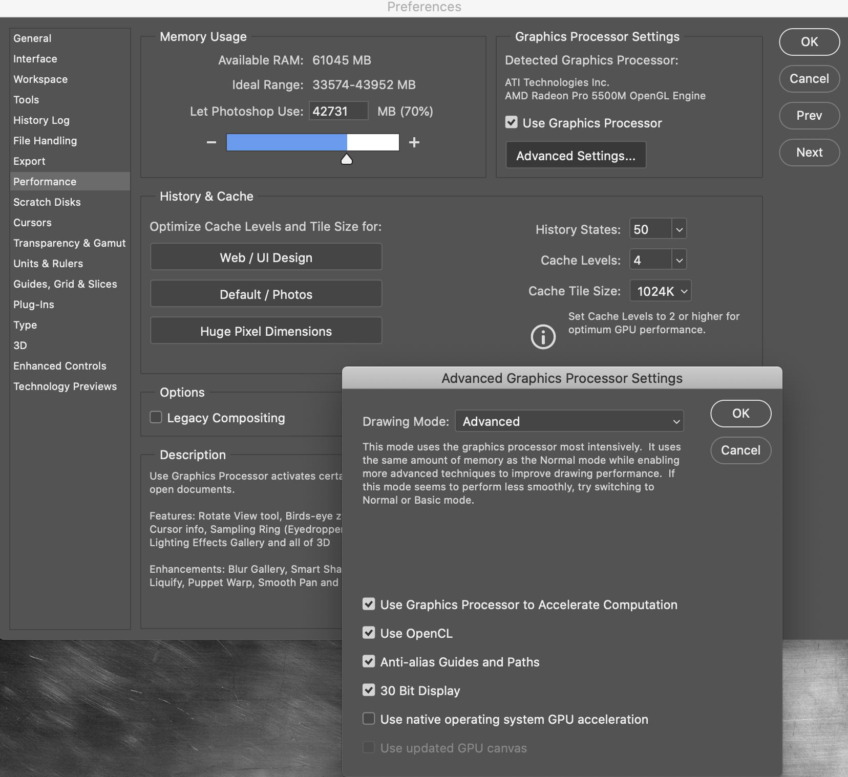

Very similar spec'd to my MBP16,1 2.4/64GB/8GB/1TB. Only difference is the 1TB>4TB SSD. Curious if you setup with automatic graphics switching for your GPU or not. The GPU scores here are 37/90 and a huge difference for being so identical.
I am not sure but here is a screen shot of those prefs:

Just thought I would throw my test results in, 2.4/64 GB/5500M 8/2TB
Thank you! Again, confirming that a nicely spec'd 16" outperforms anything I currently own.

Trashcan MP6,1 is about 75-100 points on total score over the MP5,1 cheese grater for this test. However, does NOT seem like both CPUs in the dual X5690 setup in MP5,1 were being utilized and report stated 6 cores (not 12). I know this is partially (mostly) PS not taking advantage, but real world difference between this MP5,1 and MP6,1 is not that drastic.
MBP16,1 is close to double the MP5,1 performance on this test. Says a lot for power of this laptop.

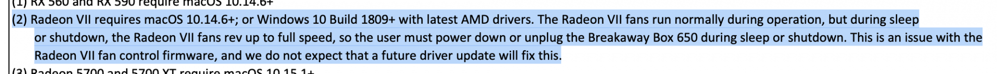

The RX580 is a sub $175 GPU and close to dated technology. I realize it's never been the latest and greatest immediately on macOS when it comes to GPUs, but there are so many signs and promises of GPU performance in the past year, including the official eGPU support, that it should no longer be this way.
Also see Note #2 for VII:
https://www.sonnettech.com/support/downloads/manuals/Compatibility_Graphics_Cards.pdf
Oh wow... that fan issue is a huge red flag.
You may have just saved me a lot of frustration (and money if they wouldn’t allow me to return them). I had a pair of VIIs in my cart and was considering buying them today while they’re still in stock. But if they’re going to have a potential issue like that, I’ll have to wait and see.
