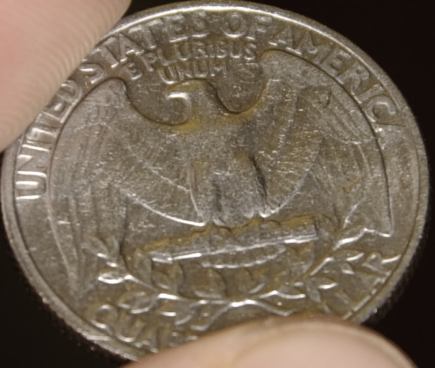

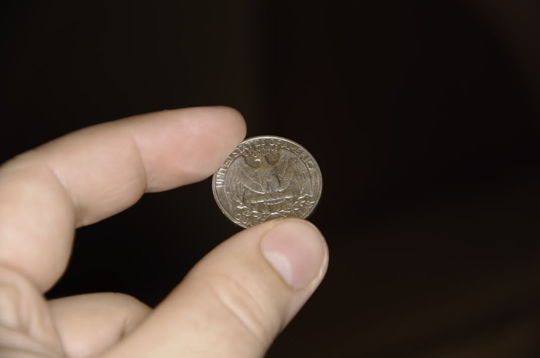

Back on topic.. I've done a few shots to show you how close you can get with stock 18-105 kit lens.
tight shots are close as I could get with autofocus.. then the crop is same pic just cropped
hope it helps
These are all taken at 105mm @ISO 320 and are lit with a macro ring light flash

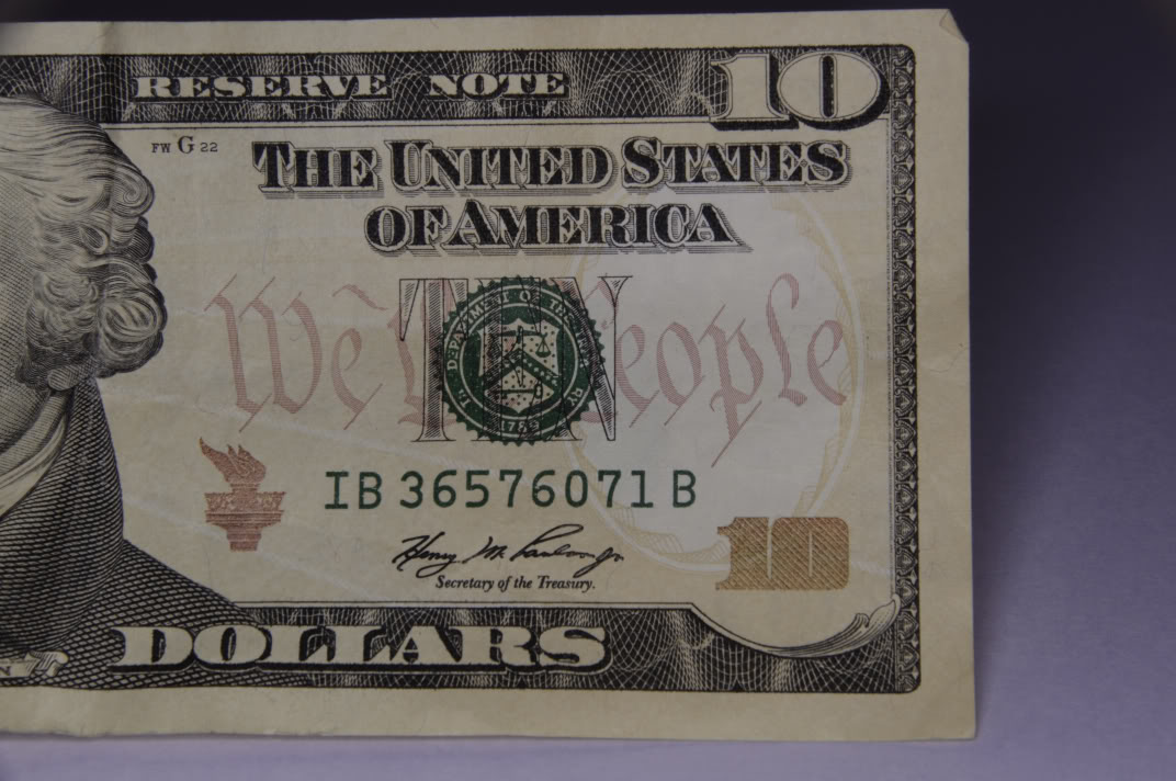

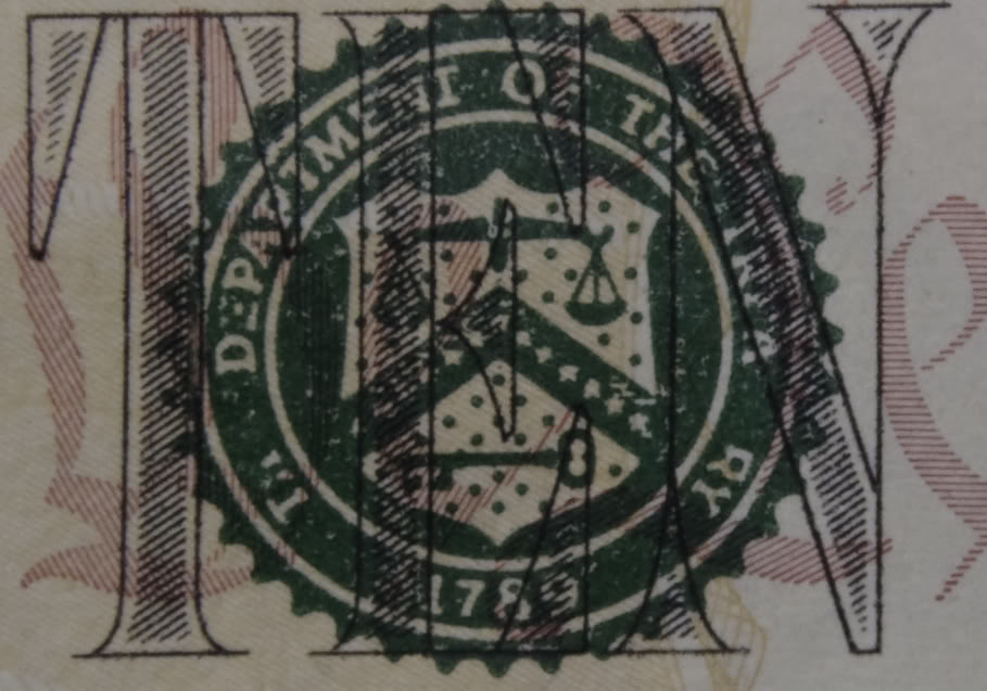

Indeed. For the sake of comparison, here are similar photos shot with a D2X and a 60mm AF-D micro. Lighting is from a pair of 250w flash bulbs, the camera was on a tripod and positioned as closely as I could focus - a bit over 6", and a remote release was used. These have been resized, but that's it. No cropping, no sharpening. EXIF information is in the image. The images are thumbnailed and link to a larger image.
