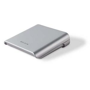

    I am planing to expand my media server. I now have a 2 TB FW 800 external hard drive with the Mini, but I need more FW drives. Has anyone tried a FW800 hub? Will I lose any performance?
    Belkin Firewire 800 hub:
    [​IMG]

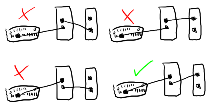

    Excuse my poor diagram!
    Couldn't tell ya, I never do that :)

    Thank you for the diagram. I would have never thought it only works one way.

    #8
    It's for consistency chaining I imagine. Computer links to top port, bottom port connects to top port... rinse and repeat. :D
