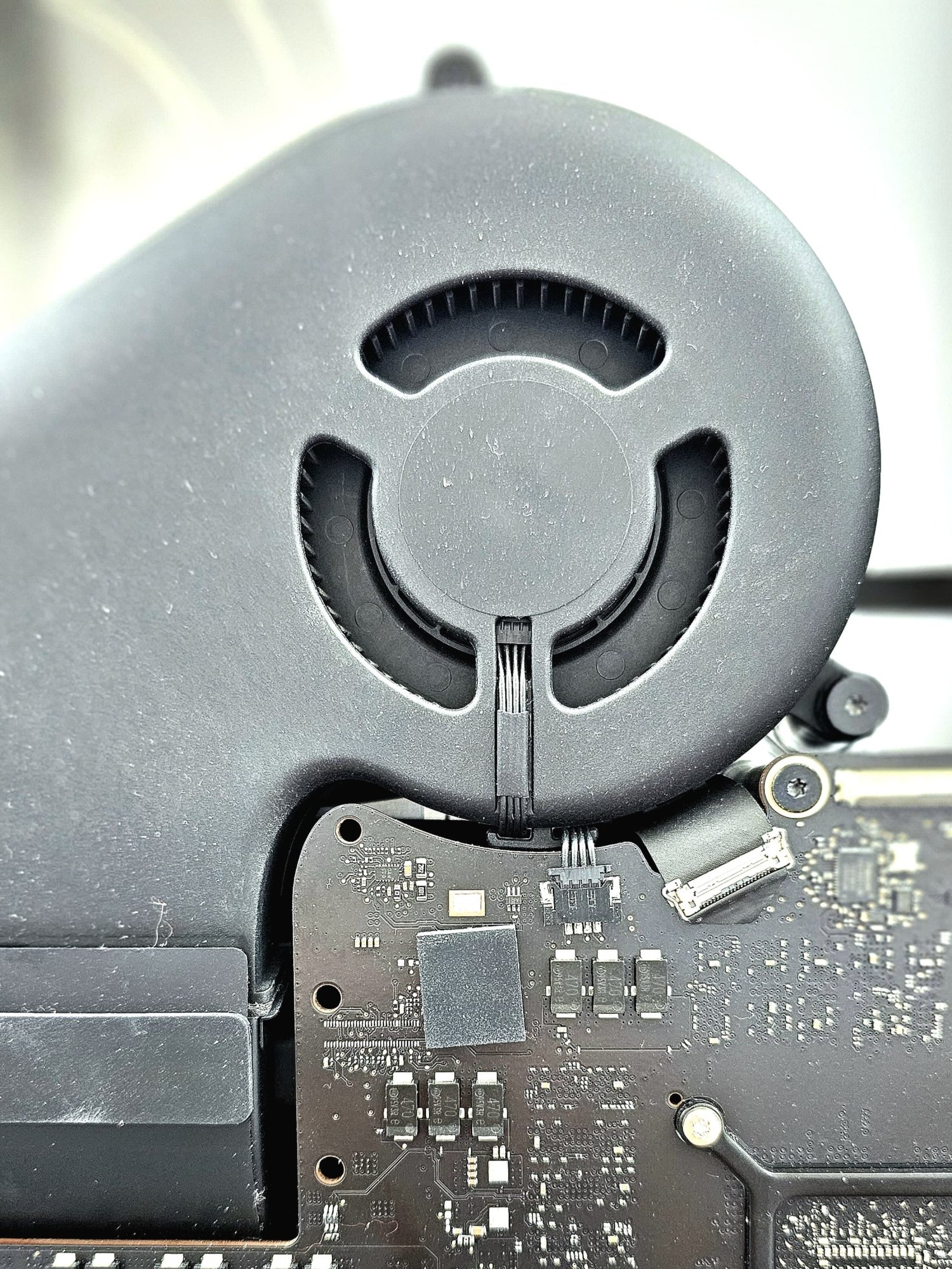

My iMac 27 2019 fan is not working. Looks like a Logic Board issue. So, the CPU gets hot and computer starts behaving really slow after sometime. Rather than spending a fortune on the repair, I was wondering, can the imac four pin fan be powered on using a special external cable via usb port of the imac itself or any normal power adapter? Has anybody explored this path? Thanks

The fan connector in your picture does not appear to be completely seated... (might be OK, just a mention that it doesn't look tight in your picture)
If you are already at the fan, then just three screws, and a little fiddling with some tape to remove the fan.
Takes less than 2 minutes to replace the fan. That, of course, is if you still have the iMac front open, and the display out (the hardest part of the job)
Replacement fans (if you can find one) are mostly less than $20

The iMac 27 fan is a regular PWM 4 pin fan but Apple swaps the power wires, so the 4 wires are + - Speed PWM (L to R in your pic as they exit the fan hub) with 12 volts needed. You can control the fan with a cheap 4 pin PWM controller with a temp probe.

The fan connector is perfectly flush. I have tried replacing the fan also, nothing happens. So, looks like an issue with Logic Board.

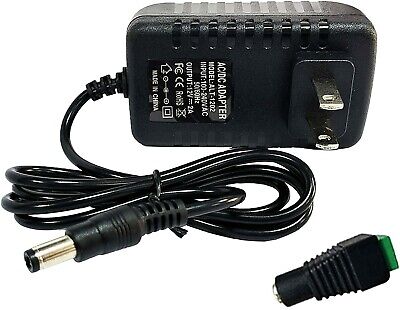

I am leaning towards ordering this config as well. would this power on the internal imac 2019 fan out of the box?
Thank you! How to power it on? I need a mechanism which can power the internal iMac fan from an external source, which allows me to control the fan speed as well. Thank you
It uses 12V, you can screw in 2 wires from an external 12V adapter, or take it directly from the iMac PSU, if you want 100% internal. It's thermal controlled, too.
Check the pdf file for a clear user guide including how to set the DIP switches.
Reactions: Neutral Singh
