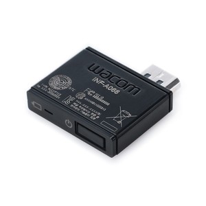

Just to give some more visual reference, here's the bluetooth module from the kit that goes in the slot to the side of the tablet, it has the power button that I'm talking about -
According to Wacom, this has no Bluetooth capabilities.
Wireless Module (INF-A068)

Since Bluetooth probably costs some money to license, Wacom, and many others, stick to their own receivers using that frequency range around 2.4 GHz, therefore you have to live with that in a way.
You could always get a USB hub and if available, an extra receiver.
