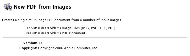

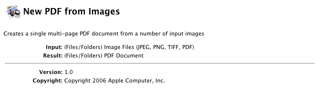

Sdahe macrumors 68000 Original poster Aug 23, 2012 #10 OK.... now I need a script that merges the JPGs back to a single PDF...
K kryten2 macrumors 65816 Aug 23, 2012 #11 Have you tried searching? You could try this : Attachments Picture 1.png 19.2 KB · Views: 148
