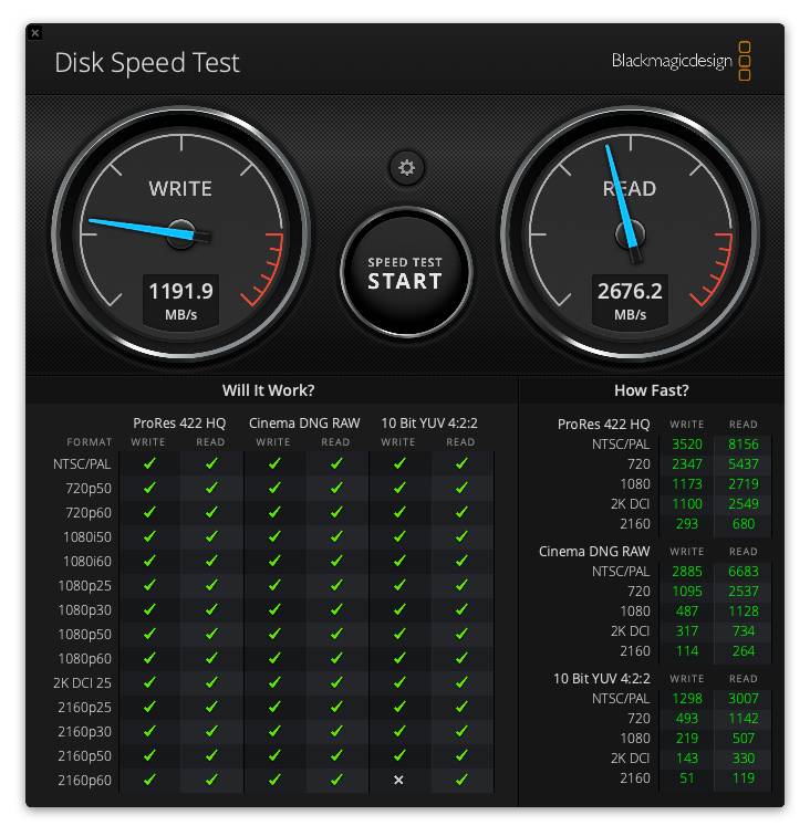

Here is my Sabrent SSD attached via TB to CalDigit directly to my Mini M1 via TB - 5 gig stress test.
Final - reverified. Sorry for the mishap. Compared to Element better write, slower read. My take is there are similar enough to run either way.
