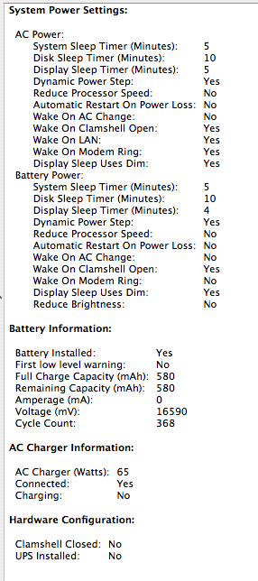

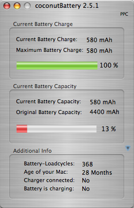

Can someone look at the information I've attached and extrapolate if this means my battery is "close to" DEAD?
Slowly over the last 3 months my computer shows a 100% charge and when I uplug the adapter it gets to about 90% (within 3-4 minutes) and then shuts down without a warning. 😱
Thanks. I don't have the knowledge to understand the terms "cycles" and "voltage counts", etc.. 😱

Have you been calibrating your battery regularly? If not, give it a shot and see if that gives you better info from the battery.
But it looks like it's dead...cycles are getting up there. Time to invest in a new one.
That battery looks about dead to me. It is time to buy a new battery unless you were planning to upgrade your computer soon I'm which case it is probably better to upgrade than to spend the money on a brand new battery.
WildCowboy, Thanks for the fast response.🙂
I'm afraid you're right because I have calibrated in the past 3 months, although not out of competence but just as a result of using the computer and it "shutting down."
The only difference being that I didn't get a "low-battery warning dialog on the screen" as stated from Apple's website that you kindly linked to in your response.
So probably time for a new battery.
Thanks again 🙂

CoconutBattery?! I had no idea that such an app was available. How very cool! I'm showing 54%. Good thing my Powerbook's getting replaced soon.
