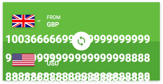

Very nice! Just a couple of small things I noticed.
It could do with an overflow of some kind, put in a large number and the display breaks:
The multiplication symbol (on the right) looks a lot nicer than the ‘X’ you’re using:
And the same for the division symbol, and there’s a minus sign too (although it’s usually less obviously different), Stack Overflow: multiplication and division symbols in HTML
The entered amount clears when pressing some of the alphabet keys, ‘e’, ‘r’, ‘a’, ‘l’, and ‘c’ – is the ‘c’ by design?
