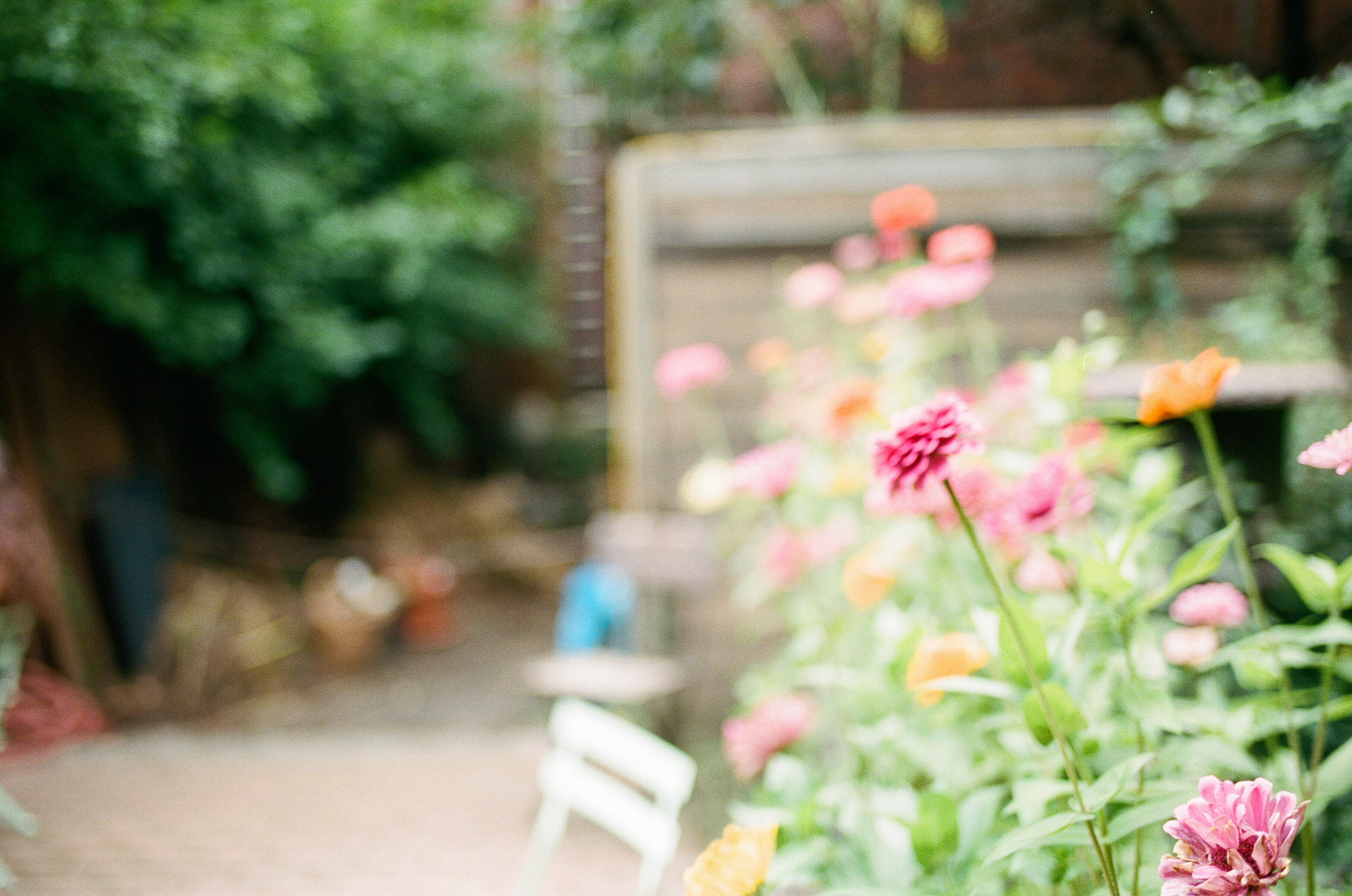

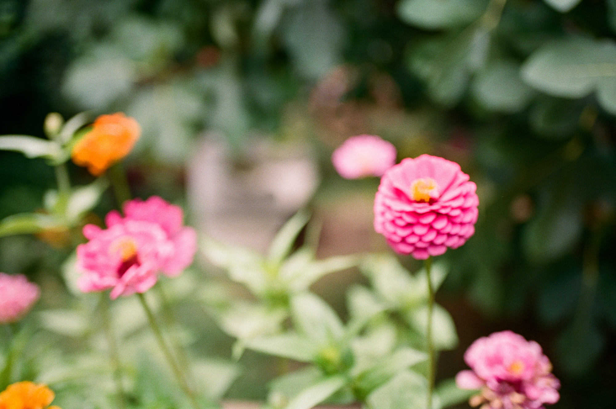

Finally, after a long summer, I got three rolls of film scans back! Such a long wait! So now the real questions begin.
As a refresher, I bought a used Nikon F100. It is in very good condition physically, and I doubt it was used much. For about 90% of my images I used my 35mm 1.8G lens. An awful lot of the images I took with this lens are front focused. Can a film body and lens be mis-calibrated like a digital camera? I'm willing to chalk a few images up to being OOF just due to being unfamiliar with the camera, or perhaps just forgetting to move the focus point and not paying attention. But not this many.....

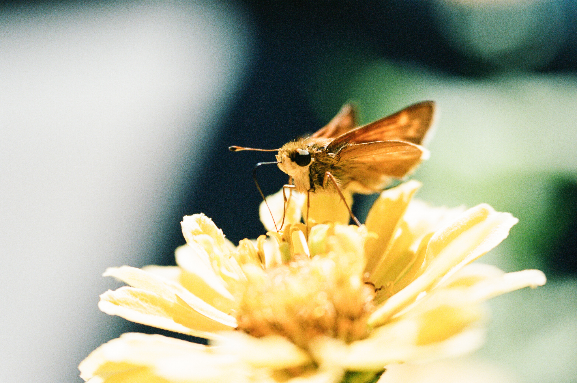

A couple of images I used my Velvet 56 in manual focus and despite my old eyes looking through a tiny viewfinder, those images are bang on sharp. A couple of images I think I used my 105mm macro lens and those are also sharp, so it would seem to be a lens issue. My 35mm lens was always one of my sharpest lenses on my D700/D800 so it's suprising I would have issue with it on a film camera.

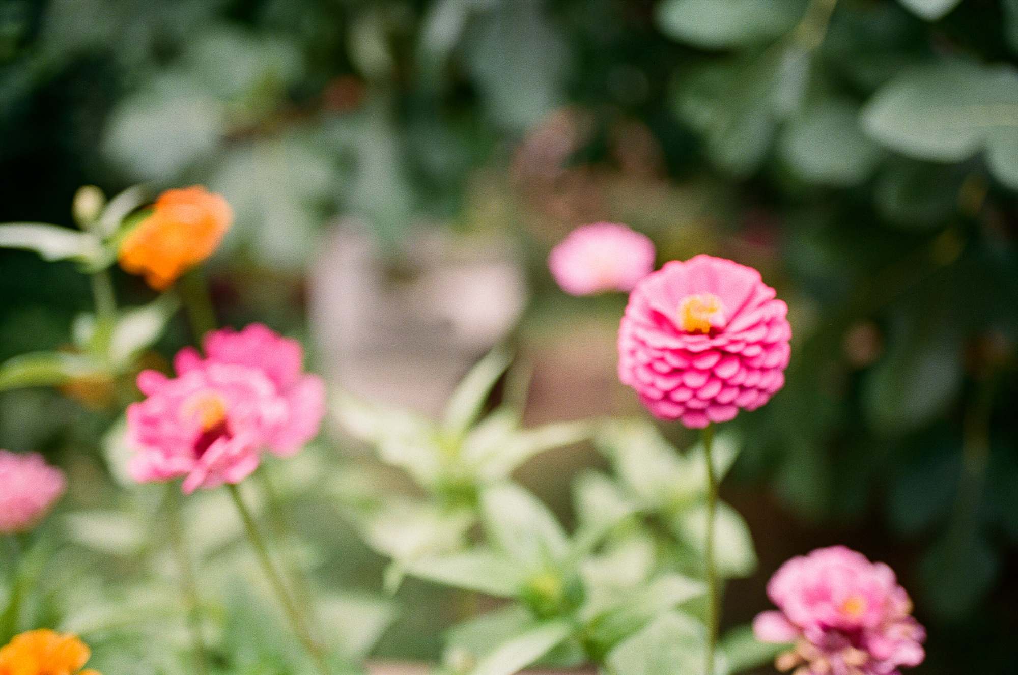

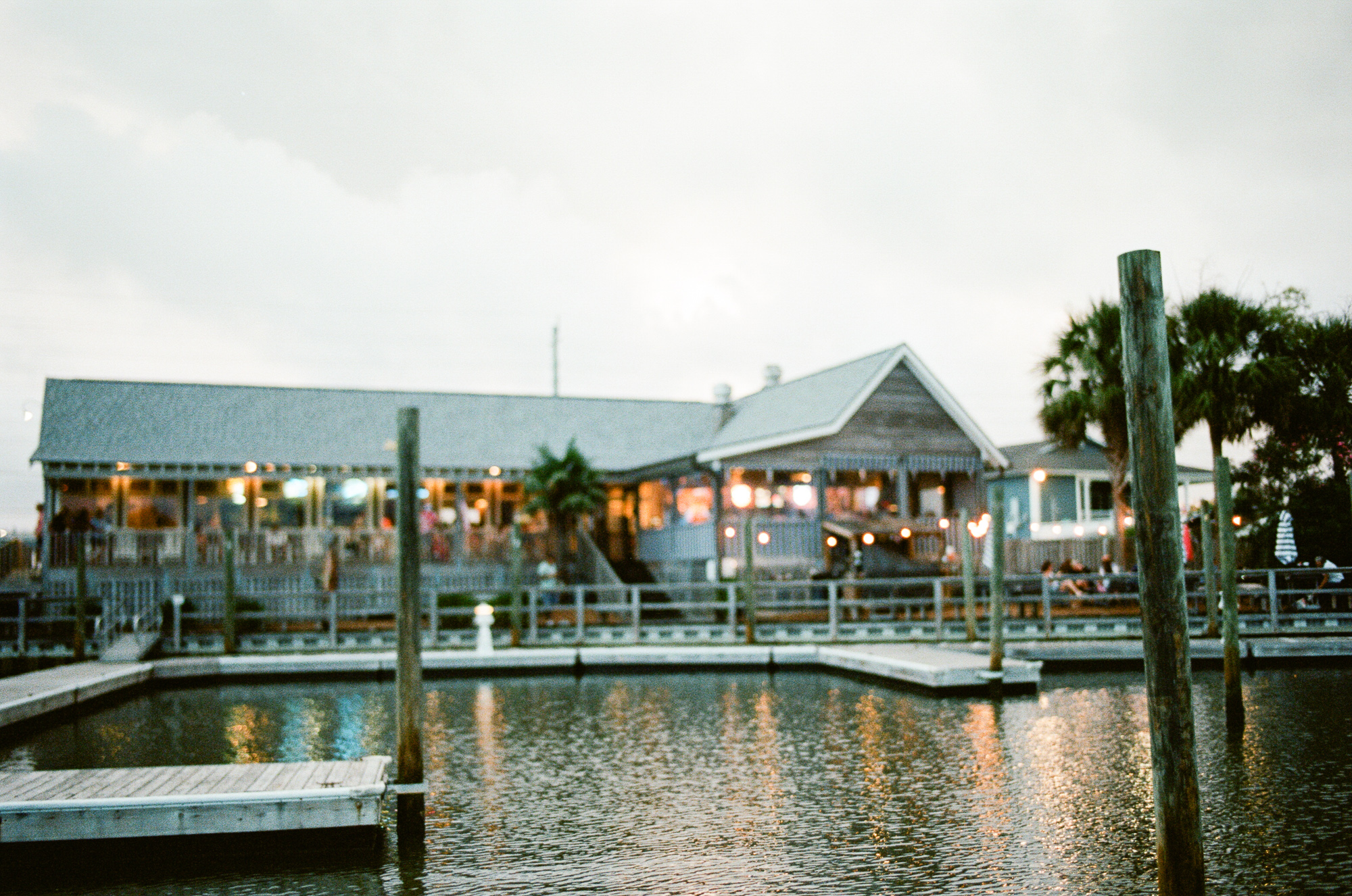

Here are some that are just outrageously soft/out of focus. These are with the 35mm.
This one you can see the very bottom flower is in focus, so obviously that lens somehow front focused.
This should have been a super easy one, but the back wall is OOF and that tiny rear view mirror is in focus (really well!); not the story I was going for.

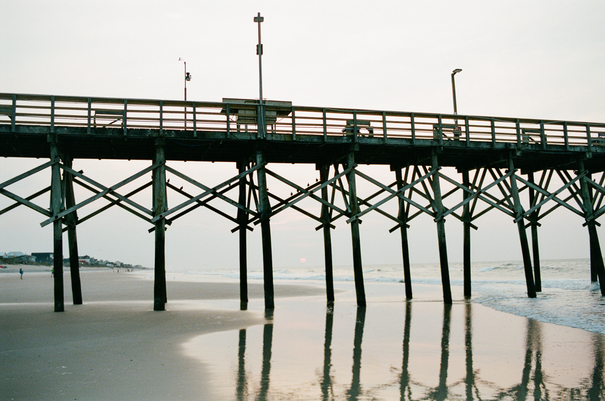

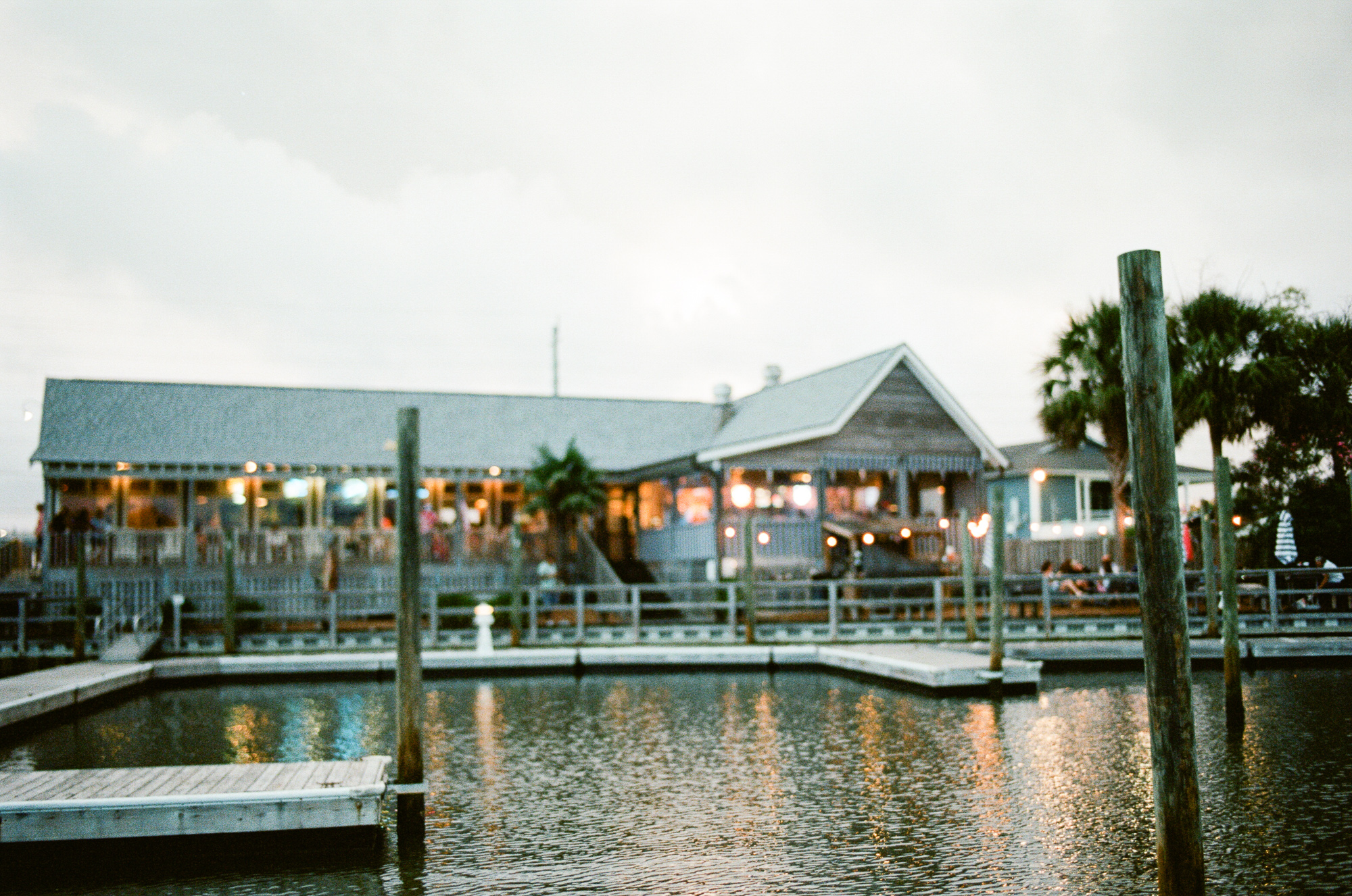

This one was quite low light and pushing the ability of the camera (I took photos on my digital camera at the same time at ISO 1600), but again, the dock at the bottom is in focus.

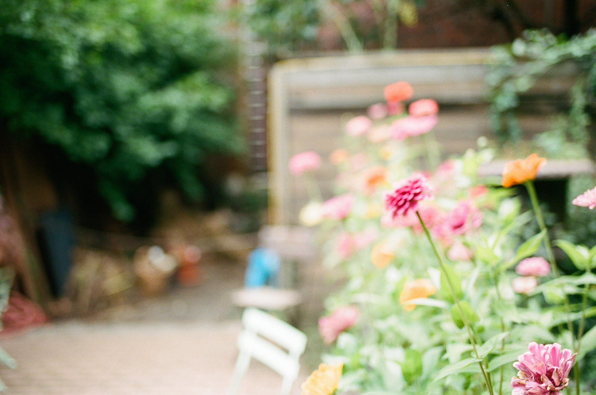

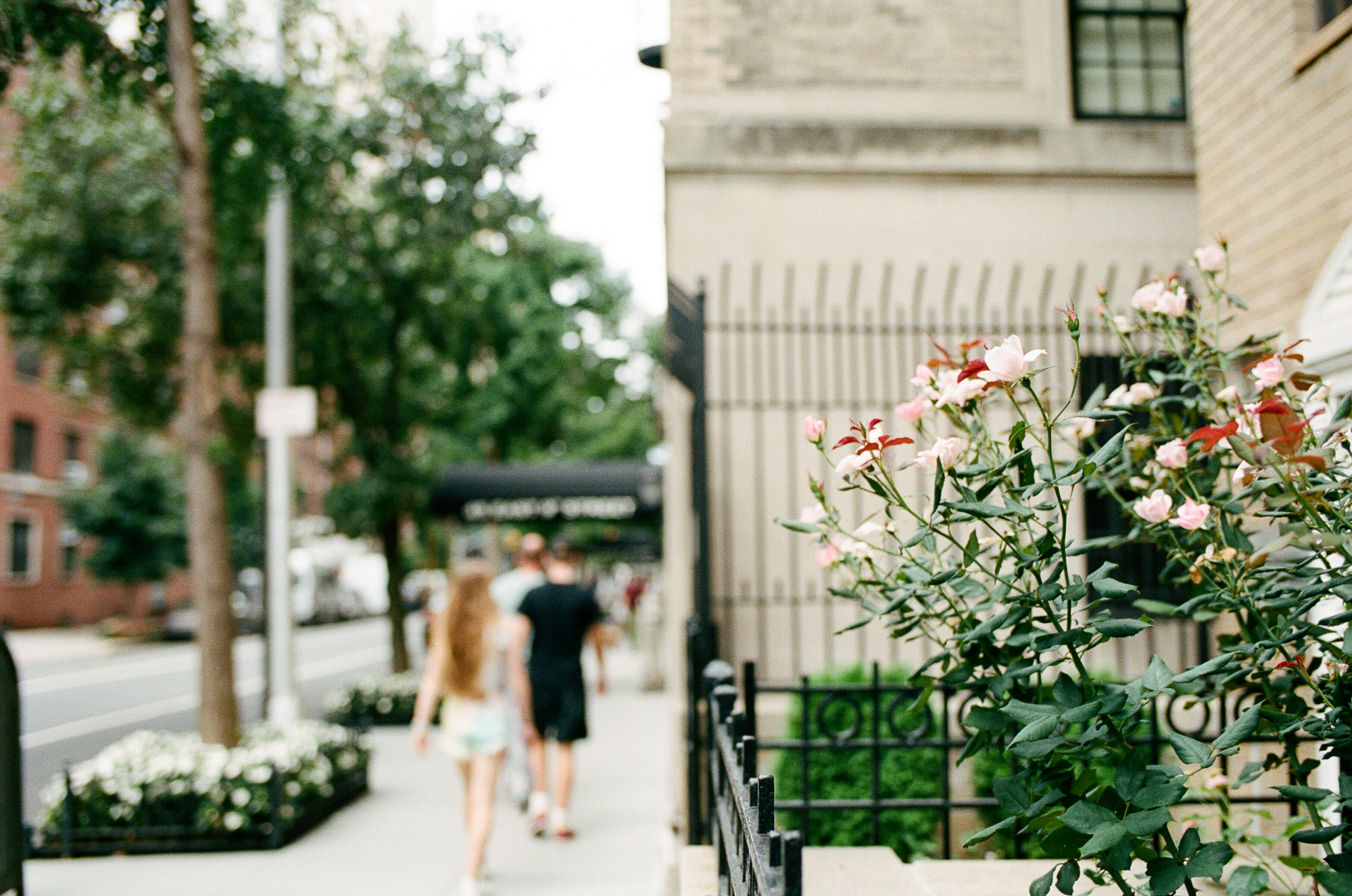

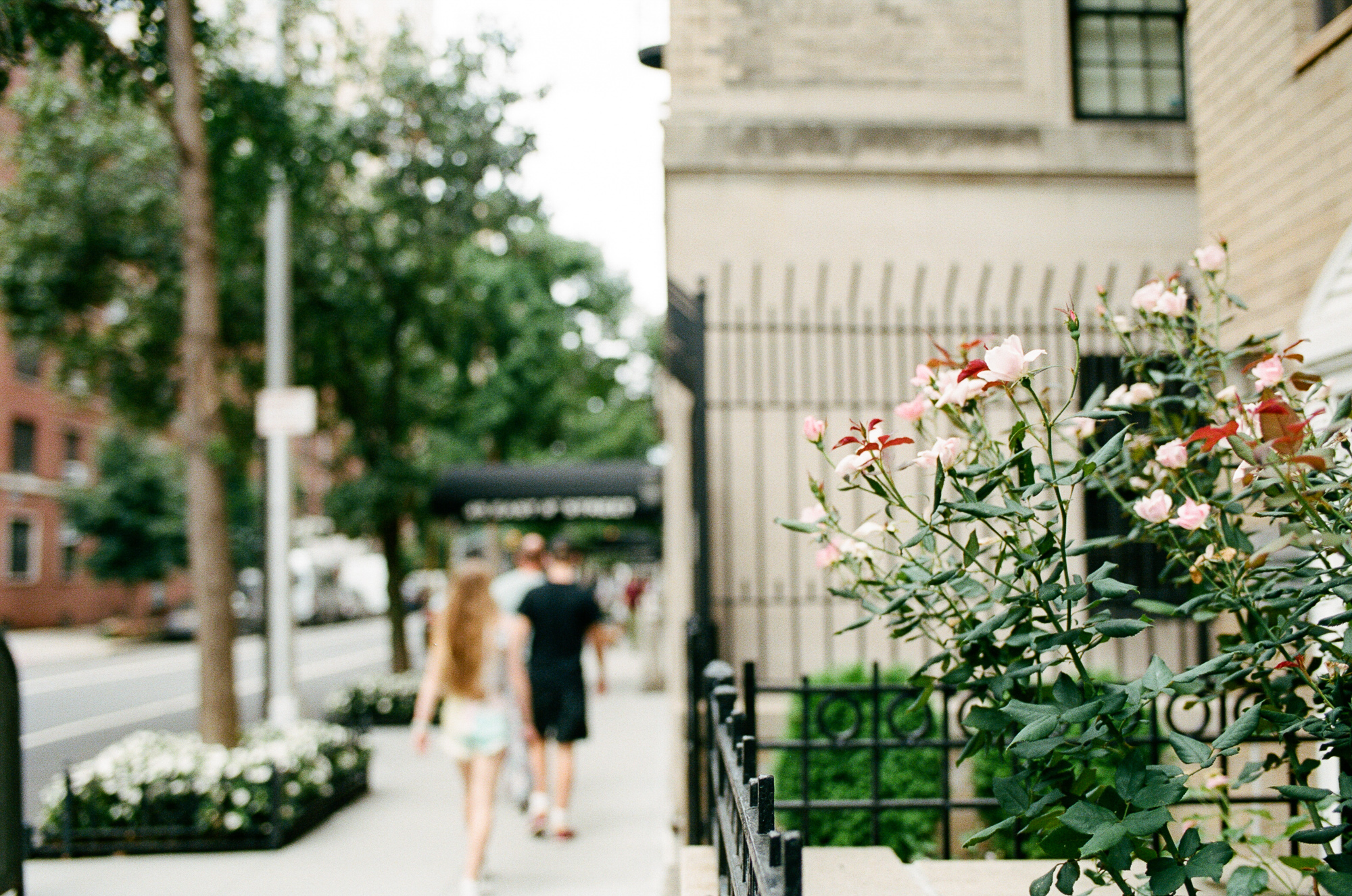

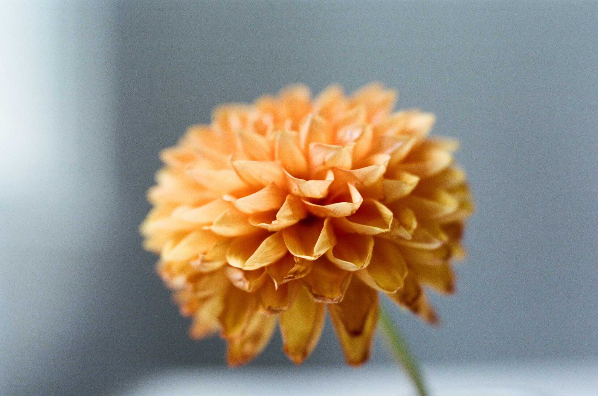

But then I have images like these:
35mm; focus is where I put it.
35mm; focus on the roses where I intended.
Velvet 56 I think, in perfect focus.

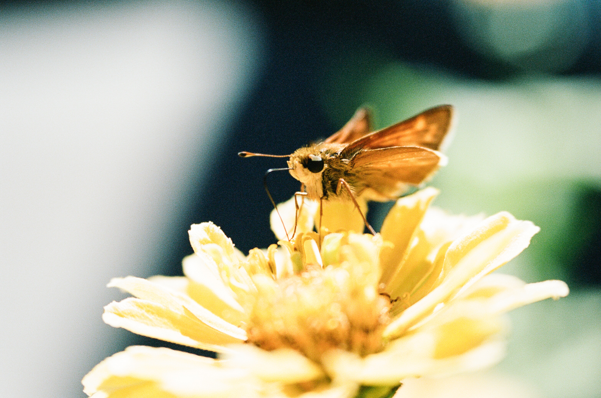

100mm macro lens. overexposed (that's a learning curve for me) but suitably sharp.
Any suggestions??
Any suggestions??
First the good news. Yes, the G lens series is compatible with the F-100, and probably not the lens if the focus problem doesn't exist on other bodies like your D700/D800. At least that rules out a problem with the lens (unlike my Canon FD 135, repaired once, that has a know part that breaks inside the lens, and of course no longer produced, so stays wide open.)
That brings it to the F100 body. Don't know about calibration issue, but probably not even in the vocabulary during that era. Quick search suggest more a menu setting issue. To further troubleshoot, turn off auto focus and see how precise manual focus with the focus aid in the viewfinder. Suspect it will be excellent. On quick research, didn't download a manual but the appear to be available, however, discussions on focus problems centered around menu settings. In addition to the standard focus menu selections, there is the suggestion to disable (set to "0") Custom Function 9 which is Dynamic AutoFocus with the servo motor. Apparently, by default (and system reset) that is set to on. Here is the discussion I found when searching "F100 focusing problem"...https://www.photrio.com/forum/threads/nikon-f100-compose-and-frame-focus-problem.105192/

thank you. this is the same setting that @bunnspecial told me to check/change. I'm not using dynamic AF, but I think that thread you linked has some of the wording wrong. I did some more research last night, and it is Custom Function 9, but the language is "Closest Subject Priority in Single Servo AF" which is what my camera is currently set to (Dynamic is one of the focus tracking options). I found a manual by Thom Hogan that says to disable this setting, so I am going to do so. It's such a dumb setting to assume you'd always want the thing closest to the camera in focus. I suppose for somethings that would be okay, but not if you aren't in a tracking mode.
The only thing that seems weird about that is that the areas that ARE in focus in my images aren't anywhere near an actual focal point. Most are literally at the very closest edge of the frame. However the issue is also intermittent, so I agree that a menu setting is most likely.
I know there were a few instances where I just completely forgot to change the focal point at all, and that's actually probably why that one flower photo is completely OOF. But there were others where I know *specifically* that I took care to set the right FP and that is not where the focus fell. I'm not that bad of a photographer.
I will change setting 9 and do some more experimenting and not use this camera for a "real" shoot like a vacation until I do a full roll of test shots.
Thanks for your help. 🙂
Well, disabled option 9, loaded up another roll and shot it all while on my daily dog walk. I was very deliberate with framing and layering, and making sure to use all the different focal points. I was also careful to note that the focusing screen did not seem to shift as I was shooting or hitting the shutter button. I do know that I missed focus specifically on one or two frames (I was trying to shoot a very tiny spider), and I shot the whole roll with the 35mm at f/1.8. I will send it off today and report back in a week or two when I get scans for it.
I had intended to do something like this with my very first roll, but I didn't want to ruin it or "waste" it on unimportant images. So of course, I ruined most of three rolls instead. 🙁

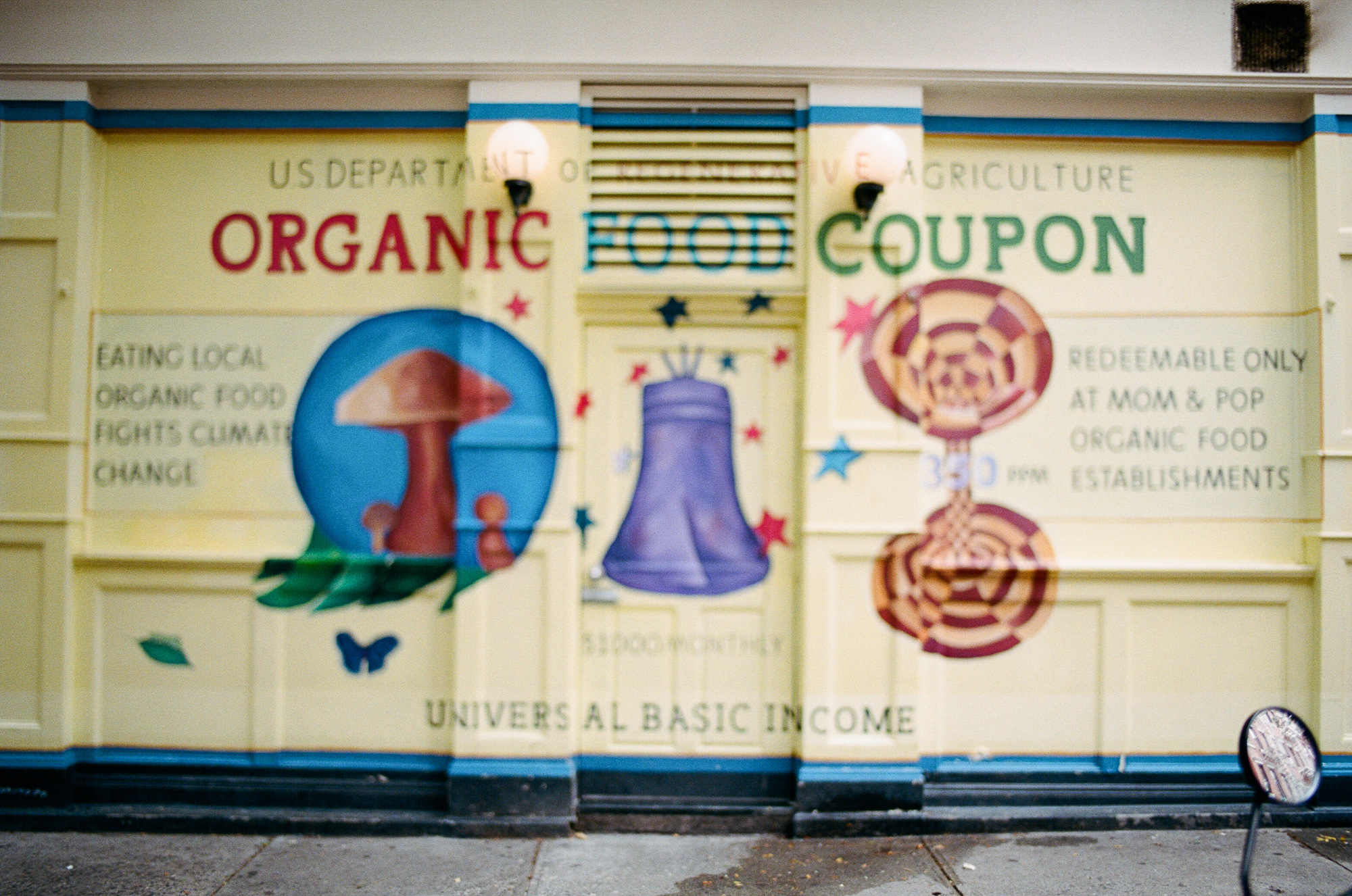

So I just got my scans back from my test roll, and they are equally bad in terms of focus as my other rolls, even shooting slowly and deliberately. I guess my next thing is to try with that lens stopped down a bit and also with a different lens entirely, although it's super unfortunate that the 35mm doesn't seem to be compatible with it.
Otherwise, I don't really know what to do. I might take it in to the store where I bought it and see if they have any suggestions. I think I had a 100 day warranty on it, but I might be just outside that now.
some are completely out of focus, some are missed and some (very few) actually hit properly.
the center point is particularly off.
https://www.nicefilmclub.com/shared-scans/20a9ab5e
here is the roll. the dog images i knew would be OOF because she was moving and she's hard to catch anyway (although actually 13 was supposed to be the dog OOF and the yellow flowers behind her in focus, but the whole thign is crap). but the flowers/landscapes, etc. are NOT hard for me to get in focus, and it all looked in focus through the viewfinder.

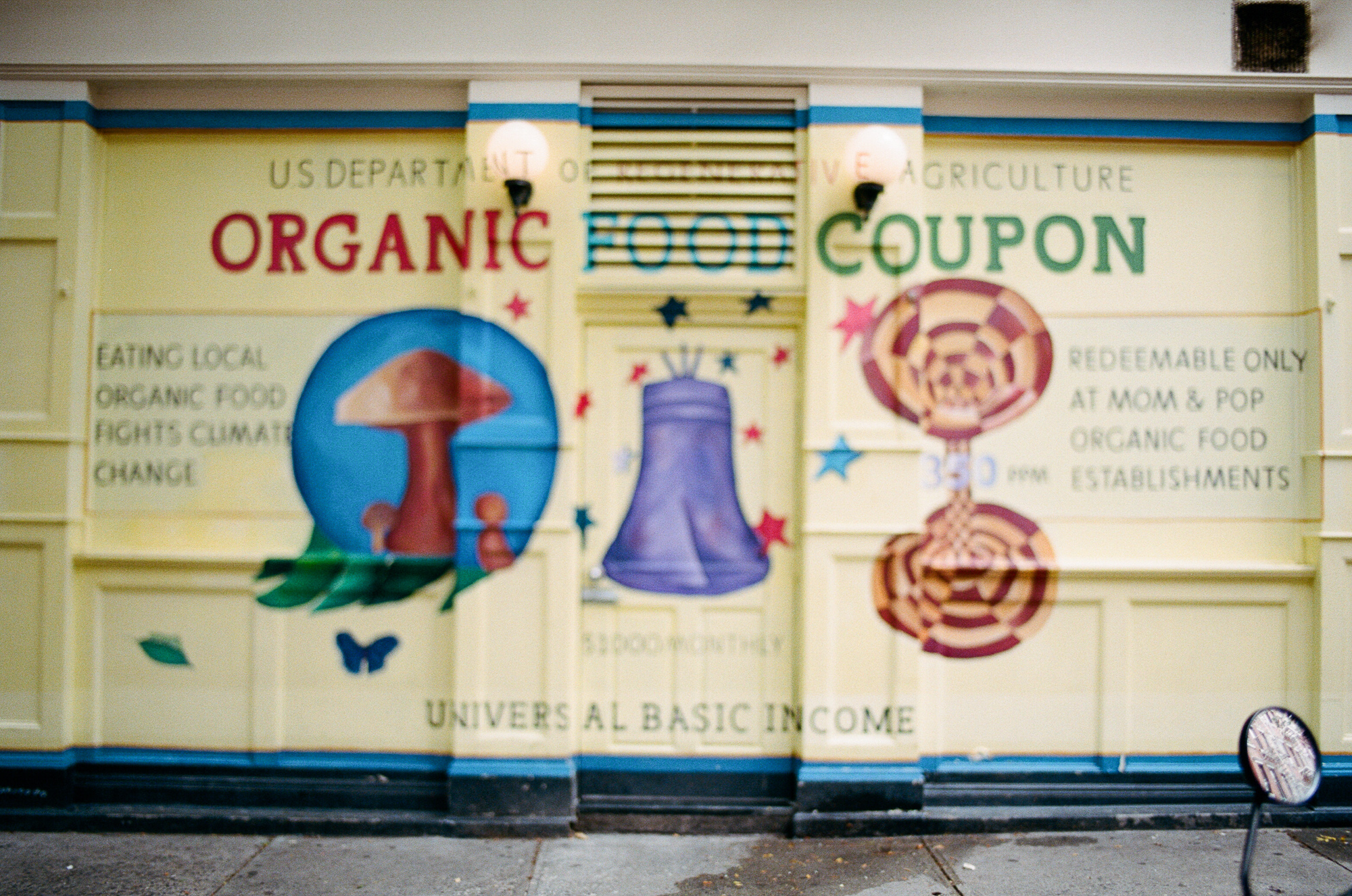

and for instance, the image in the middle with the large sign for Navy Federal Credit Union (image 14 the numbers are in the upper left of each frame)...I had actually focused on the Do Not Enter sign in the background. On 20 I had focused on the little gazebo in the background. 22 & 24 should have been the purple flowers, and 23 should have been the bridge thing in the background.....

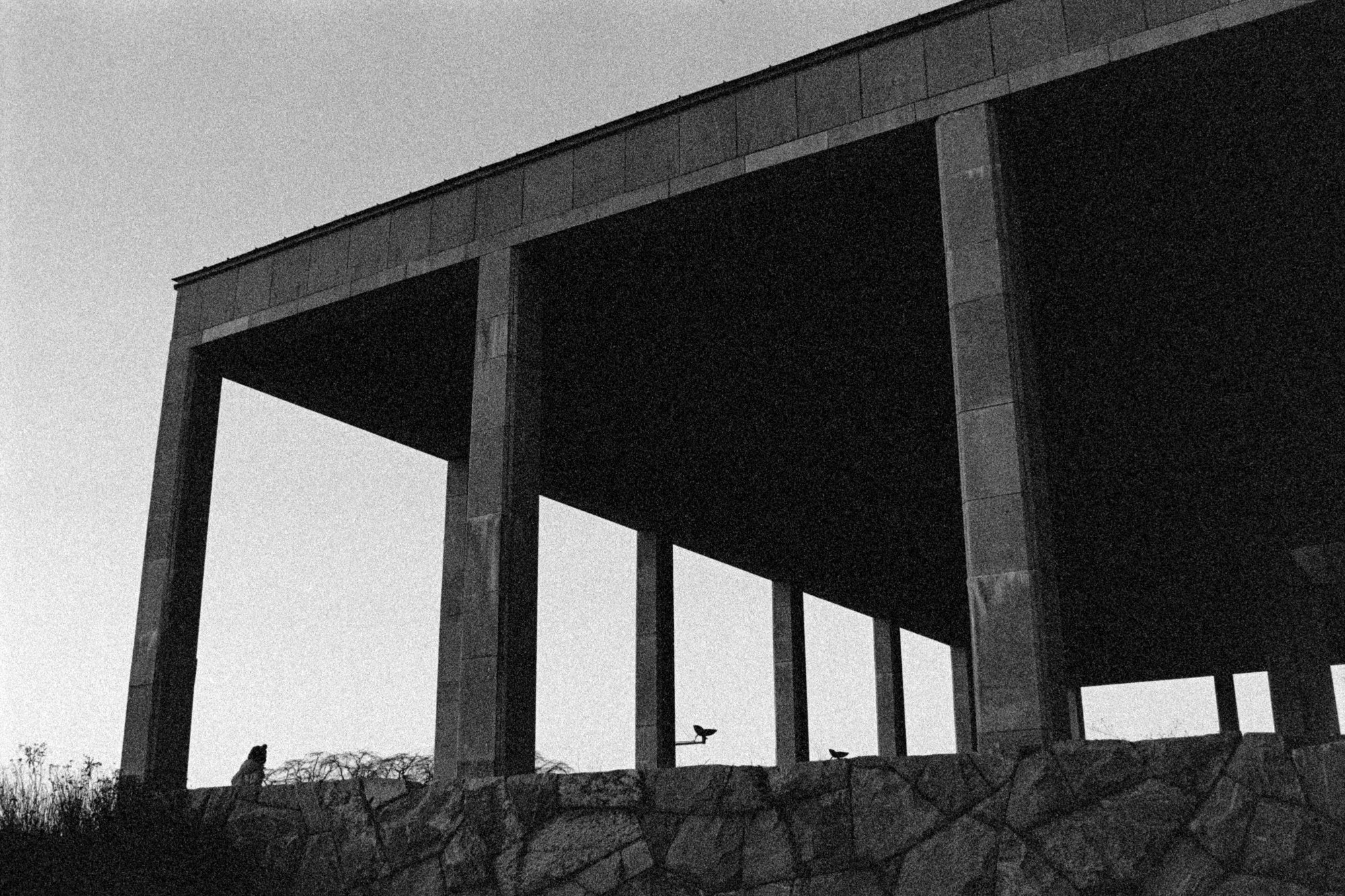

I shot my first ever roll of TMAX 3200 just a few weeks ago. It's very grainy, but not unbearably so if exposed properly. The grain is much more noticeable on a display than on prints.
These were taken with my Nikon F5 and developed using Kodak HC-110 developer. I have more, but they're mostly personal photos of family members.

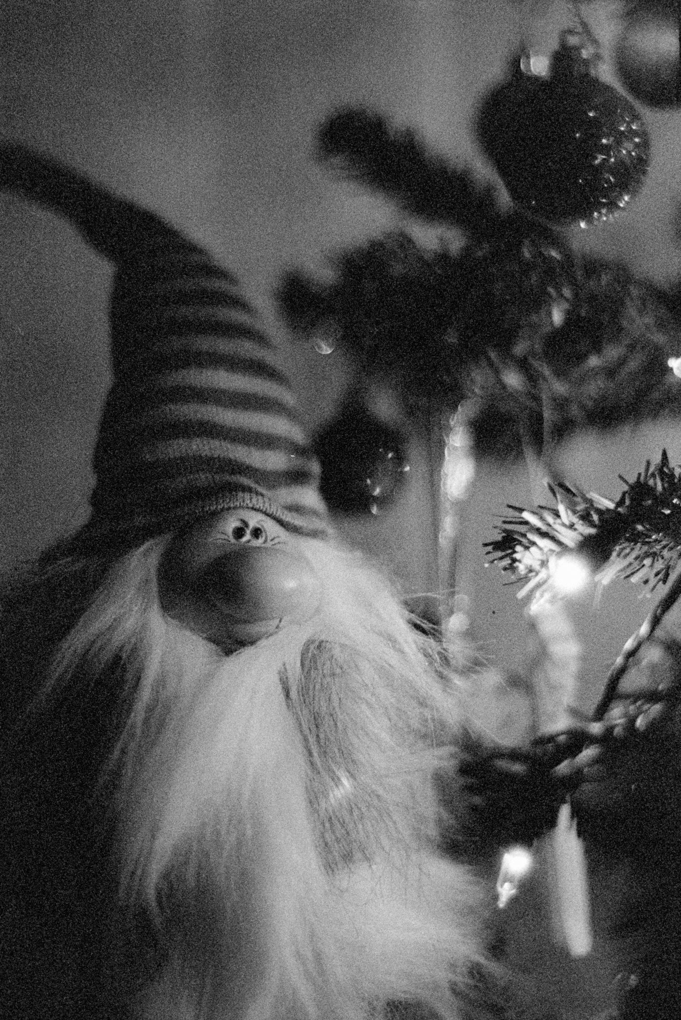

Tri-X looks nice and crunchy when pushed

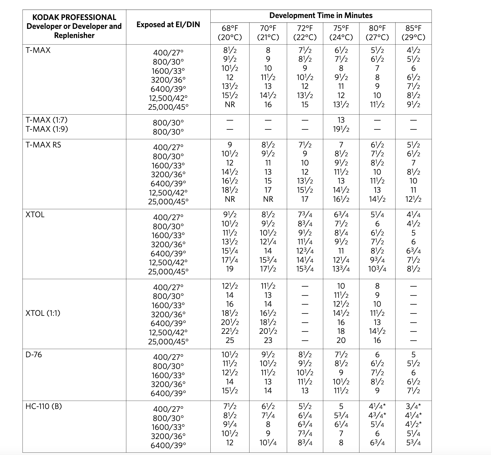

Kodak supplies data for development times when shot at different speeds
(here's the full data sheet https://imaging.kodakalaris.com/sites/default/files/files/products/F4001.pdf )
